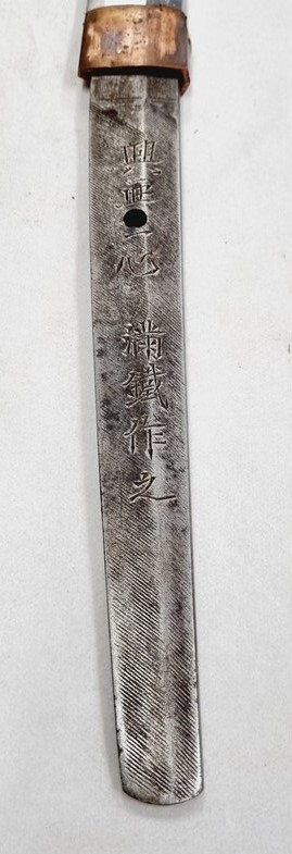

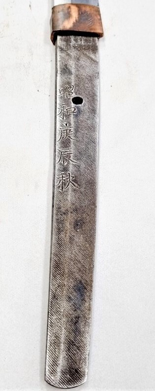

A friend got this one to me.  It's peculiar because it's clearly a Spring 1940, yet the kana SEEMS to be an "O オ", but that kana is only found on 1942 blades.  I've developed enough trust in the reliability of the I Ro Ha numbering system to know that kana isn't found in 1940 blades.  There is a "HO ホ" in 1940, so either this is an incompletely marked HO, or poorly struck (you can see a shadowy stroke that is in place of the missing mark) or an error like we saw on the Mantetsu with the mei kanji out of order:

I think I know what happened.  For the 12th series, Mantetsu substituted the katakana character オ "O" for the katakana character ヲ "WO" .  Both are pronounced as O and in addition the ヲ is rarely used.  See the Wikipedia article about Wo (kana) .  In addition, no ヲ "WO" marked Mantetsu blades have been reported.  There was one blade that was thought to be a ヲ; however, it turned out to be ヌ433 based upon the date of 昭和庚辰春 1940 spring.  The confusion was caused by a poor quality rubbing that can be seen at The presentation sword from Japan to Finland .  I would like to hear what others think about this revision to the timeline.
Revised 1940 Timeline
5th ホ Series: 昭和己卯冬 1939 Winter to 昭和庚辰春 1940 Spring.
6th ヘ Series: None reported so far.
7th Series: 昭和庚辰春 1940 Spring [hiragana と character instead of katakanaト ].
8th チ Series: 昭和庚辰春 1940 Spring.
9th リ Series: 昭和庚辰春 1940 Spring.
10th ヌ Series: 昭和庚辰春 1940 Spring to 昭和庚辰秋 1940 Fall.
11th ル Series: 昭和庚辰秋 1940 Fall.
12th オ Series: 昭和庚辰秋 1940 Fall [Would normally be the 27th character in the iroha poem].
13th ワ Series: 昭和庚辰秋 1940 Fall to 昭和辛巳春 1941 Spring.
Edited by Kiipu
  • Thanks 2
Well this is an interesting turn of events, indeed!  They were definitely doing something in 1940 with the kana choices.  As long as the 2 are pronounced the same, as you say, then I think it explains it completely.  I looked to see where I logged that "オ 111", but I don't have it in the files.  I think I got distracted by the copy of Morita-sans chart in that Chinese book.
Currently, the chart looks like this:
How do you think I should correct that line?  The Iroha series calls for a ヲ "WO".  If I change it to  オ "O", it could get confusing.  I COULD change it to オ "O" with a Footnote, explaining the substitution.  I don't know.  Tell me your thoughts on it.

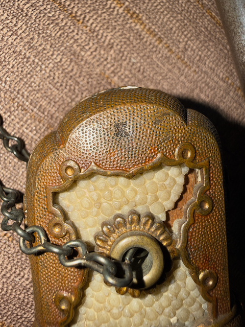

Yes, a few now. There's one in Fuller & Gregory's book. They all seem to be custom designed, rather than any formal pattern.
John
Can you point out which page?
Thanks
It is on page 70 of the larger one, it isn't the example I was thinking of though. Definitely recall seeing a similar one to the above in a thread here, or a sale listing.
Thanks John。That is 若濑 Wakasei mount。
