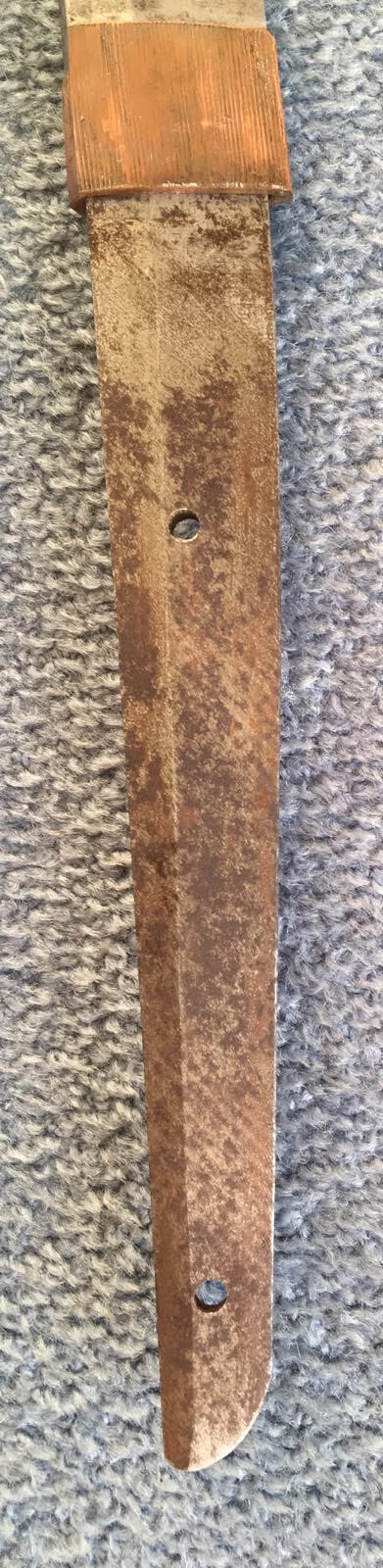

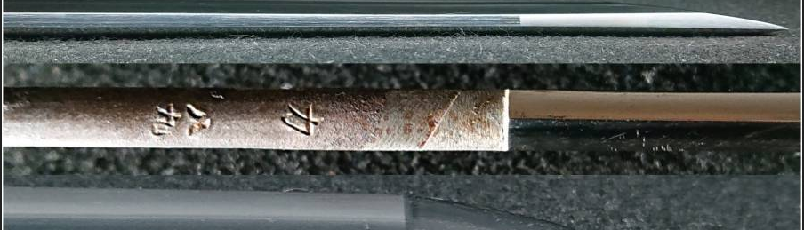

On 8/7/2021 at 6:46 PM, KuraiValo said:
if you need any other/better pictures to help, please let me know.
Can you post a picture of the entire tang, either side, from top to bottom?  This is just to verify the number of mekugi-ana (tang holes).

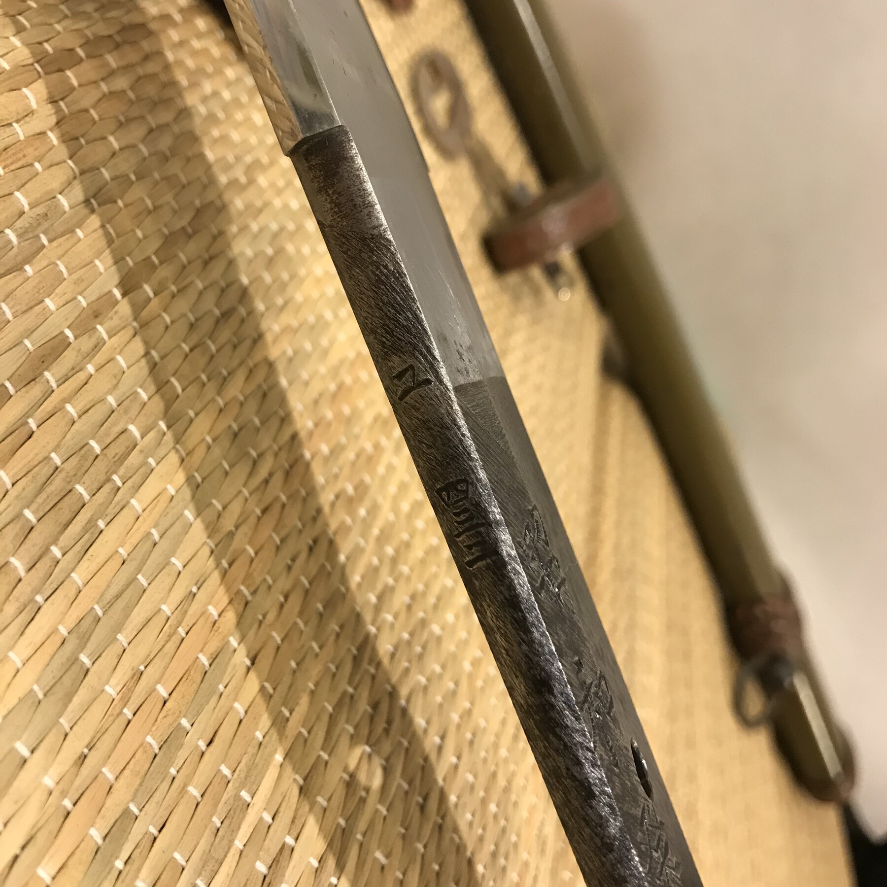

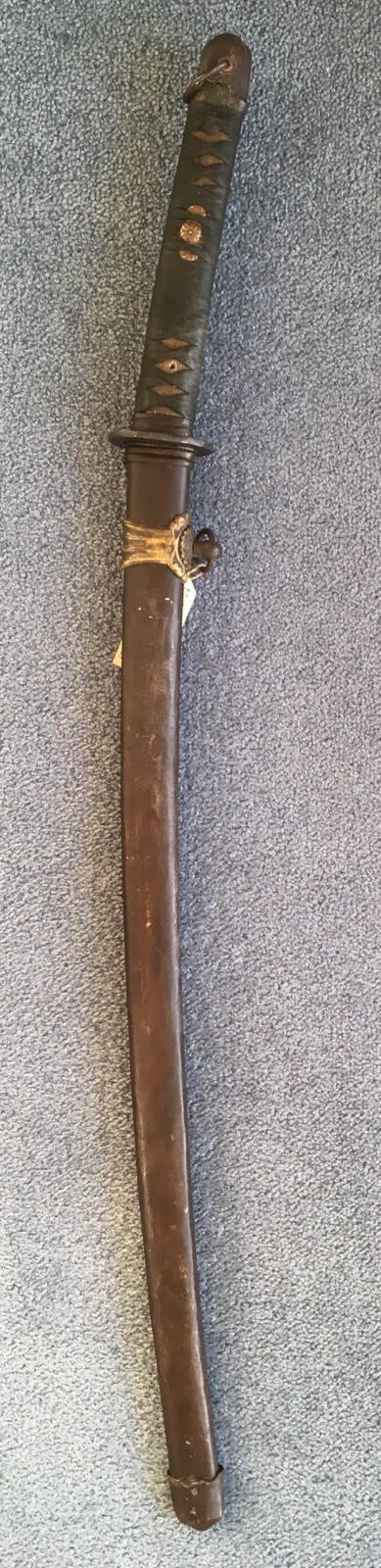

Hi Bruce, looking at my 1945 mumei MANTETSU, with mune stamp 1170, in MRS mounts, the seppa are also stamped also 1170.
Although stained (no rust, no pits), the HAMON is still visible.
So it is an interesting animal, being mumei with correct file marks, a very late mune stamp, matching stamp on seppa, hamon and MRS mounts.
Bruce, from the mune stamp, do you think it is one of the very last made? Given they probably had no time to cut a mei?
Neil,
I can say positively that this is the latest Mantetsu we know of.   They were dating blades on a fiscal year starting in April 15th each year.  So, the '45s existed in April 15-August 15, four months.  If the '43/'44 production rate of 500 blades per month was maintained in '45, they they could have made 2,000 blades, putting this one right in the middle (end of June '45).  But we don't really know.

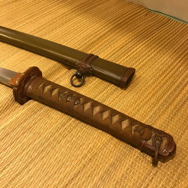

24 minutes ago, Stephen said:
how do we know this is Mantetsu?
Stephen,

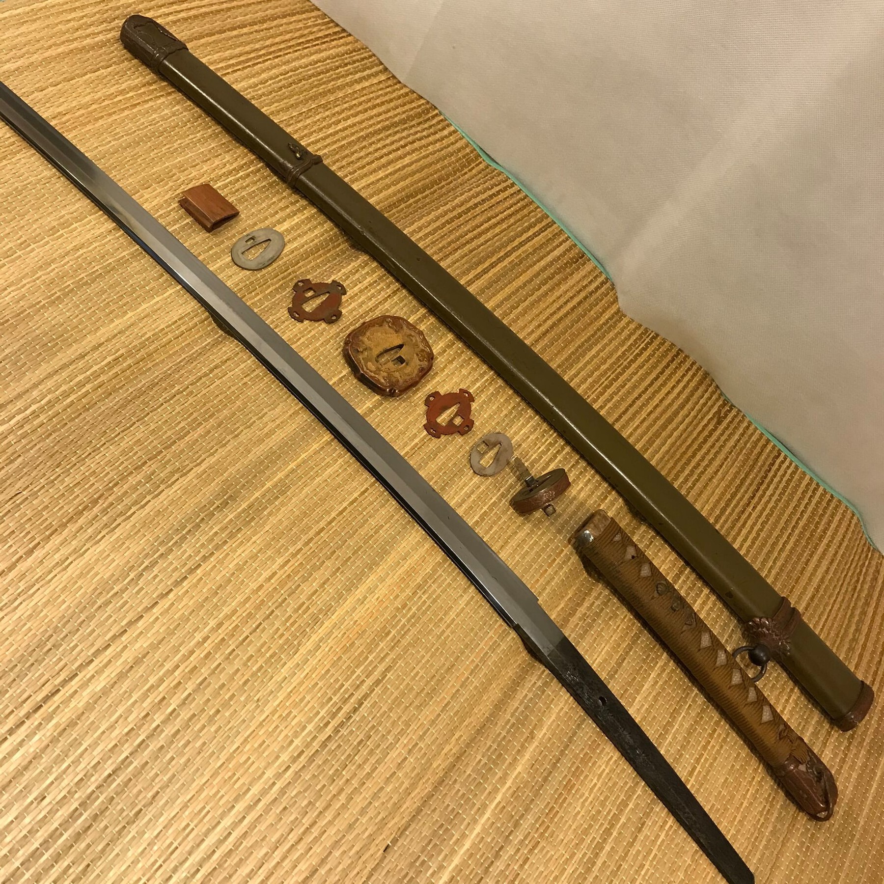

It's a number of clues.  The fittings are found on a few known gunto and all of them have Mantetsu blades in them.  We think the fittings might have been made by SMR.  Also, the blade itself, and nakago, match Mantetsu work.  Finally, the serial number on the mune is "い 1170".  The katakana "い" is the one Mantetsu used in 1945.

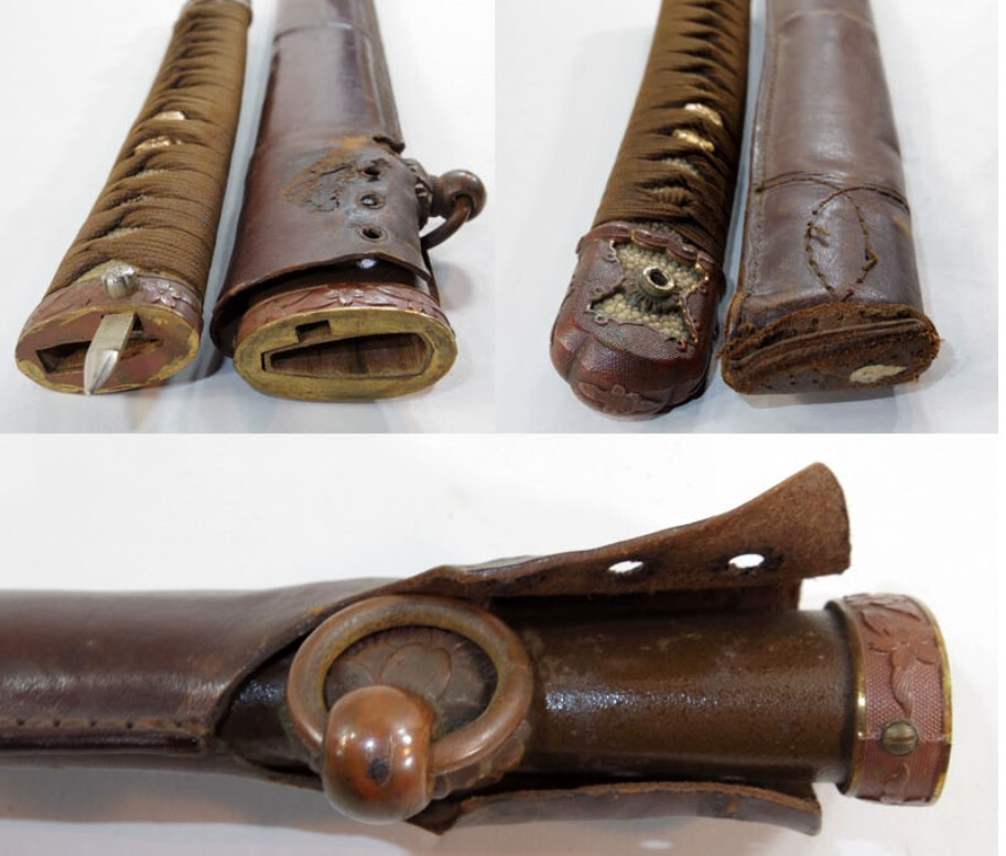

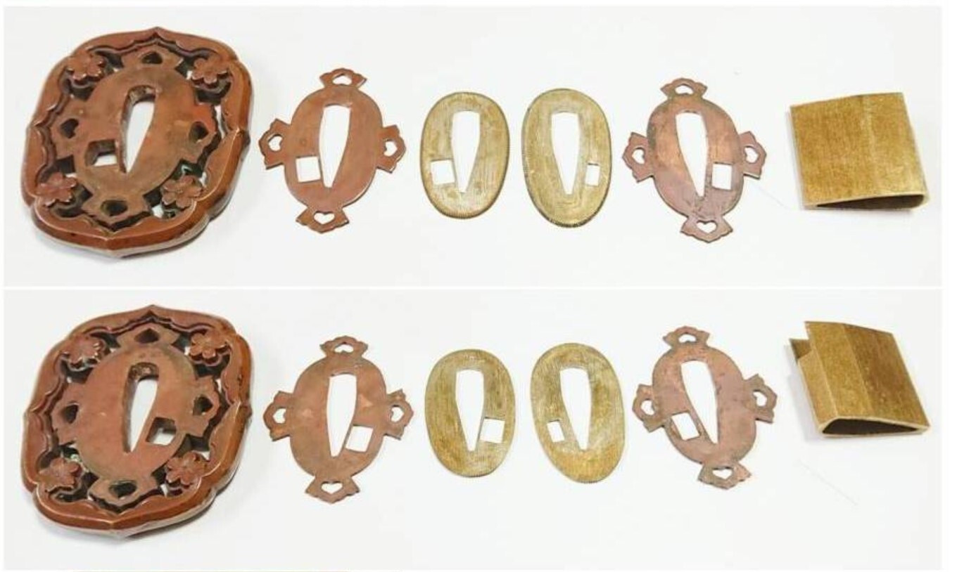

7 hours ago, PNSSHOGUN said:
what is unusual is there is a Mon
Thanks John.  A little too unusual, me thinks!  Turns out I already had KA 89, and it appears to have been recently re-fitted.  Amazingly good job, whoever did it.  It was sold on the same site too, as they used that long string of photos that are all one when you download the image.  Here's the original.  You can see there's no mon.  The chuso is different, and the belt rings are different.
Also, the original fitters had used the "89" as fittings numbers, which are gone on this re-fit:
