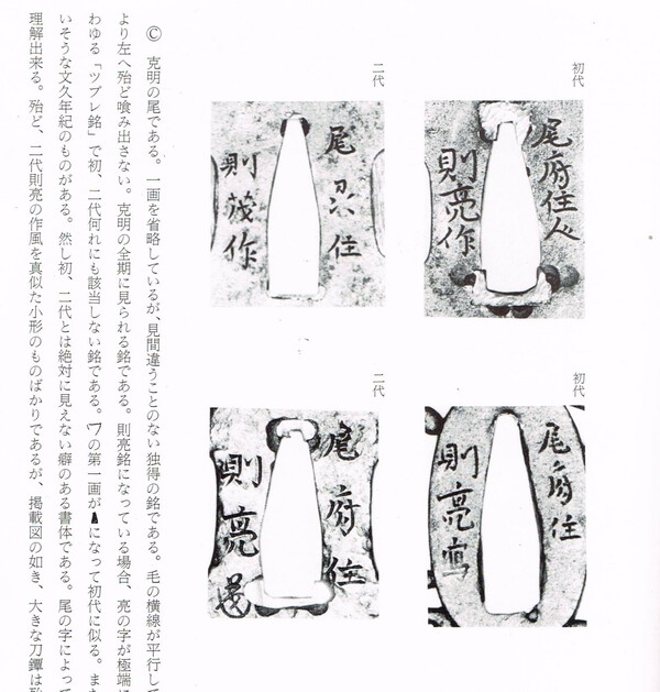

Curran Posted April 12, 2018 Report Posted April 12, 2018 Boy, that is a classic little Norisuke there. I could show you several like that from the books. That is a nice find. See attached reference for shodai and nidai signatures. Also, here is one of the Norisuke books for sale [Nagoya NBTHK, good- but I prefer the Owari Tosando's 90 page section on Norisuke]. https://page.auctions.yahoo.co.jp/jp/auction/j482108427 Scroll through images for some examples with similarities. 1 Quote

Ford Hallam Posted April 12, 2018 Report Posted April 12, 2018 I'm afraid it doesn't convince me at all. The texture in the mei is a give-away as is the texture at the bottom of the nakago kuchi-beni. That and the overall quality of the steel scream cast copy to me. 5 Quote

christianmalterre Posted April 12, 2018 Report Posted April 12, 2018 i am definitely seconding Ford´s points here... there is no sign of a forge or punched/ciseled work here on these pictures you did post Steven.... do compare the bw pictures Curran did post you, and you will immediately see the difference. ( especially as it shall be the same generation here! ) again, a typical cast and fake one to blind the novices eyes.... well..... Christian 2 Quote

Dr Fox Posted April 15, 2018 Report Posted April 15, 2018 Hmmm! I find it just a little odd, that the chisel would leave a 'dappled' effect, at the end of its strike. Would expect a clean regular finish at this point. Also the 'veins' in the leaves, appear to have a loss of detail on all the high points. 1 Quote
Ford Hallam Posted April 15, 2018 Report Posted April 15, 2018 Hmmm! I find it just a little odd, that the chisel would leave a 'dappled' effect, at the end of its strike. Would expect a clean regular finish at this point. Precisely. 1 Quote
John A Stuart Posted April 15, 2018 Report Posted April 15, 2018 Even the kuchibeni has this 'dappling'. Is it not signs of bead blasting? John Quote

Michael 101 Posted May 6, 2018 Report Posted May 6, 2018 Richard - so where do we order these then ? Steven, its an easy mistake to make just from pictures if you have not handled many Norisuke tsuba. I have often seen surface texture the very same as yours on their tsuba, Infact if you look on Tetsugendo facebook page there is a Norisuke pictured with the very same texture - and those guys as professional dealers no their stuff. Just seems to have been a peculiarity of their iron. In an ironic way I think both Norisukes ( father and son ) would be rather pleased if it were a copy as that is mainly how they made their living and probably see it as a complement. Kindest regards Michael 1 Quote

Dr Fox Posted May 7, 2018 Report Posted May 7, 2018 Not being a tsuba collector, but having a basic understanding of how they are made, used,and why. I have followed this post, and now as a novice need some clarity and answers. The nakago ana is the focus of my attention. If this is an original tsuba, then it is suggested that at some time it has been fitted to a blade. To allow this fit, the standard signs of alteration to its size is present. The seat of the kuchi-beni to accomodate the nakago mune is very much smaller than the original ana, this immediately indicates this tsuba was way to large for the intended blade. Yes it has been done, but then its not unusual for the kuchi-beni to have ‘wings’ passing around the blade, to resist the twisting motion at this point. Moving now to the ha area of the nakago ana, this tsuba shows the usual punch method of spreading metal to tighten the blade grip at this point. But this is where I lose the plot. The method shows at least 4 strokes of the punch each side, each one progressively spreading the metal. Yet the surface texture is faithfully carried down to the very last punch strike, how did he do that?. 2 Quote
Ford Hallam Posted May 8, 2018 Report Posted May 8, 2018 at least 4 strokes of the punch each side, each one progressively spreading the metal. Yet the surface texture is faithfully carried down to the very last punch strike, how did he do that?. Succinctly put. And once Occam's razor is applied the truth becomes very clear. 4 Quote
