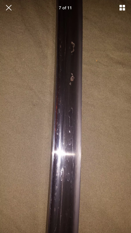

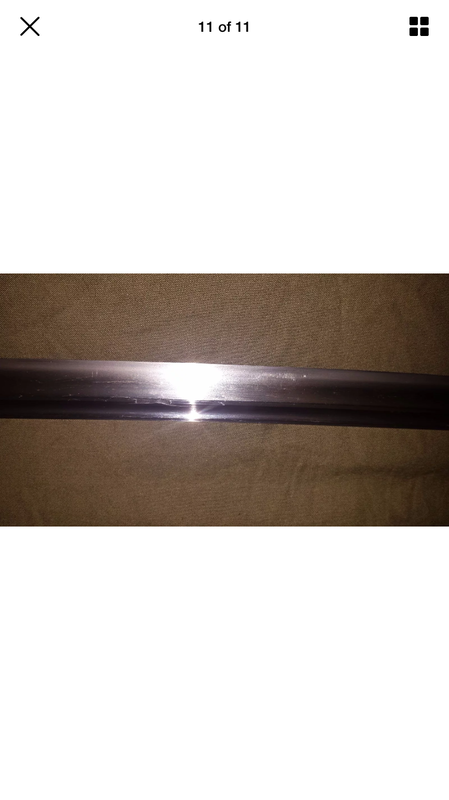

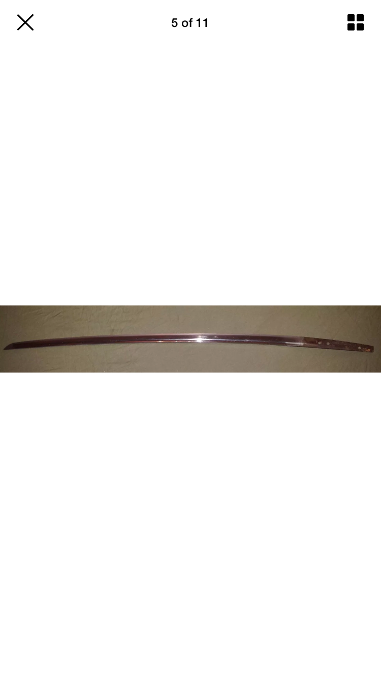

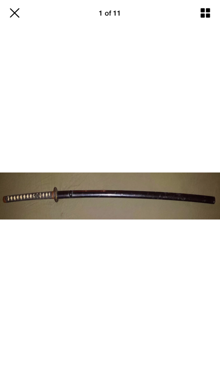

Recently purchase this Koto katana for the right price. Knowing full well this is hardly an art sword by any means. Still, I’d like to hear some inputs on this blade . I am particularly interested as to what school this long (28.5) katana belonged to and what period it was forged in.
Thanks for all your Inputs in advance

Well, while fukure are not considered a fatal flaw those fukure in your sword come next to fatal. They are prettay bad. I can not comment on the Boshi. I can not see it in your images but that may be just due to the image. You would however want to check on wheter it is still there. If you can not see it you should run a copper coin gently along the cutting edge and kissaki and thus see of there is still temper left.
Aside from the fukure the blade shows signs of tieredness and I think I can see Shintetsu in the blade.
The blade has little sori. Overall my first impression was that it could be a Kanbun Shinto piece. However it could be also a mass produced late Muromachi periode piece. This would corelate with the poor forging quality and tieredness due to repated polishing.
Your question regarding school is legitimate of course. However it does not really matter as no matter what school it is or even if it was made by a famous maker (which it 99.9% possibiliy not) as it unfortunately just remains a bottom sword.
Please don't get me wrong. I do not wish to put down your sword. In the end it is all a matter of price and no matter what condition a sword is, there is almost always some sort of value to it which grealy lies in the buyers / owners eyes.
Would I recommend to buy this sword? That's a tough question as it is again a personal decision. Would I buy it? No because there are just better things out there and this sword is a bottom piece. If I were you I would study it for what it is and either keep it or better pass it on.
I once had bought a Bizen Koto sword. 33'' Nagasa, Ubu, Signed. That's the good part ... the bad one was it had a fukure similar like on your sword. After I cleaned away the rust I found 3 Hagire. It was just a mass produced Osafune piece of inferior quality. I made it go away for what it was. Sometimes we need to let things go.

I can't give you any info on school or smith because vital details are lacking .. however from what I can see I would lean on Koto and possibly Mino. The color of the steel is much darker than one would expect in a shinto blade. Fukure are never nice.. :( The Boshi needs close examination and I would check for hagire. The koshirae look decent. Will be hard to resell because of flaws etc.. but if you plan on keeping it, I could understand its appreciation as a nice piece of history. Hope it was on the lower end of $1000.. Cool pick up all things aside!

I agree on possibly Muromachi, Tim, but don't see Mino. You're unlikely to find hagire with fukure at those locations, which I guess is good news. I also wouldn't have bought this blade. Your "under $1000" would have gone a long way towards a blade in better condition. I suggest spending more on books - & more study time - until you have a better grasp of what makes a collectible sword. I also suggest staying away from acid etching of any sort. - too easy to make a bad blade even worse.

As for the blade, i think all that can be said has been... I would have passed as well.... BUT .. that being said.. let's have a look at the tsuba, menuki, and fuchi/kashira... Could be something there?
I really have to emphasise here Ken's comment - NO ACID OF ANY SORT.  It goes deeper than you can imagine and changes the character of the steel to such an extent it can render the blade unsuitable for a polish.  Also, embrittlement of the metal can occur depending on the acid.  I'm sure far more knowledgeable people will (hopefully) chip in here.
