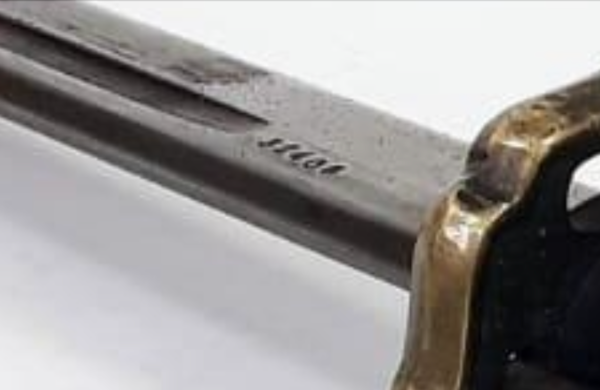

John C Posted July 28, 2023 Report Posted July 28, 2023 To me, it looks real but highly refurbished. The tsuka looks legit; the menuki look correct; the bohi looks correct; the serial number (the 3 in particular) looks correct. But the whole thing looks repainted, polished, and possible parts replaced. John C. 2 Quote

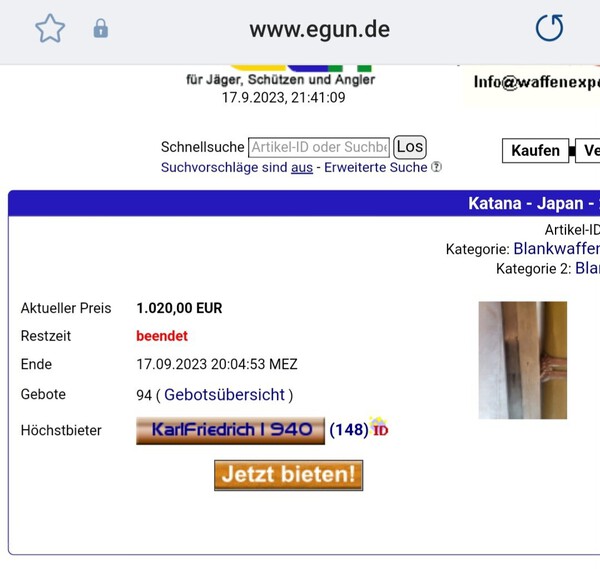

vajo Posted September 17, 2023 Report Posted September 17, 2023 The chinese Fake sword was now sold for 1020 EUR 1 Quote

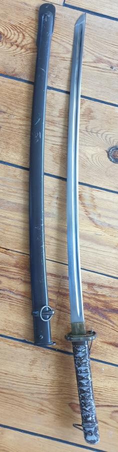

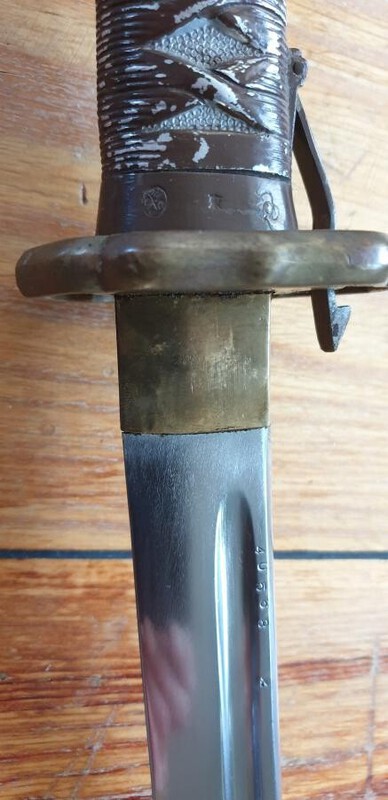

Lexvdjagt Posted September 28, 2023 Report Posted September 28, 2023 Is this real or fake? I am personally a bit confused by the paint. Quote
Kiipu Posted September 28, 2023 Report Posted September 28, 2023 Sorry Lex, it is a reproduction. Quote
Lexvdjagt Posted September 28, 2023 Report Posted September 28, 2023 @Kiipu what brings you to that conclusion? Quote
John C Posted September 28, 2023 Report Posted September 28, 2023 1 hour ago, Lexvdjagt said: what brings you to that conclusion Lex: I'll chime in here. Just from those pics, the obvious signs are: 1) the bo-hi is tapered at the end (like using a grinder) rather than cut straight down. 2) The bend of scabbard latch is exaggerated (real ones are straighter). 3) The sarute is too long, which is typical on fakes Hope this helps, John C. 2 1 Quote

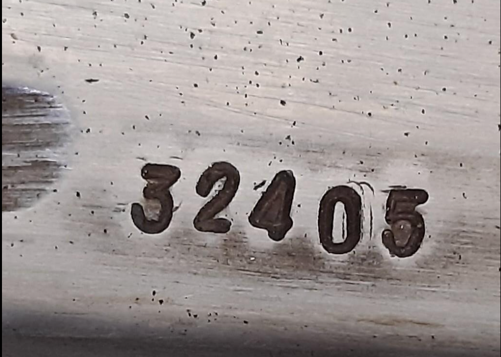

Bruce Pennington Posted September 29, 2023 Report Posted September 29, 2023 Agreed. This maker/faker likes the 30,000 numbers for some reason. When I see one of those numbers, I automatically start looking for other clues. Pictures of the stamps would help confirm. I bet it's an Ijima. 1 Quote

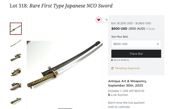

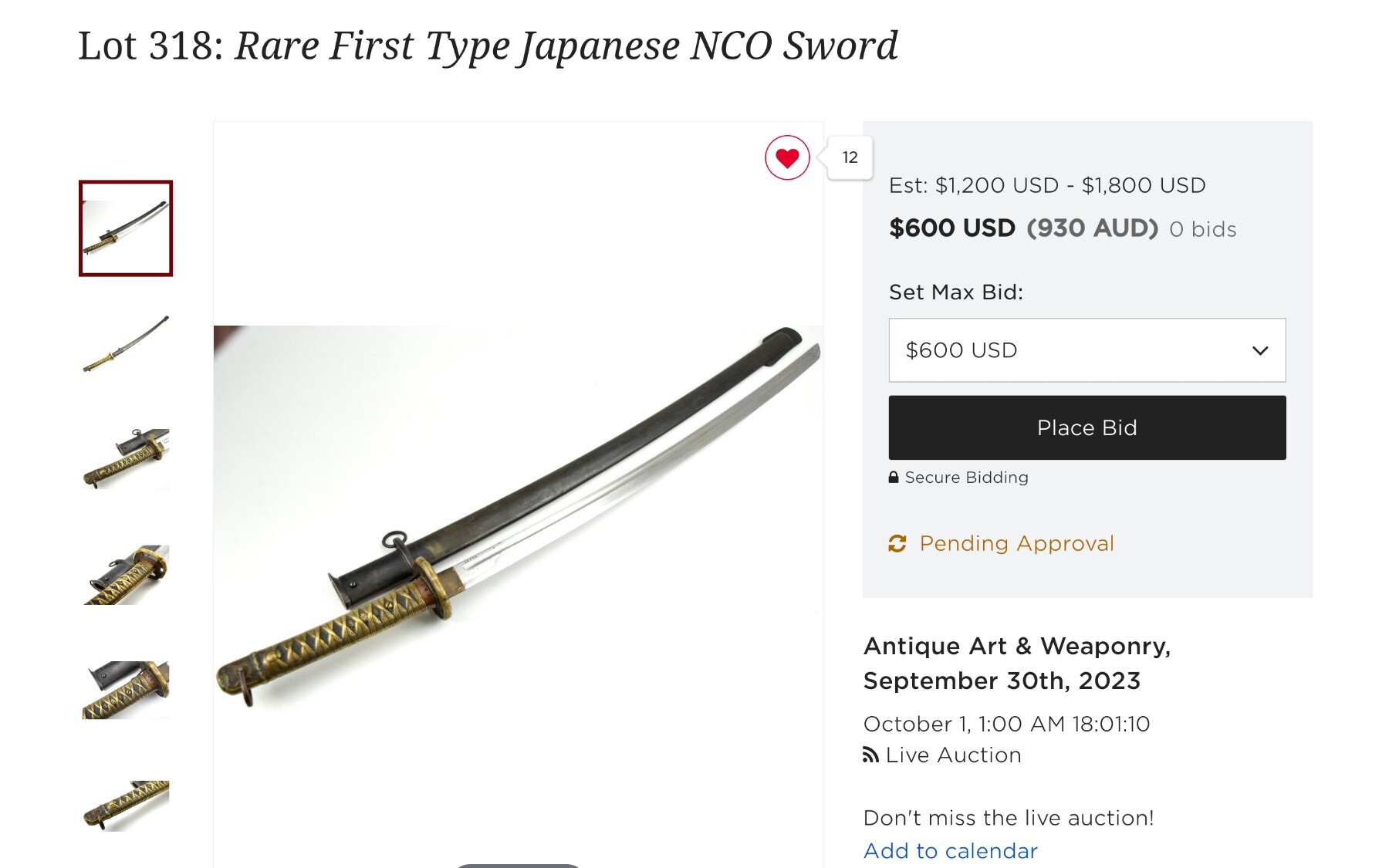

robinalexander Posted September 30, 2023 Report Posted September 30, 2023 Same old, same old....I can't help myself. So I took the time to explain to this auction house that this was not a rare copper but a Chinese repro (and a bad one) and suggested they could refer it to a specialist.... after their first response which was .... Hello Rob, We have consulted several specialist in the field and they all confirmed the sword was authentic. Best regards I then told them that 'coppers' blade numbers finished in the mid 6000's but, no response....it's off to the auction it seems I really need to learn to just 'let it go' 1 1 Quote
Bruce Pennington Posted September 30, 2023 Report Posted September 30, 2023 Yeah, I've gotten to where I almost never even look anymore. Even the ebay sellers, if they answer at all, don't want to know the truth. It would require they sell it as a repro at drastically reduced price. 1 Quote
John C Posted September 30, 2023 Report Posted September 30, 2023 7 hours ago, Bruce Pennington said: Even the ebay sellers, if they answer at all, don't want to know the truth. Been there. The guy who sold me the souvenir swore it was just a late war kai gunto using left over parts. I knew what I was buying so it didn't matter - this time. But what if someone didn't know. Everyday there are standard soldier's tanto being sold as "kamikaze suicide" knives when the sellers know full well that isn't correct. Just buzz words to catch different searches. John C. 1 Quote
robinalexander Posted September 30, 2023 Report Posted September 30, 2023 The rare first type NCO sword ( 'copper' not!) mentioned above sold at au tion for $850 USD which indicates to me it was purchased by someone, likely a newbie, who thought they were getting a bargain. This will be a quick and painful lesson. I'm disgusted yet again by the behaviour of the auction house (Sofa Design Auctions Richardson, TX, US) in engaging with 'specialists' who appear to lack even fundamental knowledge of the subject. Note : The views expressed above are the personal opinions of the poster and are not necessarily the views of NMB members or moderators. 2 Quote

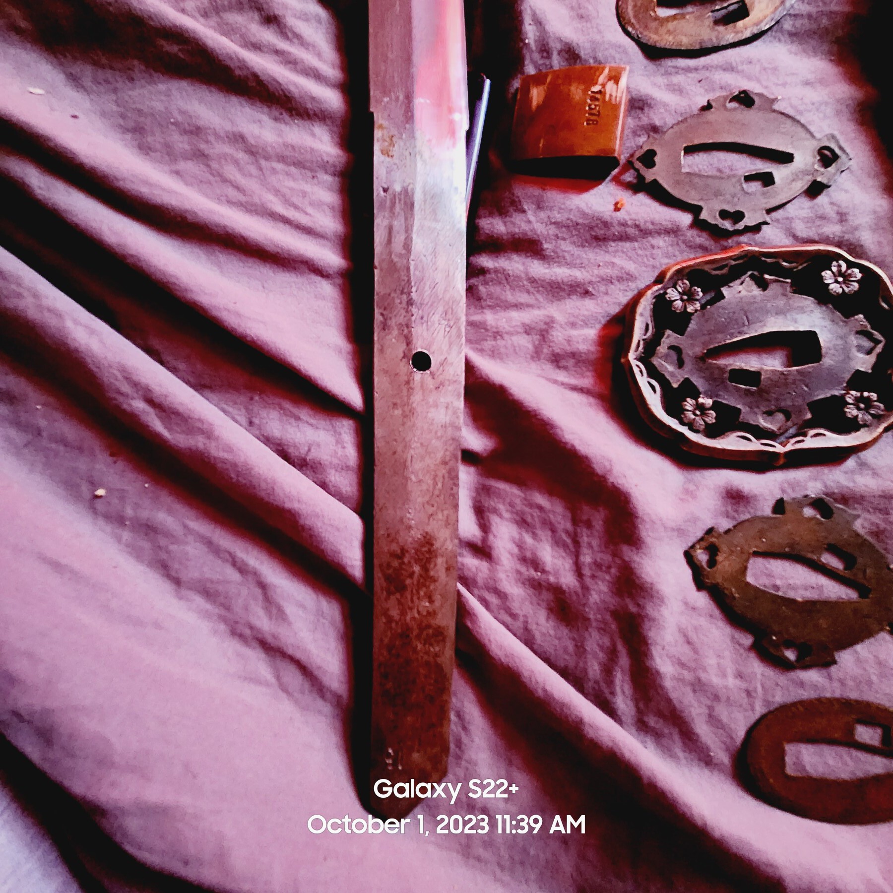

charliefoo33 Posted October 1, 2023 Report Posted October 1, 2023 From what I've been told, this one is fake. Let me know what you think. Quote
John C Posted October 1, 2023 Report Posted October 1, 2023 14 minutes ago, charliefoo33 said: Let me know what you think. Based on the first pic, I believe you are correct. 1) the munemachi and hamachi do not line up, typical of fakes 2) the habaki is numbered, also typical of fakes 3) sarute looks too long = fake John C. 1 Quote
charliefoo33 Posted October 1, 2023 Report Posted October 1, 2023 From end to end its 42 in. And it's heavy for a sword of its size. Hopefully this helps people avoid others in the future. Tyvm for your time. Quote

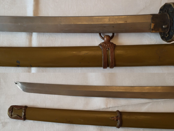

IanS Posted November 8, 2023 Report Posted November 8, 2023 Good afternoon, I joined the forum yesterday mainly because I often got "referred" here when I did Google searches on Japanese swords. I never ceased to be in awe of the wealth of knowledge, so here I am to hopefully gain some of it. I apologise for introducing myself here, I lost the section of the forum where I should have done this. Having read your posts on this thread, I thought I would bring to your notice a type 95 for sale at auction, I'm satisfied that my conclusion is correct in that it is a fake, but I'd love to hear your views. I have put the web address below as I'm not sure about putting up the auction house photos in case of copyright problems. https://www.the-sale...cc-a26a-b0a801264bff Best wishes, Ian. Quote
Kiipu Posted November 8, 2023 Report Posted November 8, 2023 Hi Ian, it is a Chinese reproduction as you state. Just look at the position of the scabbard hanger compared to a real Type 95. 1 Quote
John C Posted November 8, 2023 Report Posted November 8, 2023 2 hours ago, IanS said: I'd love to hear your views Ian: Another tip-off. Note the style of numbering is in the wrong font. Also, the bo-hi has been clearly made by a grinder and isn't long enough. John C. 1 Quote
Conway Posted November 8, 2023 Report Posted November 8, 2023 The serial number should also be between the bohi (blade fuller) and mune (spine) of the blade. The tsuka (handle) is poorly cast with very little detail and there is no habaki (blade collar). Conway 1 Quote
