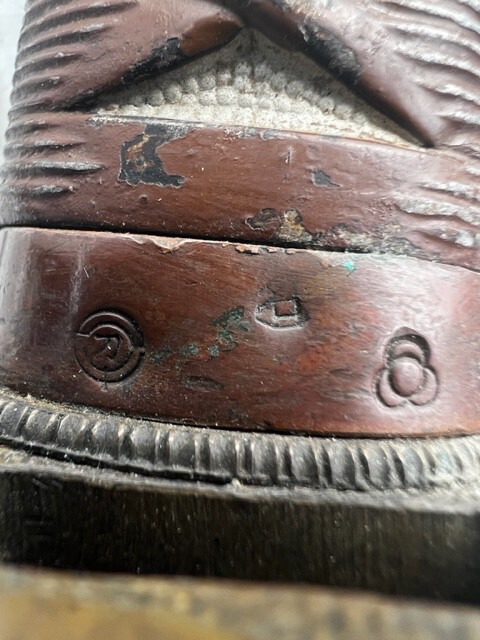

@B Harbin Note on the fuchi, the center stamp is 名 for Nagoya Arsenal (to the left of the cannon balls stamp) The blade stamp following the serial number, however, is 東 for Tokyo. They should match and the Nagoya inspection stamp and serial are read blade up (upside down). So the blade and handle are not original to each other at least from the production standpoint.

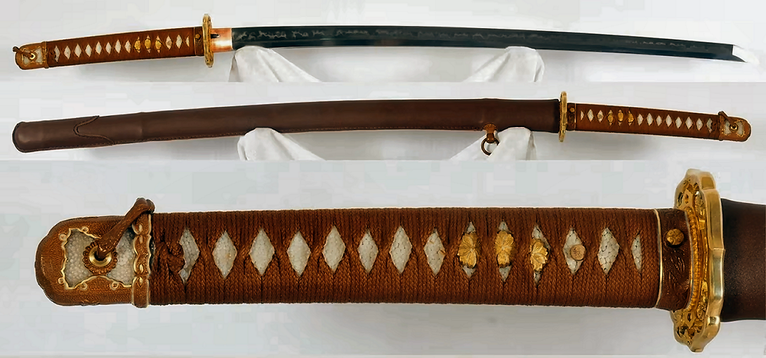

;-) Found this Type98 "shin-gunto" on etsy. Brand new.
It's not a Type95 but it looked very "authentic" for a replica. The blade is called 1095 steel.
The tsuka maki binding is correct ( left/right) and the details looks good.
The price is with 899 Dollar not so far from a real Typ98 in good condition.

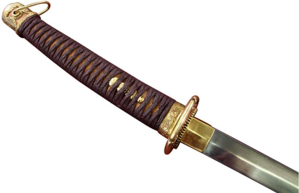

And the next one on ebay. Shipped from Hong Kong with a T-10 steel blade.

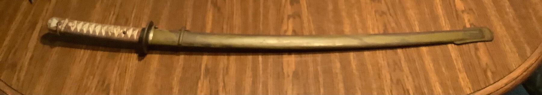

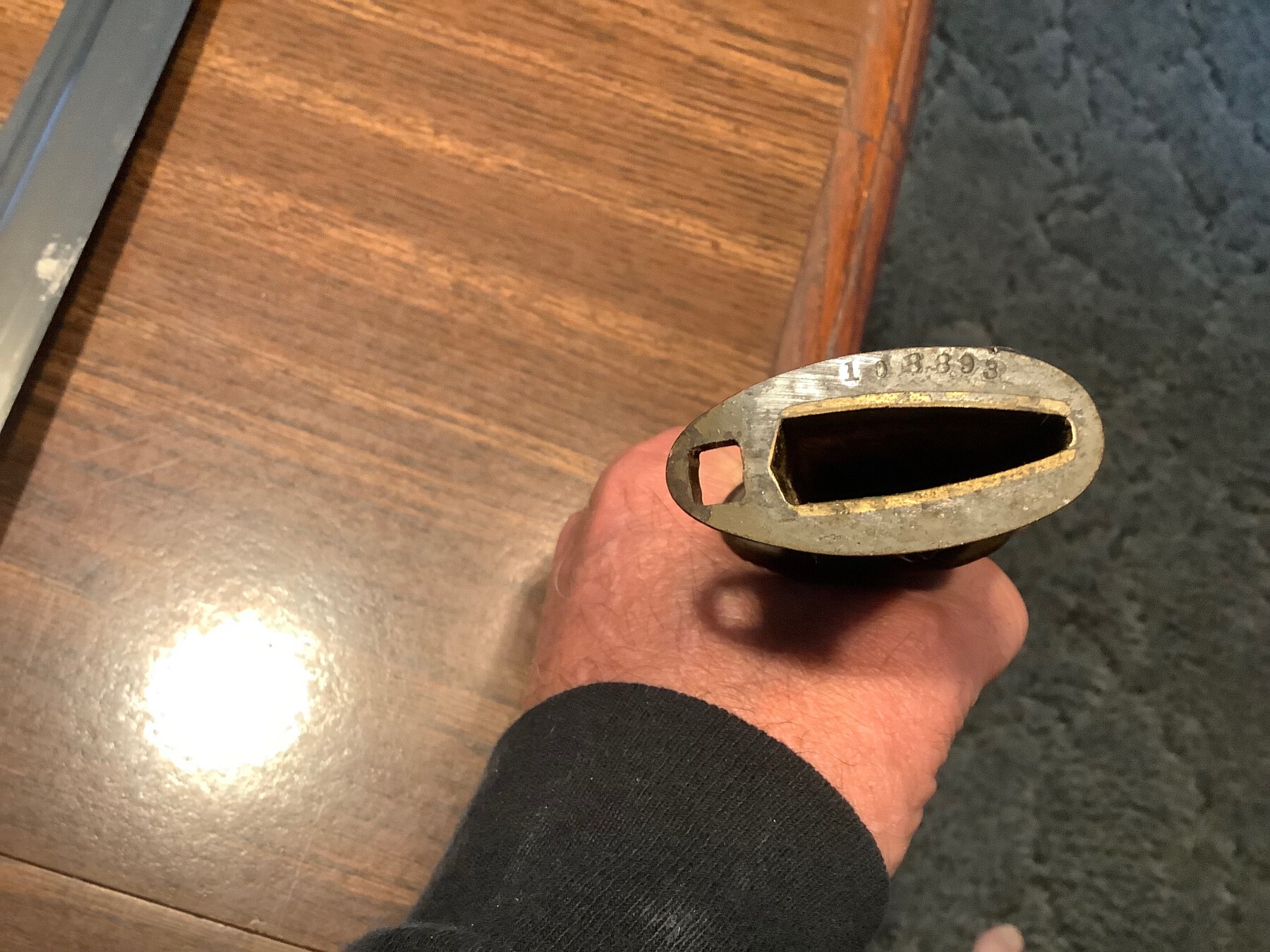

Ok Guys a friend of mine that owns a pawn shop just got this in real or fake and estimated value before I make him an offer
@Bruce Pennington
This Blade #160869 might be transferred to Nagoya Arsenal for completion or repurposed and sent to Nagoya Arsenal for rework. Initially, it was expected to have an Ijima band and iron tsuba. The last batch produced by Ijima spanned from serial number 159031 to 161752. Around serial number 160075, they transitioned to using steel guards. Ijima halted production in March 1945 due to B-29 bombings.
  • Love 1
Ah, that would explain it.  This reminds me of the recent discussion of Nagoya doing some repair work on Suya copper 95s.

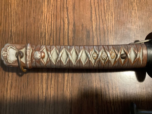

I thought I should say thanks to all of you for the education I'm receiving, I've just spotted another two fake type 95's for sale by auction.  Both described as WWII NCO swords' one I remember has an estimate of £400 to £500, with just short of a 35% buyers' commission!  Photos of this sword attached.
Ian
  • Thanks 2

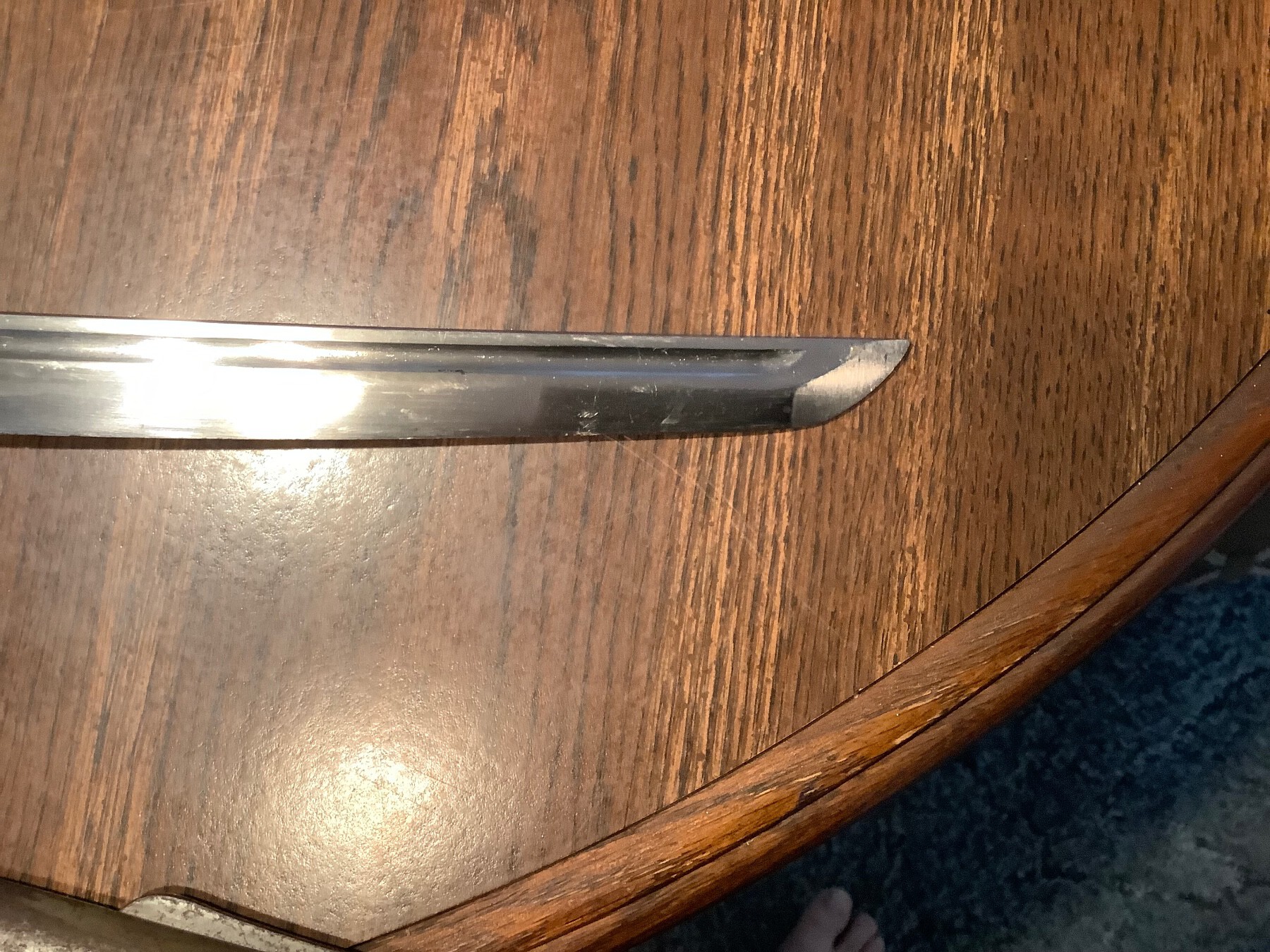

Well done!  So for those who are still learning, why don’t you describe a couple of the features that identified this as a fake to you, if you don’t mind.
Hi Bruce,
my first reaction was to the blade, the fuller does not finish correctly at the tsuba end, it tapers out if that's the correct term and looks to have been ground in.  The top edge of the fuller to the mune is too wide.  The serial number font looks wrong.  The saya latch is sharply bent.
The photos aren't good enough for much more comment.
Ian
Thanks Bruce, glad I didn't embarrass myself.  What about the serial number font?  I haven't seen it before and it just looked wrong.
Ian
Definitely. The vast majority use the pictured font. Check out the 3 and 5 particularly.
John C.
