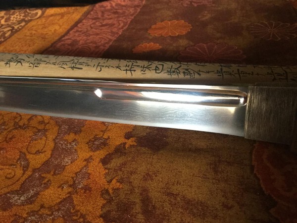

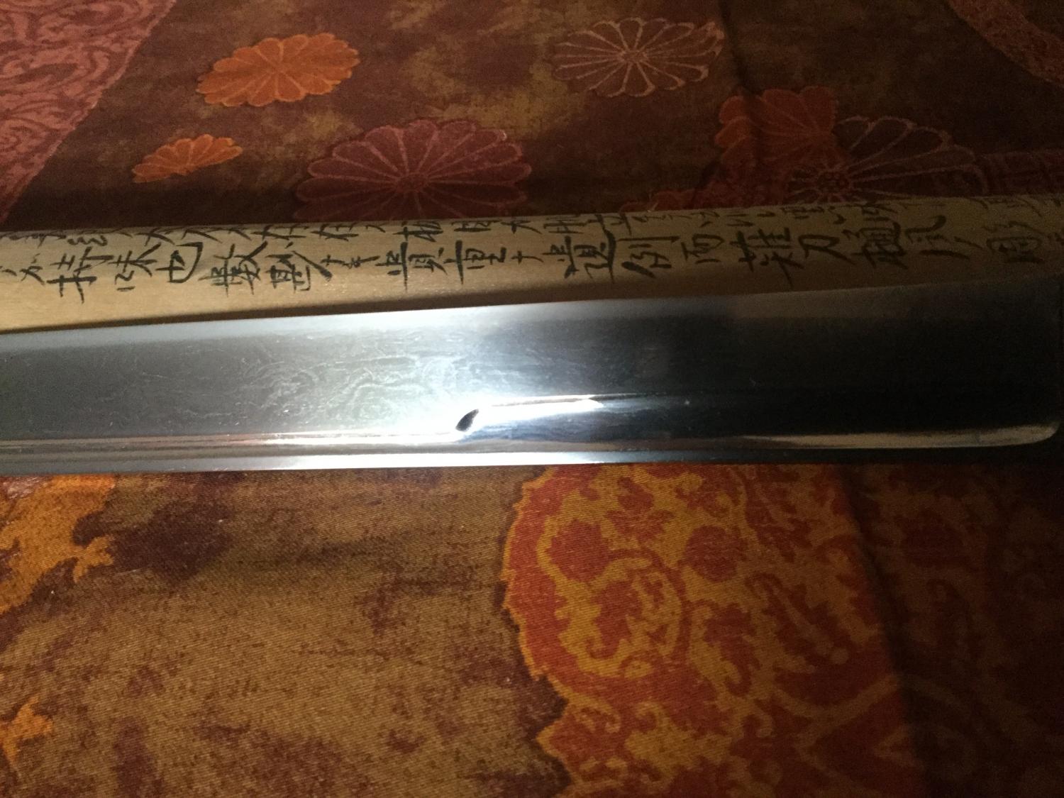

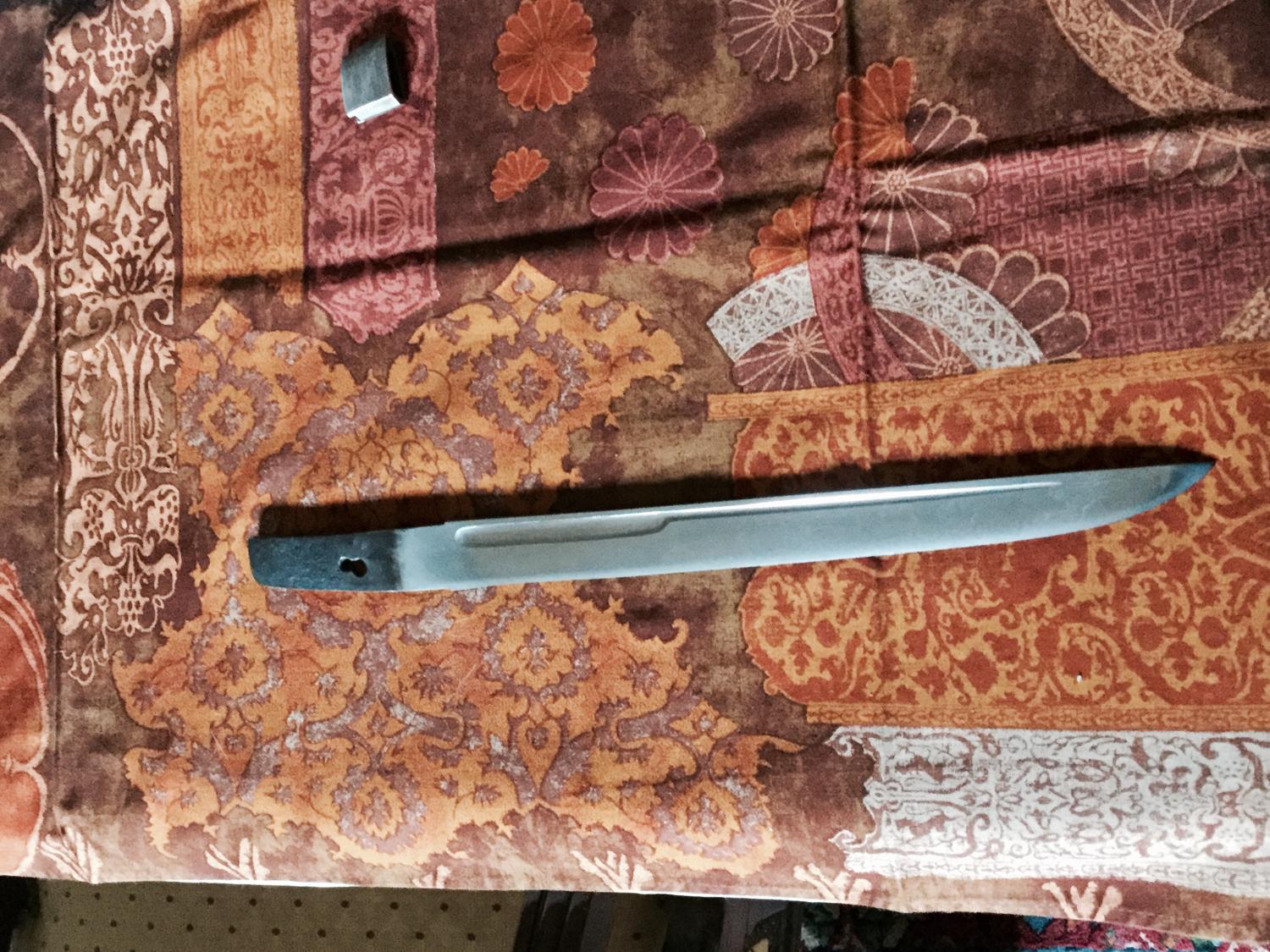

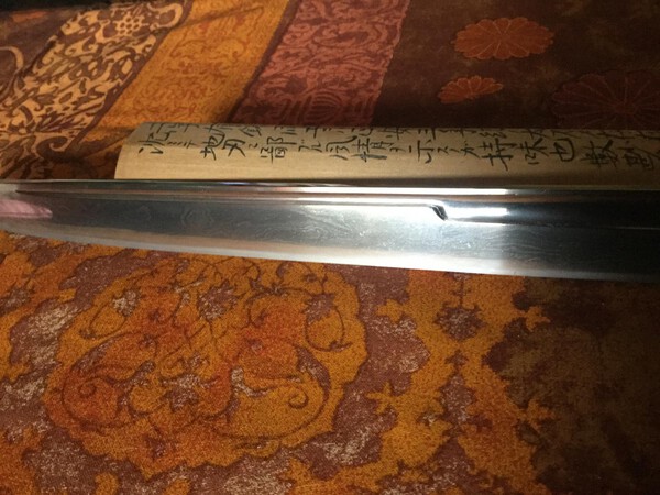

Jean Posted March 29, 2016 Report Share Posted March 29, 2016 Here is my last, last, last, last purchase. Next one my dear wife kills me It's a tanto, try to find the period, the era, the school, too difficult to find the smith. The sayagaki says it all. I add a few pictures, I have taken quickly before my wife comes back Length about 27,2 cm, motohaba 2,7 cm 5 Link to comment Share on other sites More sharing options...

lonely panet Posted March 29, 2016 Report Share Posted March 29, 2016 as a noob, heres my go late kamakura, early nambochuko, Bizen tradition. and again maybe yoshii or osafune school????????? Link to comment Share on other sites More sharing options...
Jussi Ekholm Posted March 29, 2016 Report Share Posted March 29, 2016 It's very fun exercise. I can't really participate as by trying to nail it down I ended up finding this tanto. So I guess I was kinda in right direction but I was still very far actually... In my case it was luck and not skill pinpointing it down. 3 Link to comment Share on other sites More sharing options...
BIG Posted March 30, 2016 Report Share Posted March 30, 2016 Hi, Tsunemitsu, Bizen Province, Shoo Era, Ko Bizen School Best Regards Link to comment Share on other sites More sharing options...

Marius Posted March 30, 2016 Report Share Posted March 30, 2016 Attributed to Etchu Norishige, but it is an Uda tanto Link to comment Share on other sites More sharing options...
Jean Posted March 30, 2016 Author Report Share Posted March 30, 2016 Can't be attributed to Norishige, Markus, as it is signed according to the sayagaki. 3 kantei to Uda as so far. Link to comment Share on other sites More sharing options...
Marius Posted March 30, 2016 Report Share Posted March 30, 2016 Oh dear, I haven't looked at the first picture with the description. Link to comment Share on other sites More sharing options...
javier Posted March 30, 2016 Report Share Posted March 30, 2016 Hi Jean and colleagues please consider I am a beginner! My bet is Uda school too from Late Kamakura early Nanbokucho. Javier 1 Link to comment Share on other sites More sharing options...
Jim P Posted March 30, 2016 Report Share Posted March 30, 2016 Hi Jean, It had me thinking maybe Kyushu and Chikuzen Kongobyoe but then Uda is a not a bad bet 1 Link to comment Share on other sites More sharing options...
nagamaki - Franco Posted March 30, 2016 Report Share Posted March 30, 2016 http://nihontoclub.com/smiths/SUY62 Link to comment Share on other sites More sharing options...
Jean Posted March 30, 2016 Author Report Share Posted March 30, 2016 Interesting answers, even a dozen in pm and a atari with a hint. A big hint: a member via pm that this sword made him thinks of Jitsua, I gave him a hint. In the Connoisseur's book of Japanese Swords, in one of the main tradition there is at the end of the chapter, the schools influenced by the tradition: Chikuzen predating Samonji. So you have the tradition, now which school and why. I think Barry can find it Link to comment Share on other sites More sharing options...
SwordGuyJoe Posted March 31, 2016 Report Share Posted March 31, 2016 It is not Bizen. ...I am so bad at this... 2 Link to comment Share on other sites More sharing options...
Mark Posted March 31, 2016 Report Share Posted March 31, 2016 It reminds me of a naginata i saw by Jitsua, but I think that blade was Nambokucho so he may be a bit too late for the date so at first i thought Sairen, but with your hint maybe Ryosai or his brother Nyusai ? Link to comment Share on other sites More sharing options...
Jean Posted March 31, 2016 Author Report Share Posted March 31, 2016 Ok guys, time for solution: Sukemitsu Senju'in, late Kamakura Here is a comment from Darcy on this jo saku smith: "... there are no signed tanto by this smith as far as I know. In fact, no tanto at all. There are three signed Juyo and one mumei tachi. One of the three signatures is a bit weak. The other two are strong like yours, and one of those two is the Tokuju one. The dated one that everyone refers to is not in the Juyo or Kokuho or Juyo Bunkazai, therefore it is Juyo Bijutsuhin. I've cataloged everything else. Certainly a Juyo candidate. Rare in the extreme to maybe being the only existing tanto by this smith. I saw this tanto before but it didn't register on me (and probably everyone else) how rare it was. I saw this horimono only on one other occasion. It's on a Juyo blade somewhere and I'll try to dig it up. But it is indeed a great example of Tanobe sensei using every piece of available space because something is rare and special." 4 Link to comment Share on other sites More sharing options...

nagamaki - Franco Posted March 31, 2016 Report Share Posted March 31, 2016 Suggestions, thoughts, First, to myself, why do you succumb to participating? Secondly, stick with your first answer. Thirdly, when such challenges are presented, even just for fun, the presenter needs to honestly take their own test. Here, although there is some description about the hamon, without any word of nie or nioi, not to mention hamon activity, [makes it near impossible to determine from the images other than outright guessing by chance], it really leaves one hanging. So, please, paint a whole picture, go through the kantei yourself as the proof is in the details. And, finally, Jean, appreciate your sharing Link to comment Share on other sites More sharing options...
paulb Posted March 31, 2016 Report Share Posted March 31, 2016 As an interesting, at least to me, aside when I first heard this was ko-Senjuin I was very surprised. The only other example I had seen was an image from many years ago of a long sword in the A Z Freeman collection and to be honest the hada looked nothing like this. Then by chance I was looking at Andy Quirt's site (nihonto.us) and he has a ko-Senjuin Daito where the hada has much in common with Jean's so I can start to see where the attribution came from. Picking up on Franco's point, when we were in Japan at Bob's evening event and doing kantei he handed out worksheets. I seem to remember one had been reproduced here. Can I suggest that if we do this in the future the person setting the kantei uses this sheet as a prompt to make sure the images and description supplies all the information needed to work to a conclusion. That way we can besure we dont overlook some vital piece of information and certainly in my case make up for generally less than perfect images. Link to comment Share on other sites More sharing options...
nagamaki - Franco Posted March 31, 2016 Report Share Posted March 31, 2016 Paul, thank you for this latest reply as coincidentally the Quirt sword crossed my mind along with Tegai Yukimitsu. However, the lack of brightness combined with no wording or images of nie of any kind changed my mind. Link to comment Share on other sites More sharing options...
