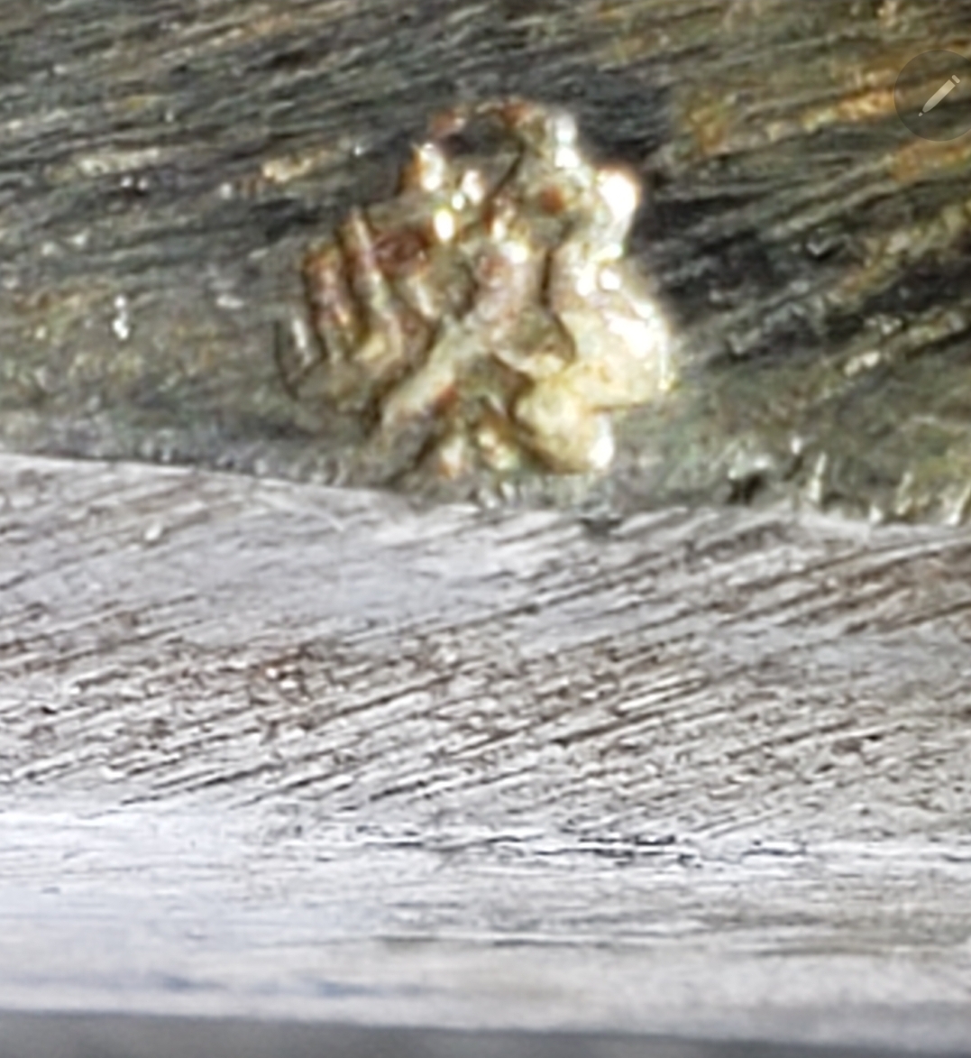

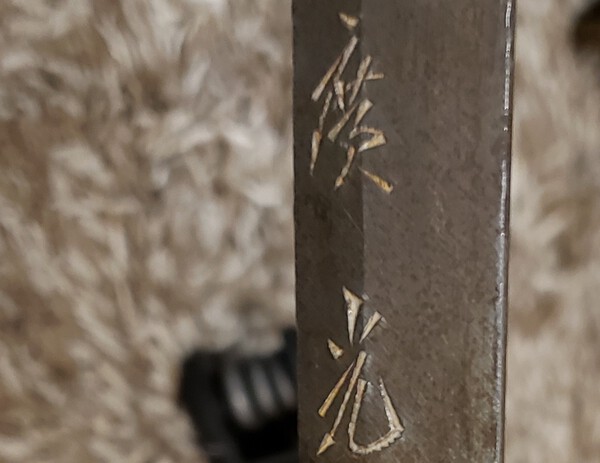

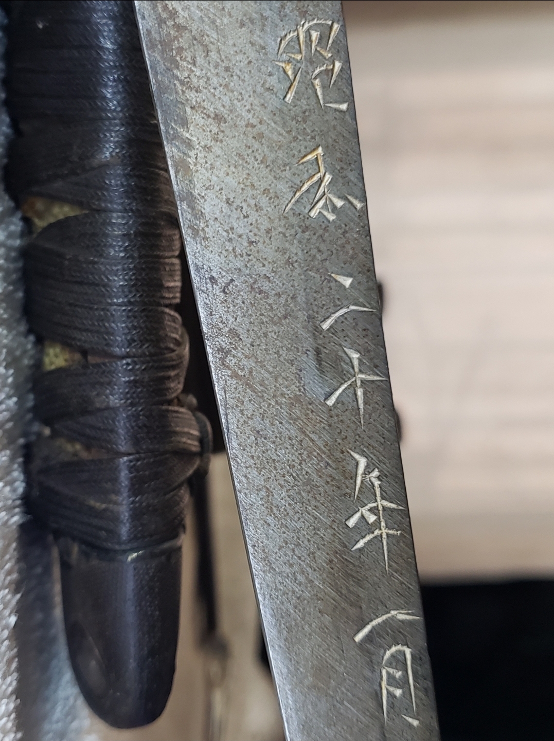

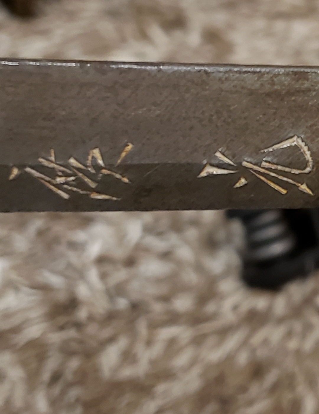

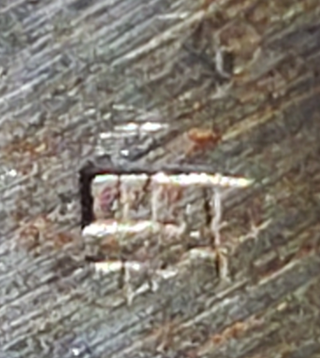

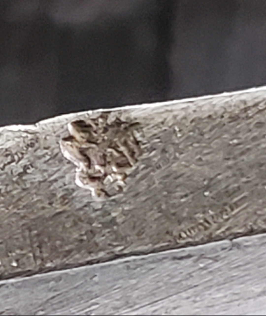

Robinson Velasco Posted June 11, 2020 Report Posted June 11, 2020 Hello every1. I'm new here, I've had 2 ww2 vintage swords that I have been trying to decifer. I have had some help but not a 100% assured hit. I have 1 that is unsigned and was told that it might be a koto or shinshinto. The 2nd sword is why I'm here. I have, from what I was told and doing my own research on the mitsu and stamps, a August 1945 hiromitsu, but I dont find the signature anywhere to match, the mitsu is a definite. The Hiro is the problem. It also has 3 stamps. One is definitely a gifu (gi) stamp the other 2 are what I think, and correct me if I'm wrong... one stamp is a Ren- Nanman Arsenal Dalion Factory, and 3red I think is another gift stamp or cherryblossom tree... I'm leaning more to figure. I would really appreciate if anyone's expertise, considering that I am only a novice. I will place pics on the next posting 1 Quote
Robinson Velasco Posted June 11, 2020 Report Posted June 11, 2020 Is this a hiromitsu August 1945 gifu stamp, Ren Nanman Arsenal Dalian Factory stamp and maybe a 2nd gifu or cherrybloosm stamp? Thank you in advance. Quote
SteveM Posted June 11, 2020 Report Posted June 11, 2020 Hiromitsu, January 1945. Seki stamp, two Gifu stamps, and I can't make out the small stamp next to the Seki stamp. I guess there is one other round-ish stamp there, but I can't make it out. Quote
