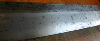

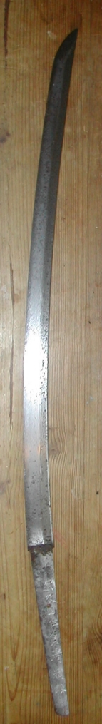

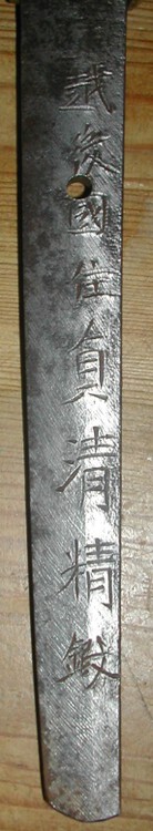

Mark C Posted July 27, 2007 Report Posted July 27, 2007 Hi everyone, I recently picked up this Katana in a rough state of repair, covered in surface rust and had the nakago sand blasted, anyway details below: Nagasa = 25 1/8" Sori = 5/8" O-Kissaki Dated - Showa 18 (1943), no arsenal stamps I think I have translated the mei correctly as Echigo Kuni Ju Sadakiyo Seitan. Is this correct and what is the meaning of Seitan? Also I have trawled my books and the web for Sadakiyo but can only find Echigo Kuni Ju Kamimure Sadakiyo, this being in the Showa oshigata database but unfortunately this is written is Grass/Soshu script? Does anyone have any additional info on this smith? Many thanks Mark Quote
Guest Nanshoku-Samurai Posted July 27, 2007 Report Posted July 27, 2007 Hello, looks like a quality Gendaito. Could you please also post some pictures of the blade? Quote
Nobody Posted July 28, 2007 Report Posted July 28, 2007 I think I have translated the mei correctly as Echigo Kuni Ju Sadakiyo Seitan. Is this correct and what is the meaning of Seitan? Hi, Your reading is correct. Seitan means "devotedly forged". 1 Quote

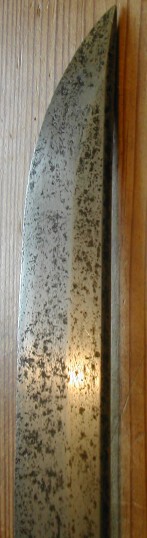

Mark C Posted July 28, 2007 Author Report Posted July 28, 2007 Hi Nobody and Nanshoku-Samurai, Thanks for your comments. I have posted a few more pics. As I said, its in a bad state, I have included pics of overall shape, Boshi including general condition of blade and after several hours of finger stoneing, what Hamon there is. Again thanks Mark Quote

Bruce Pennington Posted April 12, 2021 Report Posted April 12, 2021 On 7/27/2007 at 2:31 PM, Mark C said: Nagasa = 25 1/8" Sori = 5/8" O-Kissaki Dated - Showa 18 (1943), no arsenal stamps I think I have translated the mei correctly as Echigo Kuni Ju Sadakiyo Seitan. Mark, Any chance the nakago has numbers stamped on the end of it? If so, could we get clear pictures of it and both sides of the nakago? Is it star-stamped? 1 Quote
Mark C Posted April 12, 2021 Author Report Posted April 12, 2021 Sorry Bruce, No numbers or stars. Regards 1 1 Quote
