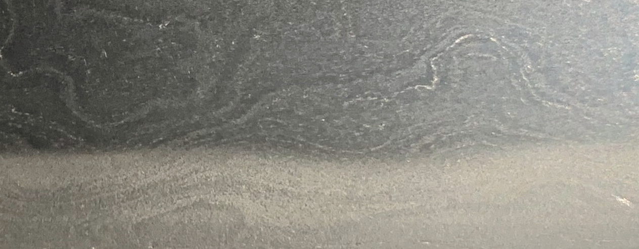

Well, here is another brain teaser, equally malicious to the last one.
Except here the work is a very typical style for the smith, though I particularly like the quality of this example. It is signed. The smith belongs to the school which is for some reason one of the most often referred to by its name on the forum! Actually I did a few searches and it came out as the most often referred to, but by a small margin I did not try very hard - so one of the most. Anyone cares to make a guess?
For a moment, when you said “ the school most often referred to ", Bungo crossed my mind. Then I thought about the school's reputation and thought it looked too good. Proof that we often have misconceptions induced by traditional views on a school.

I feel there is a huge difference between mumei swords attributed to Bungo and those signed by Kambun era smiths. Motoyuki was a very decent Soshu smith, Yakinaga did impressive work in suguha, there was even a good done Bizen a-la Ishido Korekazu. The attributed pieces however tend to be...

I mean, there is a real tendency to attribute mediocre mumei pieces almost automatically to Bungo. A mumei piece could come from anywhere and a swordsmith who deliberately skipped signing is work because he felt it was bad probably produced something far from his usual work. Bungo has become the dumpster name for anything mediocre. Honestly, most of those I heave seen were far from deserving that bad reputation.
"Typical for the smith" that was a real curve-ball you threw there! AFAIK there isn't a single Juyo attributed to him, perhaps in mistake, as this is clearly a fine hada. I don't think anyone of us have any experience with this smith, and common Bungo just isn't very good. The only Bungo I'm vaguely familiar with is Yukihira and the kantei is very easy when ubu.

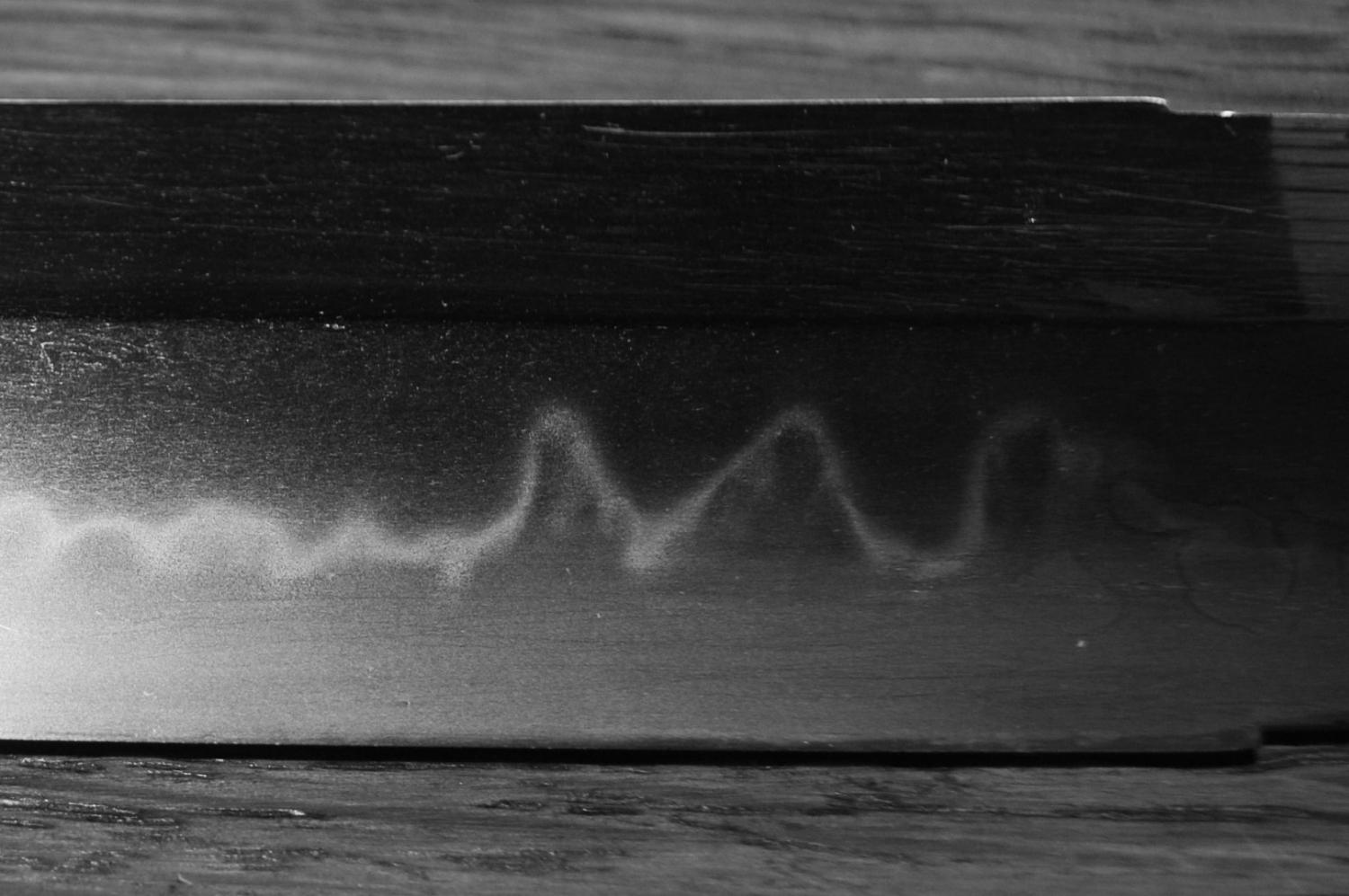

Here is my contribution. Something different, much easier! And move all the way to the opposite of Yamashiro hada. For some vets here this will be too easy to get a good answer (there are 2-3 "good" answers).
Not sure if it is easy but in line with principals of kantei it exhibits typical features of period, school and smith.
Description: A shinogi-zukuri wakazashi
Configuration:
Sugata:  Shinogi-zukuri, iori-mune. Ubu with nagamei
Nagasa: 39.3cm.                Sori: 0.6cm.
Motohaba: 2.9 cm.              Sakihaba: 2cm.               Kasane: 0.6cm
Hada: fine Itame with Nagare and O-hada with ji-nie and chikei. There is a patchy midare utsuri and masame in the shinogi-ji. There are areas of plain bright steel within the jihada.
Hamon: Midare with billowing but compact choji and isolated areas of togari. The hamon is nioi-guchi interspersed with ko-nie. There valleys of the choji broaden in to small pockets of ko-nie. There is a great deal of activity within the hamon in the form of sunagashi and nie
Nakago: Ubu with 2  mekugi-ana. Kengo nakagojiri and sujikai yasurimei (with slight keisho)
Mei: There is a Naga-mei .
Boshi. Hakikake beard with profuse Nie. Ko maru with narrow return
Hi Jp
I assume you are responding to the one I posted.
If so:
First look at the shape- it will give you an indication of period
Then read the description there are a number of pointers in there that would lead you somewhere else.
I think the togari and sunagashi are making you jump in one direction and you have considered what else it is telling you.

Looks like Etchu. Maybe Tametsugu.
Kirill R.
For Chris: Norishige student or school. Could be Tametsugu
For Paul: various elements make it sound more Mino to me (hakikake, a lot of nie that I can see, sunagashi, various togari), even though from a distance the hamon looks Bizen and some of the midare utsuri and hamon and choji and you mention nioi actually point to Muromachi Bizen. On balance, your description is more Bizen but I would need to look at it in hand

I will be a little argumentative here - your other photographs are very good. Here its very hard to say anything without seeing the boshi at least, a little bit more of ha would also help. The shape is dead ringer kambun I guess. Hakikake is common in Horikawa school, which however tends to come with Keicho or Kanei shape, which its not. One of the reasons I don't like and don't do shinto kantei is that it requires one to memorize tons of small things with little to no structure. We are looking for someone who did hakikake and utsuri, a very rare combination. Can be Edo Ishido. Can be Dewa no Daijo  Kunimichi. Very different styles, but without seeing a bit more of those togari-or-choji, hard to say at least for me.

All good answers. Michael is closest with "Student of Norishige" and I think you've all guessed right the Etchu influence here. Tametsugu also possible.
Attribution is Kachu Sanekage. Traditionally understood as a student of Norishige.
When the Matsukawa hada is less masterful, the next best guess is generally Sanekage, which can be understood as "Not quite Norishige".
Thanks Chris
It was a good image and very distinctive hada. I dont feel too bad going for Norishige. In a shoji kantei it is normal for an attribution to a student or master of the smith concerned to be counted as correct.

I have attached an image of the boshi (my apologies it doesn't show the detail too clearly but it does show the overall shape) and some more showing hamon
