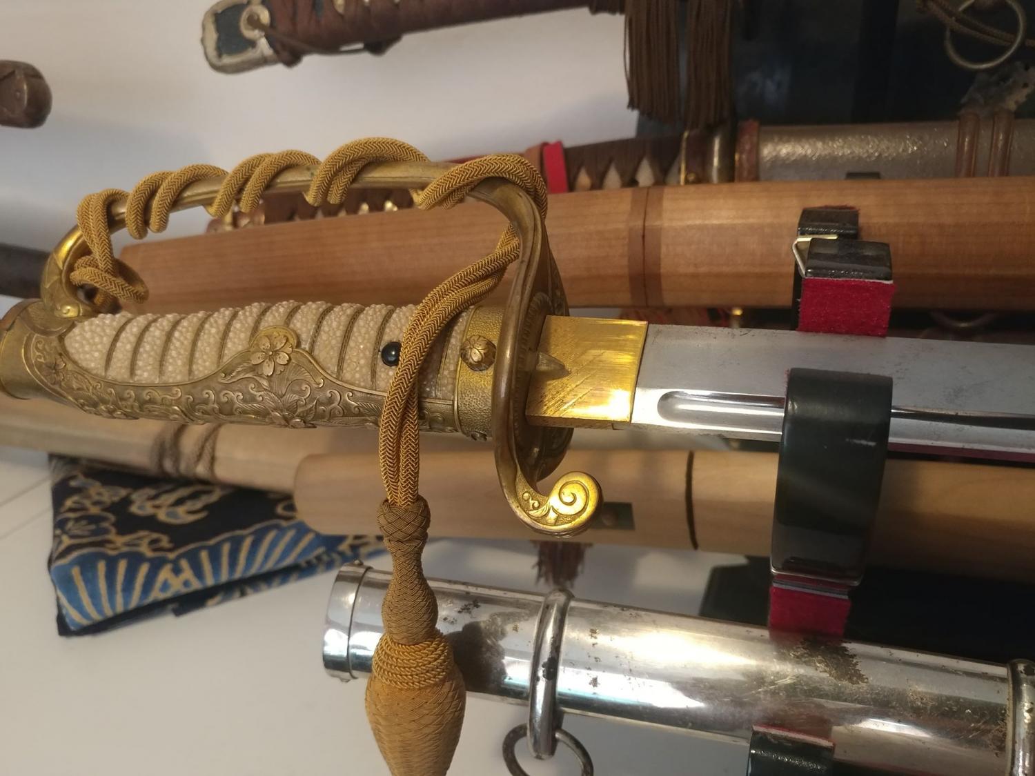

Hey guys,
I want your maximum scrutiny on this blade here. It is alleged Kyu Gunto, but the length of the blade and the apparent looseness of the nakago in the grip throw me off. It is firmly of wakizashi length at a mere 21.5 inches for the nagasa and with a sori of .25 inches. It is signed "Nobuyoshi" but that is the word of the seller. I believe the grip and blade itself are Japanese but with its slight looseness (which may be due to a poorly sized mekugi), there might be a possibility its a put together. It does have both rear and forward seppa. The scabbard does fit it well, but it is about four inches longer than the blade itself (though internally, it appears to fit tightly).
I suppose I am asking a few things:
Were Kyu Gunto of non-katana sizes (even at 21.5 inches)?
Do you think this is a put together?
What is the smith's name?
Whats the possible age range for this blade?
Thanks gents!
~Chris

The term KYU Gunto doesn't present to a sword of a specific length.
But to type of military mounts it is inn. Lengths of you gunto can be from tachi to ko wakizashi.
The piece looks very honest, and complete. Still has 2 ashi and the gilt is 90%. From a ex IJM collector this looks like a great piece

Posted 14 March 2019 - 05:29 AM
Signed Nobuyoshi. Koto. Probably Mid to late Muromachi.
That's good! Because if it was 4 inches shorter than the blade you would have to cut off part of the blades tip to make it fit ....
Yes it is a later set up by any means as these mounts were not available at the time the sword was made ... I have no reason to believe that these mounts had not been made for this blade in the 1st case. It is totally fine. The mounst ar ein good condition.
Wheter the signatur eis SHoshin I have no idea. Would need to look up which Bobuyoshi this one wants to be. If it wants to be an average Joe it is likely Shoshin. If it wants to be a big old Koto guy then you are mst likely looking at a fake. The Hamon and blade do not suggest anything pre Muromachi eventhough the tang looks worn.
The blade is good for what it is. Taking out the sigature question it is a solid piece which was probably priced accordingly. I suppose it came of komonjo? If Komonjo gives a name translation you can assume that his translation is accurate.
A blade of this size makes sense for this kind of mount as it is supposed to be swung with one hand.

Both the sword and mounts are original in their own right. Whether or not they both belong to each other is an entirely different matter, the fact they come from Komonjo makes them somewhat suspect already. It looks like a good example though & if original a great addition to any collection.

Yup Luis, you got the nail on the head. Komonjo did sell this to me. I know he does sell some spurious things, but this was something I felt relatively safe on. I still wanted to see what you guys thought of it and get some affirmations. The only issue I can spot with this blade is how relatively loose it sits in the mountings. I am guessing that the wood has shrunk with age or the mekugi is simply inadequate at tightening up the whole assembly.
As for Mike, I did email him about it and he was fine with taking a return. But I think I will keep it. I feel more confident on it. I did a lot more homework on it and after comparing it with other examples (a number of which were the same or sometimes shorter), I feel fine in keeping it. Mike also did tell me upfront that he consigns things and only inspects them to make sure the translations given are correct (as in literal) but that he does not inspect for gimei/fakes. So as the old phrase goes "caveat emptor."

Mike is a honest vendor. He conseigns stuff and makes no false claims. He just turns things over and does not do any Koshirae building or mixing. If he sells a big name guy without paper he give the gurantee to happyly buy it beg when ruled Shoshin :)
In your very case I do not think that someone took a Kyu Gunto Koshirae and a seperate blade. Chances of the peg hole and Saya matching another blade would be very low.
Usually you can spot an assembled set up on how well the Habaki lines up with the Koiguchi.

Well Chris Kyu Gunto were very well made and finished from that era (Meiji), if it does not fit correctly I would be concerned, however if the movement is small then that is not unusual due to wood shrinkage and time. My Kyu Gunto fits up like a bank vault to this day with one Seppa.

The gap between the forward seppa and the habaki is about one seppa's worth of thickness (a few millimeters) which could be due to the ill-fitting meguki or wood shrinkage? The mekugi doesn't even reach the other side of the hole in the grip and sits slightly off. So that may be why. It appears to be a fairly recent replacement mekugi. Not entirely sure. Appearance wise, everything is correct. Its just that gap that seems off.

replacement meguki in military swords is very very common, they shrink, fallout or just fall apart. thats a easy fix.
the seppa in kyu gunto will normally alway appear in sets, rather then in odd numbers. but with posting a good photo its hard for us to say wood shrinkage, or miss placed seppa or worse.
