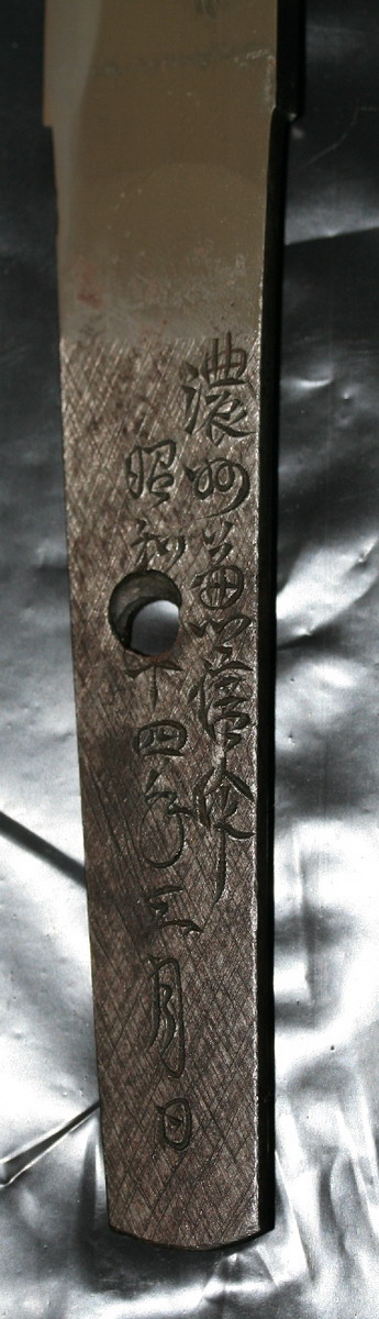

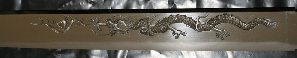

Bazza Posted February 6, 2012 Report Posted February 6, 2012 A few years ago a gendai tanto was offered for sale that had what I thought was a very good horimono of a dragon. I was able to take some poor photos of it in the short time I had available to view it and I offer them here. The tanto is signed NOSHU KANENOBU SAKU with the date on the same side SHOWA JU YON NEN SAN GATSU HI (March 1939). There is another inscription on the omote that I haven't read - I'm sure someone will be able to read it. Best regards, BaZZa. Quote
Bugyotsuji Posted February 6, 2012 Author Report Posted February 6, 2012 Very interesting shots. Many thanks. The writing seems to say 玉代守護刀"Gyokudai kami Mamori-gatana but how and in what way does that qualify this Mamori-gatana? I hope that Kenji san or Koichi san might be happy to comment. Quote
nagamaki - Franco Posted February 6, 2012 Report Posted February 6, 2012 The writing seems to say 玉代守護刀"Gyokudai kami Mamori-gatana but how and in what way does that qualify this Mamori-gatana? A woman's knife for personal protection would be my guess(?). Quote
Eric H Posted February 6, 2012 Report Posted February 6, 2012 A woman's knife for personal protection would be my guess(?). mamori gatana are made as an offering to a newborn, for protection and charm... Eric Quote
John A Stuart Posted February 6, 2012 Report Posted February 6, 2012 Is this type of knife also known as an honour tanto? When the females of the buke (or samurai class in general?) are in full dress there is a tanto in a bag hung from a cord by the neck. The tanto is horizontal across the chest. When the woman is layed to rest the tanto is still part of the dress. It's function is to allow suicide before dishonour. John Quote

Bugyotsuji Posted February 7, 2012 Author Report Posted February 7, 2012 Just for a moment to clarify my earlier question. The final two kanji "Mamorigatana" would be fine on their own, but the 守 before that has me puzzled. It can also read and mean Mamoru. Does it refer to the above or below? Do we read it as a) Gyokudai and then Shu-go-tou? Or b) Gyokudai no kami, Mamori-gatana? Quote
John A Stuart Posted February 7, 2012 Report Posted February 7, 2012 I wonder what 玉代 signifies, how to pronounce it tamagawa, or gyokudai? 守護刀 shugoto, protection knife seems right. Even shugogatana? You got me. John Quote
cabowen Posted February 7, 2012 Report Posted February 7, 2012 I think the first two kanji 玉代 are a family name, either read Tamayo or Tamashiro...Then shugogatana....sword made to protect the Tamayo/Tamashiro family.... Perhaps one of our Japanese members will clarify.... Quote

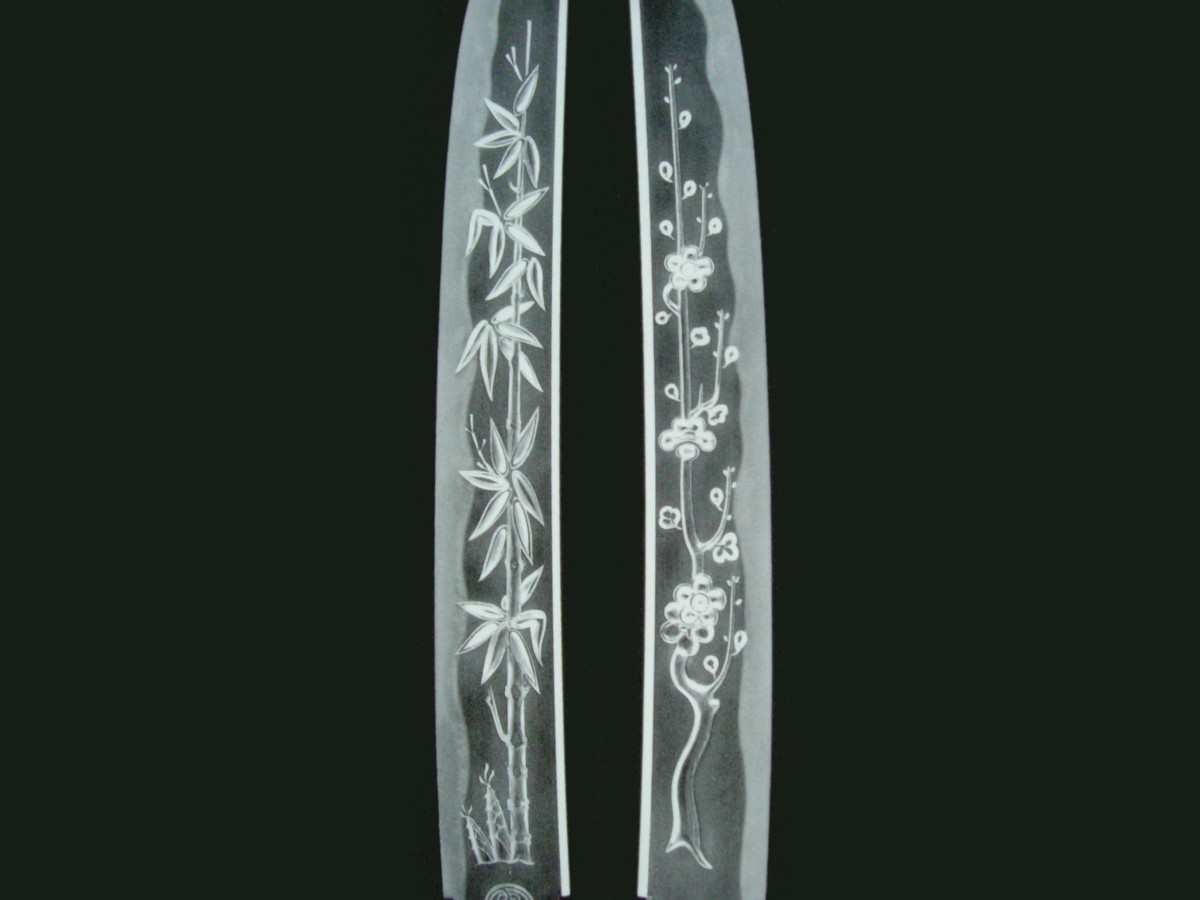

Robert Janssen Posted February 7, 2012 Report Posted February 7, 2012 I have another fine example that's worth sharing in my opinion... Don't know anything about the blade, but a nice horimono none the less. Bamboo and, i think, plum blossom? Greets, Robert Quote
Eric H Posted February 7, 2012 Report Posted February 7, 2012 Don't know anything about the blade It is most likely on a blade by one of the Yasutsugu mon. ...and the detail of a finely carved Mizu-Ryu on a Tanto by Shodai Yasutsugu. Eric Quote
