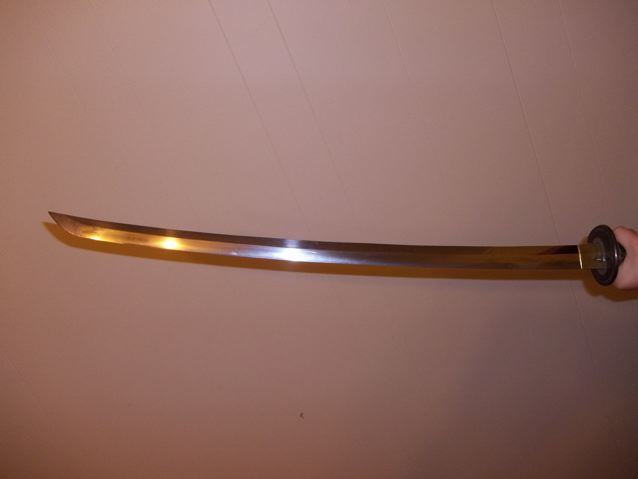

Can you post a photo of the rest of the blade?

I am not sure I agree with the Chinese fake view. Admittedly I am not fully up to date on what the Chinese fakers are now doing but I dont remember them copying late naval swords. Also there is none of the other characteristics such as course attempts to produce grain, bad shape and poor nakago that is normaly seen. The signature is admittedly low quality and "clippy" and I cant read it either. But for the rest it looks like a non traditionally made late naval sword in low cost and late naval mounts.
So not a piece of high art but more likely a piece of WW11 militaty history.
I am sure the military enthusiasts can confirm orr otherwise the authenticity of this sword.

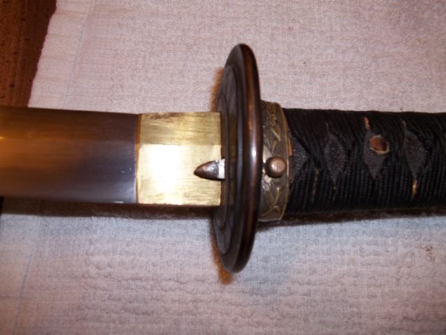

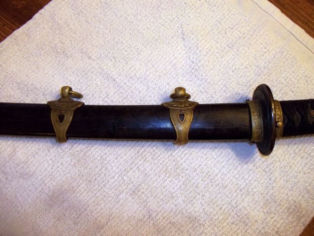

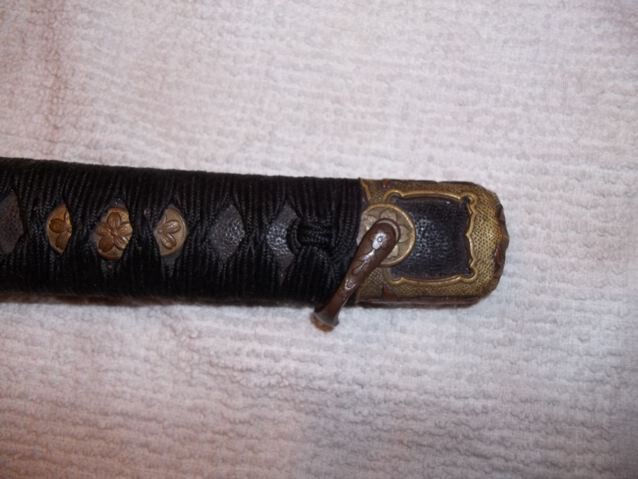

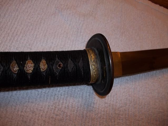

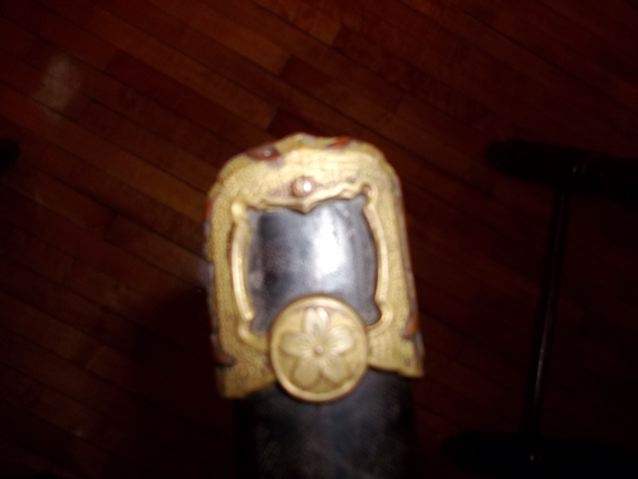

What i see is an original Kai Gunto with illegible signature and a "reworked" or replaced saya (look at the fit of the saya in picture 100_0135_2.jpg ). The fittings, tsuba, fuchi kashira etc. look original, the saya itself does not.

This is an odd sword...the tang looks slightly "wobbly" along the edges, giving feeling of "Chinese fake", but the blade certainly looks genuine WWII gunto. I think it and the fittings point to WWII genuine gunto (non-traditional make).
I think the man who signed this should be found and slapped (hard) by the slap fairy.
Anyway, the first two characters say HISSHO (certain victory)....then ? ? SUKE ? (I think John's call "hiro" is reasonable)...too rough to be certain but could also be SUKEHARU (ji of Meiji)...hope Morita san or Moriyama san see this.
Seems neat and tidy example of a kaigunto.
Regards,
George.
as George said it is an odd sword but it could be good, the fittings as such and koshirae I think are good and will be a close value to what you have paid for the sword, keep researching!

Looks legit to me but has had an amateur restoration. Badly wrapped tsuka and the loose fittings on the saya is a result of someone stripping off the original covering and painting the wood black. The screw heads are another clue. I have purchased New screws that have the perfect thread size, but the screw heads are far to large. Careful filing and a new slot cut with a jewelers file is needed to make them appear original. If you pulled it apart and sold the bits on the bay I suspect you'd make a reasonable profit. So 400 bucks? Cool.
