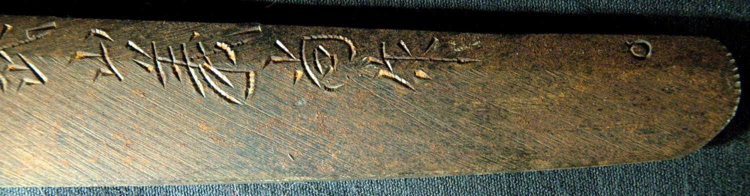

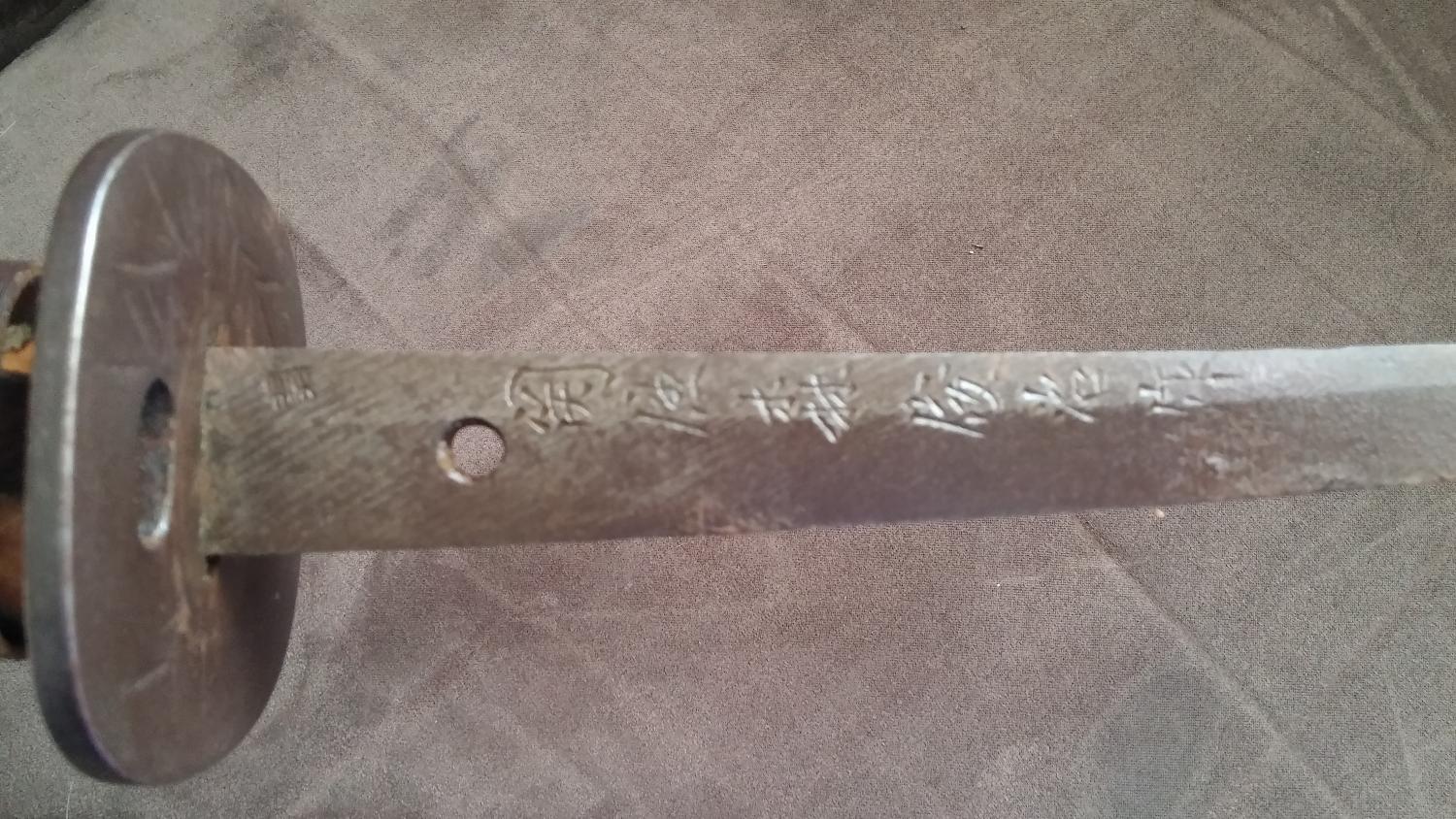

I have seen a Flaming Grenade (possibly Flaming Pearl or Flaming Wheel) cartouche type stamp on a Seki made Shin-Gunto sword. There is a Seki stamp, followed by mei signature, then this cartouche type stamp. Has anybody seen this before?
I thought that perhaps this Flaming Grenade stamp was a commissioning mark for the Grenadiers (Kempeitai)?

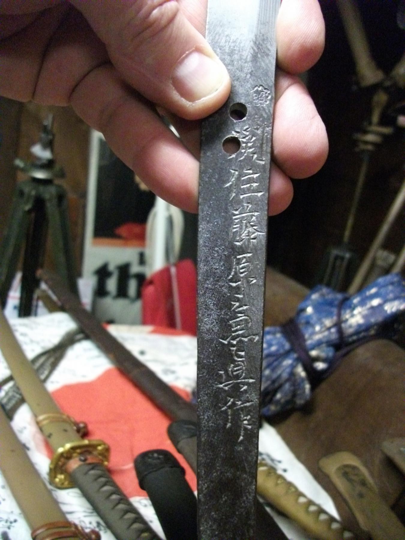

Here is a Seki stamp on the tang of a civilian mounted wakazashi. The saya is fitted with a leather combat cover and a seperate 'extension' to the saya, to make the overall length appear greater.

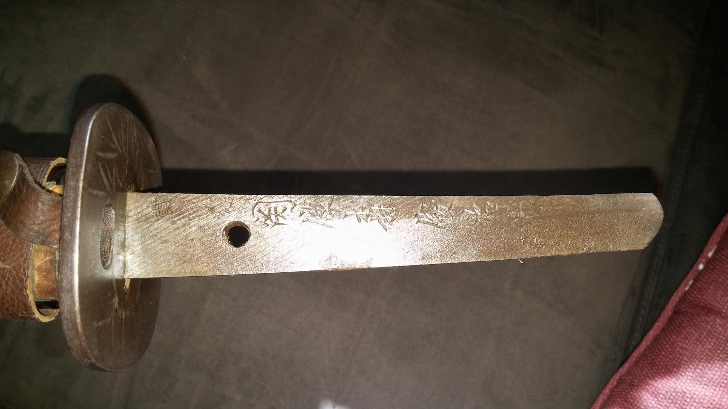

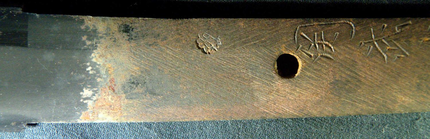

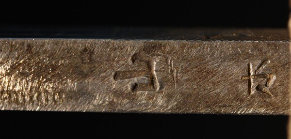

Hi all, new here.
I've been all over the net looking for info on this one at the base of the nakago on the mei side, it's on a sword by Takeyama yoshinao (showato), looks like a pear or apple to me. Anyone seen it before? I'm guessing its a makers kokuin since the sword already has a sho stamp.
Cheers

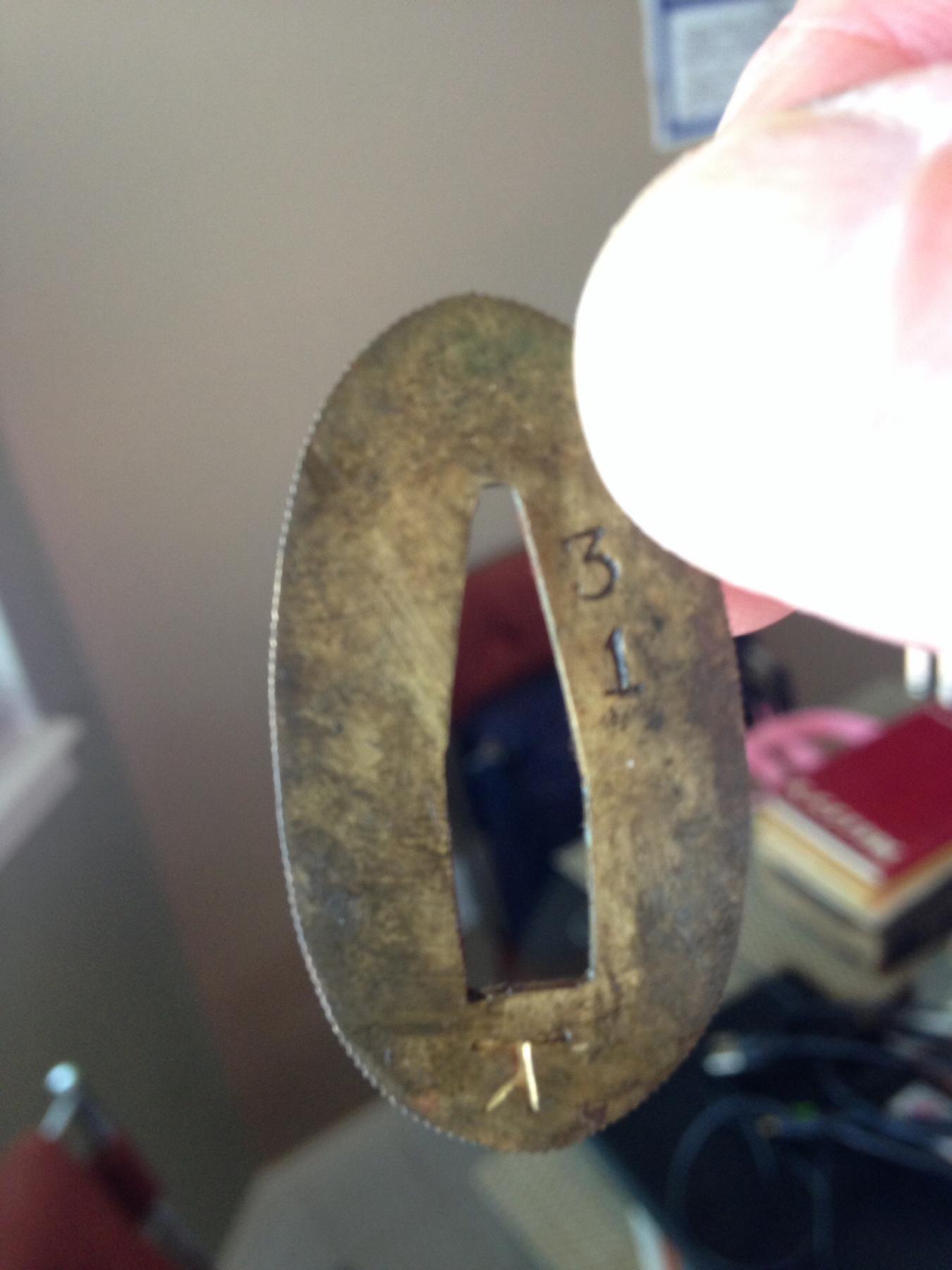

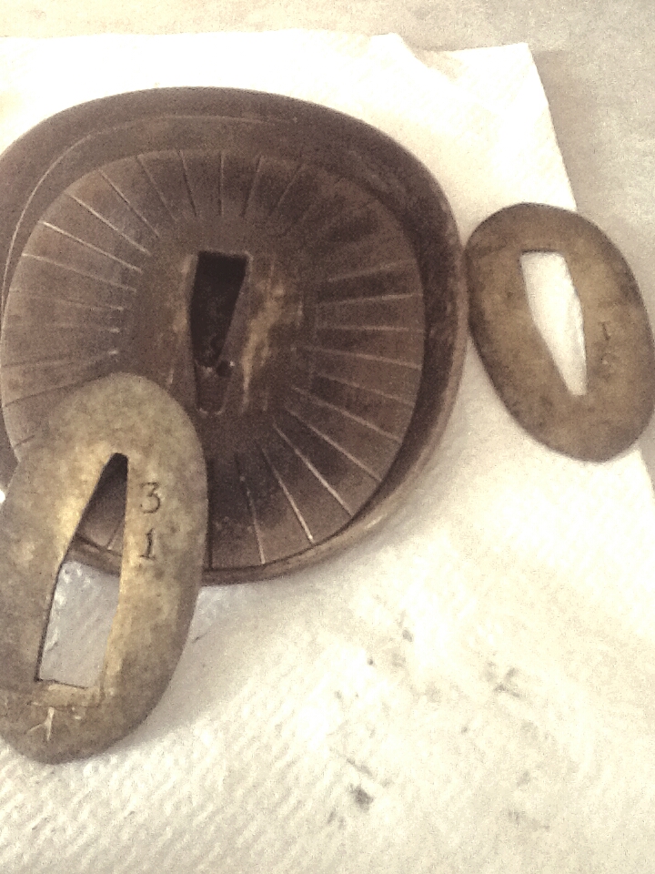

I have an unusual mark on the seppa of a Kai-gunto, that no one recognizes. I have seen the same stamp on the inside of someone else's removable ashi. It comes with a Koto era blade, "Fuji" mon, in sharksin saya. Seems to be a custom job for someone from a well-to-do family.
Its the character 上 (ue), meaning 'up'.  but it's upside-down. Probably means this is the upper seppa.
Daniel, That is possible, that it means "up". I recently saw a character that means "down", and it is the mirror image of it!
On the subject of your apple/pear stamp, I know I have seen a discussion of it somewhere, but I can't find it. I'll keep looking, or maybe someone will step up that already knows.
 I studied Japanese in Tokyo for a year, can speak and read the language, the character is definitely the Kanji for up, but turned upside down.
The kanji for down; 'Shita' is (下), which as you noted is the mirror image of the former.
I'm not 100% sure however that it had the exact significance I suggest, I'm just going with the most likely obvious meaning. It might also be a guide so that whoever is constructing these swords in a factory knows that the seppa goes 'above' the tsuba parts.
Of course, clarification by those with a better understanding would be appreciated, I'm still fairly new to gunto.

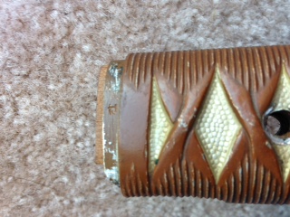

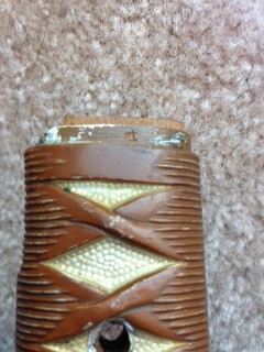

Haven't seen this stamp posted yet: It's a "Sha" on the neck of the tsuka of a Type 95, 2a. I was told it's an inspection stamp for items made by private contractors

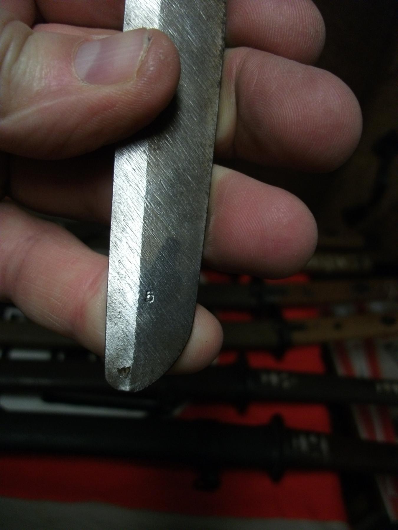

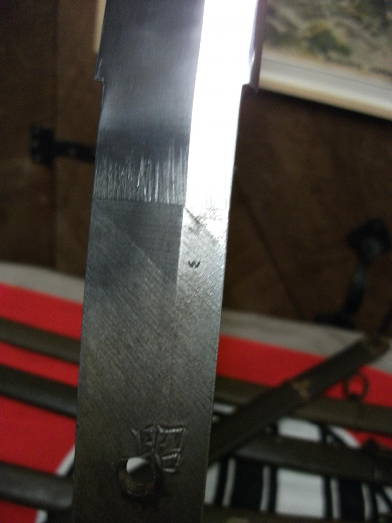

Second pic from the same gunto is a "W" stamp on the nakago. It's my second Type 95 with the W stamp.

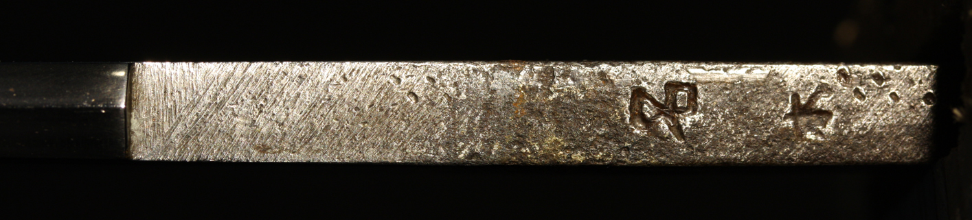

Hi all,
I still have not found an example of this stamp on another mune.
However, on Ohmura's site (http://ohmura-study.net/711.html) I found the what I think is the stamp under discussion.
What I thought was a star, looks very similar -even in size- to the "Se" inspection stamp of the Second Factory of the Kokura Army Arsenal.
Then again, the other stamps on the mune ( a Mai, or Nagoya arsenal inspection stamp and a Ho inspection stamp, accompanied by the number 1 - as on the sepa) are from another arsenal...
Have you seen any occasions where swords bear stamps of multiple arsenals?
Best regards,
Wouter

Or is it the name of the inspector? (Screenshot also from Ohmura)
BR
Wouter
