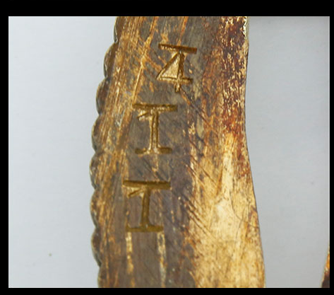

PNSSHOGUN Posted October 30, 2023 Report Posted October 30, 2023 "111" with line at the top. From another Seppa: 2 2 Quote
Bruce Pennington Posted October 30, 2023 Report Posted October 30, 2023 2 hours ago, PNSSHOGUN said: "111" with line at the top. Bingo! What a peculiar way to write the numbers. I have seen a line under 6s and 9s to make it clear which one is which, but this shop is putting the line on top, seemingly on all numbers. 1 Quote
Conway Posted October 30, 2023 Report Posted October 30, 2023 When I saw first saw those markings I thought the horizontal line was a 一 as in 1. Interesting that there is a line above the 4 in the example posted by @PNSSHOGUN. Here is a different example of a 2/二 combination. Anyone have thoughts on why the redundancy was used? Is it possible some workers could not read the Arabic numerals? Conway 1 Quote
Bruce Pennington Posted October 30, 2023 Report Posted October 30, 2023 13 minutes ago, Conway S said: Anyone have thoughts on why the redundancy was used? This is a world we actually know almost nothing about. The reasons and methods of the koshirae fitters is a big unknown. Quote

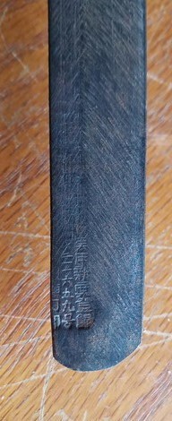

Bruce Pennington Posted November 8, 2023 Report Posted November 8, 2023 On 2/19/2022 at 11:00 PM, Bruce Pennington said: Sadly, I didn't document the smith name on this one. If anyone can tell me the name I would appreciate it! Quoting myself to reference this. The smith on that one was Masafusa. I have found the patented Kabuse method stamp on both Kaneshige and Masafusa blades (about 6 each). Only the Masafusa blades have the Genuine core steel hotstamp. Kaneshige Masafusa Still trying to find a discussion I recall that said the "genuine core steel" meant tamahagane. Anyone know? 1 Quote

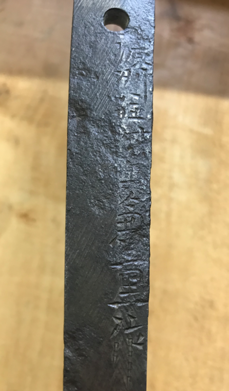

Conway Posted December 1, 2023 Report Posted December 1, 2023 Saw this one on eBay. Hiromitsu 1944 with a Gifu stamp on the mune and on the nakago above the mei + a Seki stamp above the date. @Bruce Pennington Conway Japanese Late WW2 Sword with Many Kanji 1 Quote

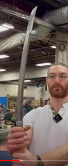

waljamada Posted February 6, 2024 Report Posted February 6, 2024 @Bruce Pennington You're work received a shout out! Check out this video at about the 17 minute mark. 2 1 Quote
Bruce Pennington Posted February 7, 2024 Report Posted February 7, 2024 Ha! Love it! Now I'm almost as famous as Stephen! So, is this George one of our Georges? Quote

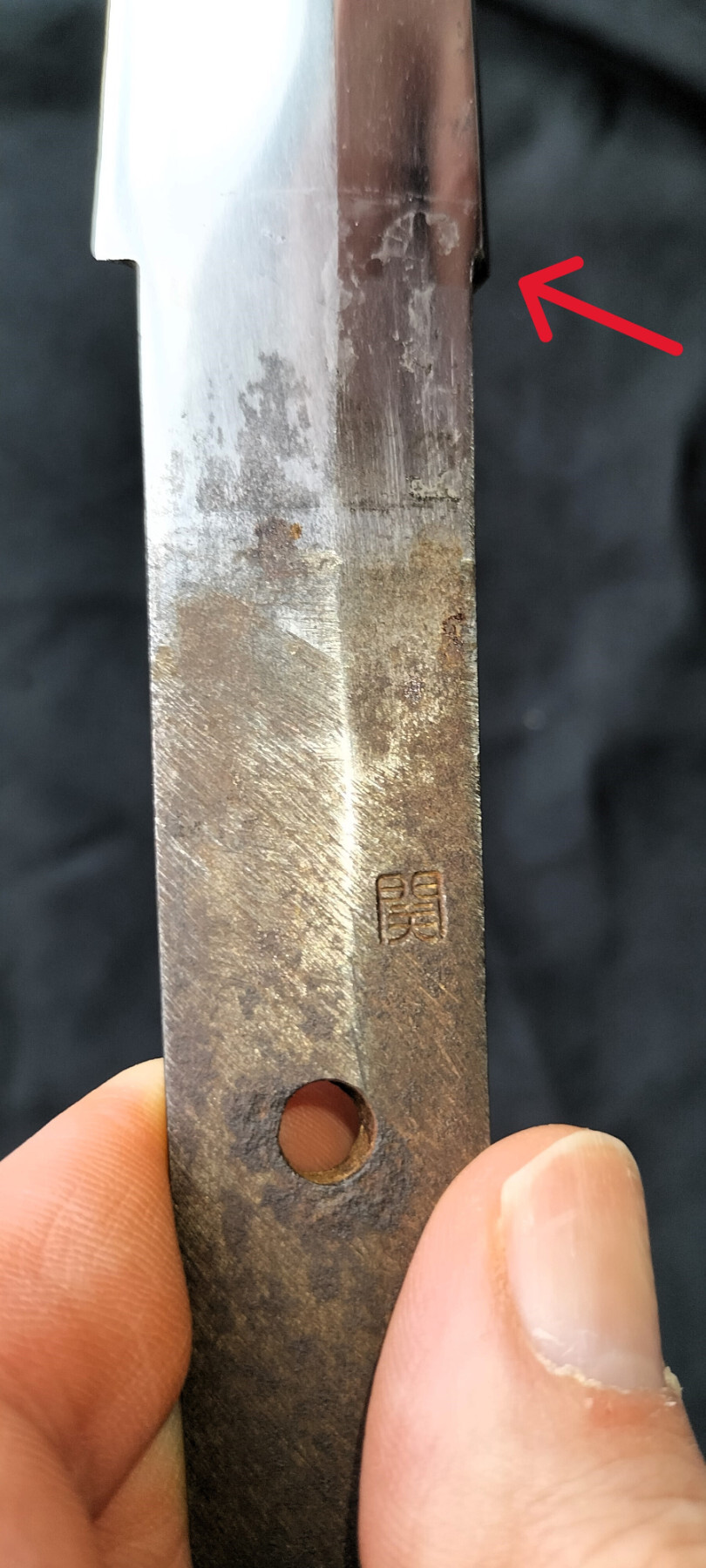

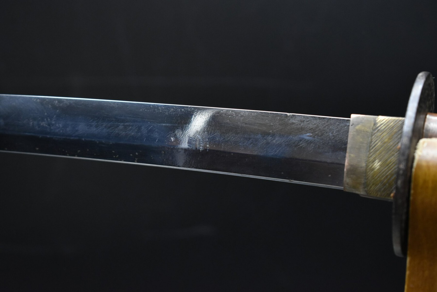

Yukihiro Posted February 7, 2024 Report Posted February 7, 2024 This could be an instance of a double-stamped Seki blade (1941 dated Amahide gunto), but @Bruce Pennington should be able to tell you more about it. Quote
Bruce Pennington Posted February 7, 2024 Report Posted February 7, 2024 Well that's an odd thing to see. I can clearly see one tip of a sakura. I thought at first I could see two, but after setting it beside a known stamp, I'm not sure about the one on the left. The use of the Showa stamp and large Seki overlapped from 1940 - 1942 with the majority overlap being in 1941, which aligns with the date of your blade perfectly. So that supports the idea this was stamped, and then polished out? to add the Seki stamp. Issues - it looks more like a stain, matching the coloration of the rest of the stain below it. And a big one, I had not thought of earlier - it's considerably high on the nakago, to the point of being above the machi on the blade. I would leave it in the "I don't know" category. But I've added it to the file on your blade. 1 Quote
Bruce Pennington Posted February 7, 2024 Report Posted February 7, 2024 15 hours ago, waljamada said: Check out this video at about the 17 minute mark. After comparing his blade to the one I have on file, thanks to @robinalexander, I think they are 2 different swords. George's has a silver habaki and, though not a good photo, the other one appears to be brass. Also the hamon is not the same: They are both in shirasaya, but the sale Rob showed said it was a waki. Hard to say exactly, but I don't think George's is a wak. Quote
