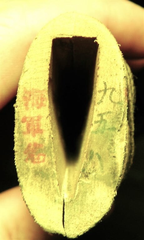

Adding photo and @Nobody's translation
"The red kanji on the tsuka are 海軍省 (Kaigun-sho - the Naval Department)."
More like 海軍卷 (Navy style wrapping)

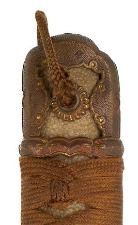

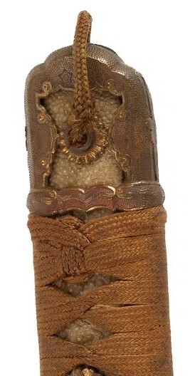

We have this Spring '42 Koa Isshin, RA 1027, on file from a post a few months ago by @Big Dan 146, but it is for sale now, at this Case Antiques Auction.  Thanks to @Ontario_Archaeology for the tip!
Posting because it has Tokyo 1st and Nakano Shoten stamps on the kabutogane.  We see these, now and then, but not often:
xxx.jpg.df34e45e82215a09b42d5b804cf88083.jpgx.jpg.3187e249881ab50a3e2ae60b872d7921.jpg

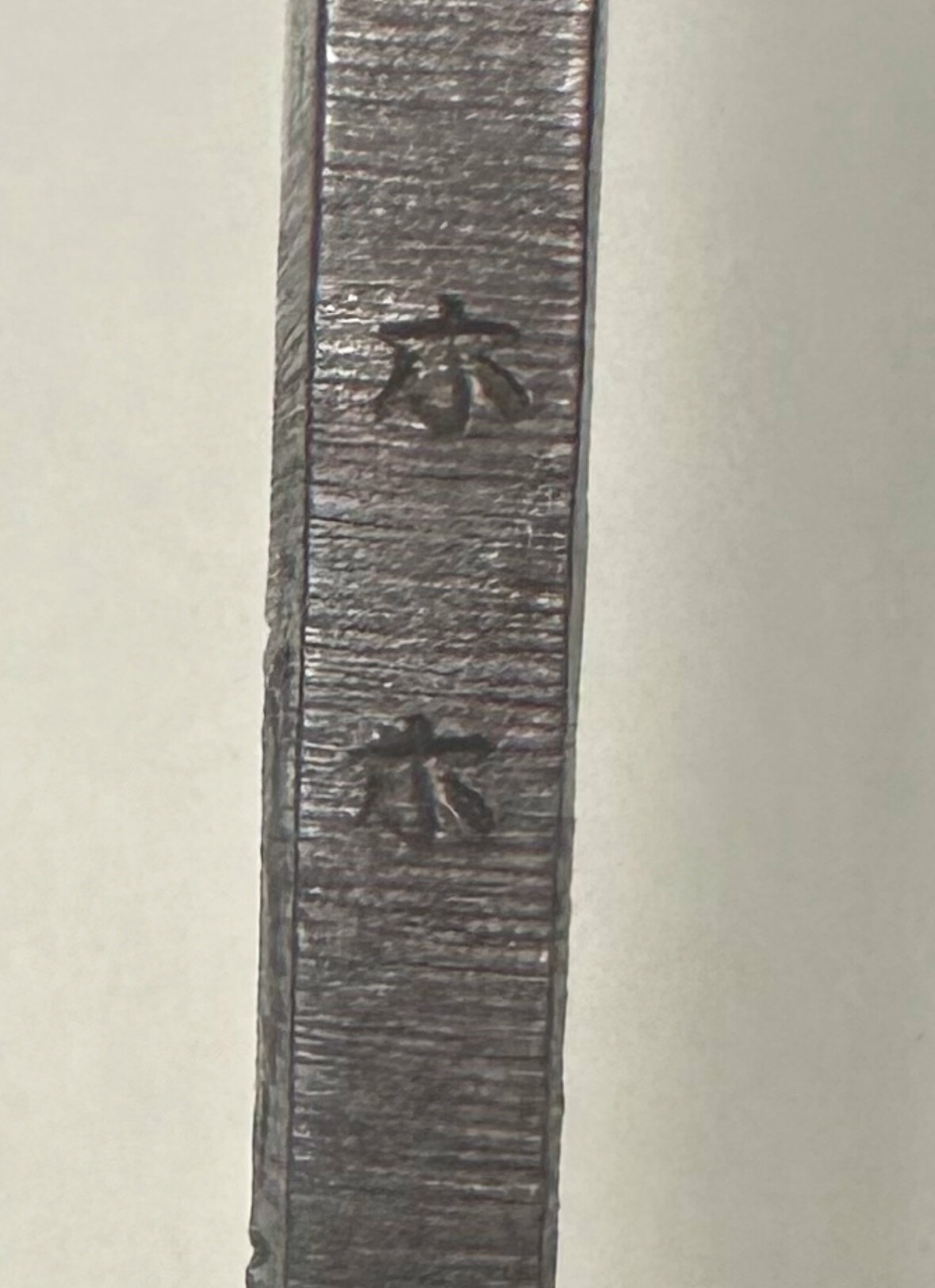

Just to keep the flag here flying, my new (to me) Minamoto Moritaka - who apparently only made gendaito - has the "Ho Ho"🎅🏼stamps below on the nakago mune.
Thanks Dee!  Hadn't logged one in from Moritaka yet.  Like you said on the other thread, Kokura's 1st Factory inspector stamp.  I haven't tracked the double stamping thoroughly, but I do have 12 on file from 1940 - 1944.  Yours is the second earliest in my chart.  Their presence doesn't say anything about the blade being traditional or not as I've seen them on RJT star stamped blades.

8 hours ago, mecox said:
@Bruce Pennington @Kiipu @KungFooey   Moritaka very good smith.  Have examples of work and his students in Fukuoka/Kokura paper in NMB Downloads
Mal
Hi Mal!
I just read the download and it's amazing how much information is there!
I can see lots of combinations of stamps but not my 'ho-ho' so I'm still real confused exactly what that means?
Many thanks!
Dee
PS: I was exhausted when I read your document the first time - now, however, I can see two Moritaka blades with Ho Ho stamps on pages 125 and 127 described as "pre-star" and an explanation on page 32 that these two stamps were used for Kumamoto Tosho between 1941 and early 1942 (which makes sense considering my sword commemorates Japan's declaration of war on the US and UK in December 1941).
However, I'm still not sure what, if any, differences there are between Moritaka's 'patriotic slogan' blades, special orders and RJT basic info signatures.
Thanks again!!!
Dee
Dee, yes its not straightforward, and back more so as they started to move sections of Kokura arsenal from 1943.  But there were "control groups" for the arsenal is different prefectures.  They opened one in Kumamoto (page 29) in Jan 1942, and it could check/accept blades for the arsenal. I understand there are gendaito made of tamahagane which when the RJT scheme was in place (late 1942 and into 43) received star stamp. Before this no star but got "ho" and then was processed within the arsenal system and got 2nd "ho" (I think).  So is yours dated?  (1942 based on this).  Patriot sayings are custom orders or gifts to shrines/special people.
I have 2 1942 Morinobu blades with the "Ho Ho" stamps.
If I recall Mal's theory, the first stamp could have been from the arsenal that took in/accepted the blade, and the second one a final inspector.  I have "Na Ho" blades as early a 1940, though '42, as well as these 3 "Ho Ho" blades.  Using Mal's theory, these 3 were all turned into the Kokura Arsenal (first stamp) and final inspection performed by Kokura.
Prior to 1942 (late '41), Kokura had overall supervision of sword production of both the Nagoya and Tokyo 1st arsenals.  This is why we see their stamps on both officer and NCO blades prior to this date.
