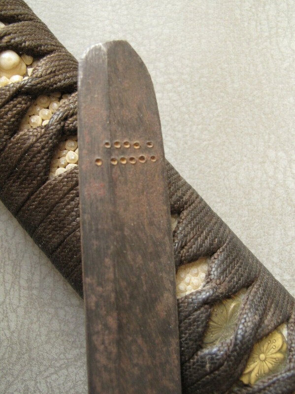

9 minutes ago, shibeni said:
If not relevant, I can delate it, saw Brians comment from 2010 on other rare tsuka markings, so maybe interesting for someone..
Regards,
Bojan
No, quite interesting and relevant.  Humor is a tough thing across cultures and on the internet.  That image is used in bumper stickers and the markings on your tsuka reminded me of it!
I’m glad you posted it.  Maybe someday someone will find a reference.

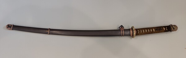

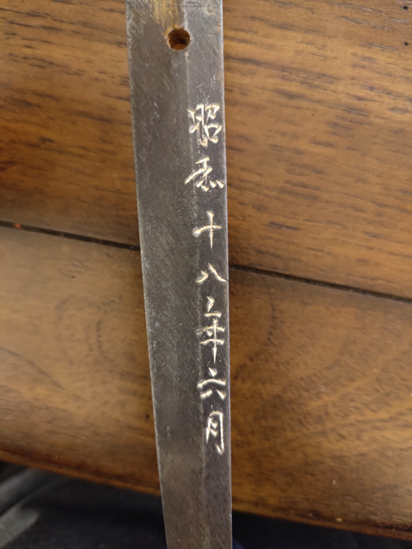

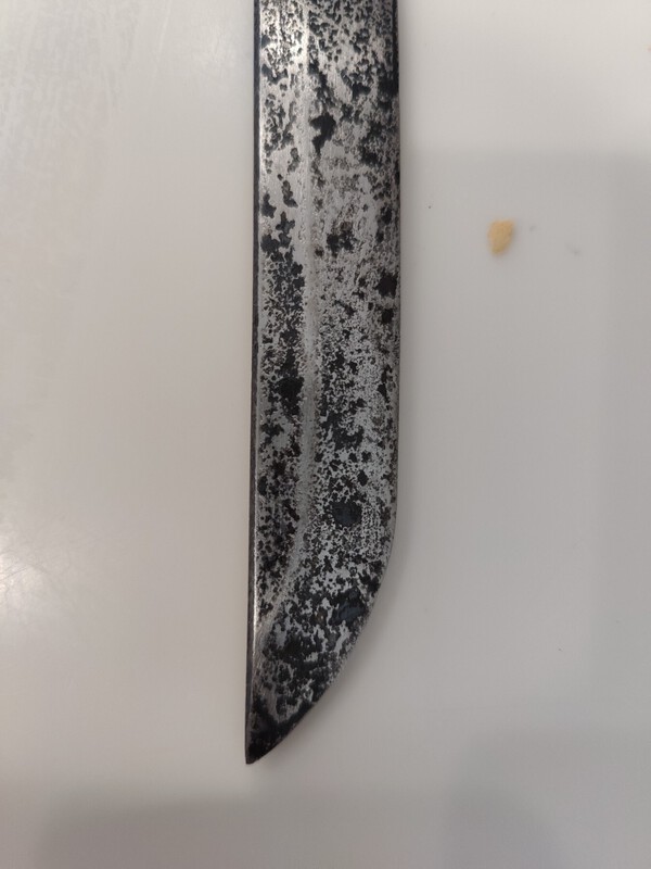

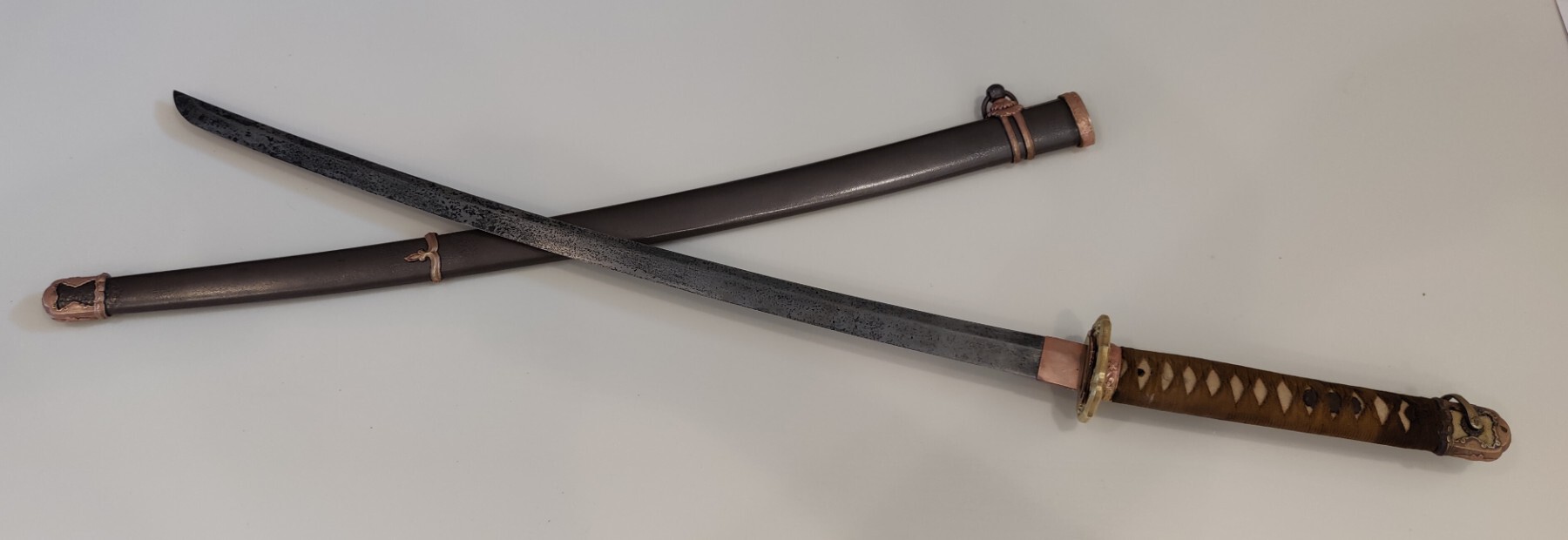

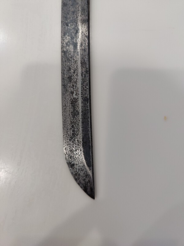

@Brandon_Lane, welcome to NMB! We'll help for a price ...... we'll need to see pics of the full sword, closeups of the hamon (temper line) and blade tip, and some good shots of the fittings!  Ha!  We don't work cheap!
Seriously, (ok I'm serious about the added photos!), the date is May 1943, and someone will help with the smith name.

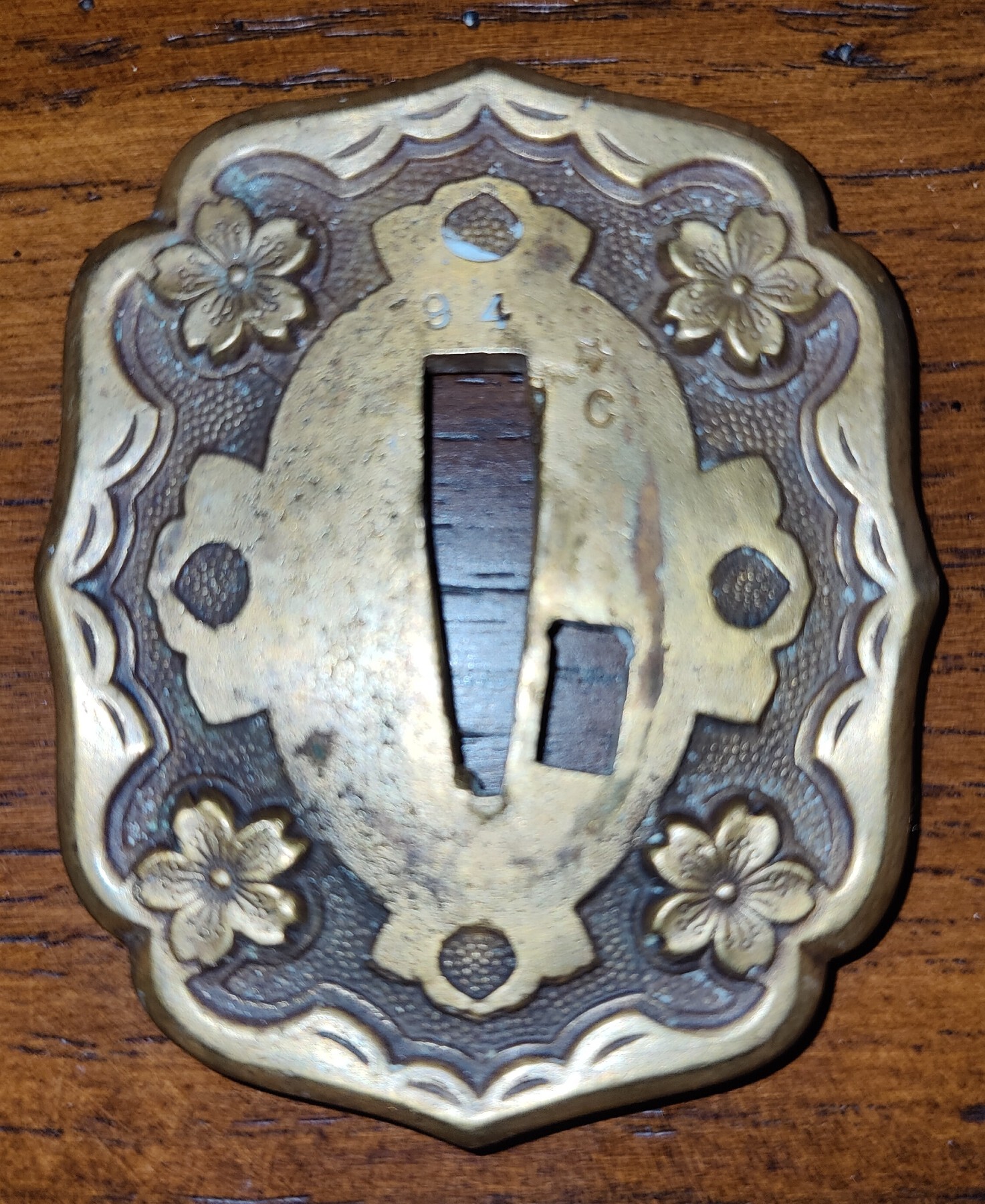

I don't see the "Na" stamp.  Can you give us a clear shot of that?  Also, is that a small star above the smith's name, to the left of the hole?
I appreciate your posting the tsuba (handguard) as it has that small star.  We don't know it's meaning but suspect it's a fittings shop logo.  We have a couple like this on file, but no leads to who used it.
