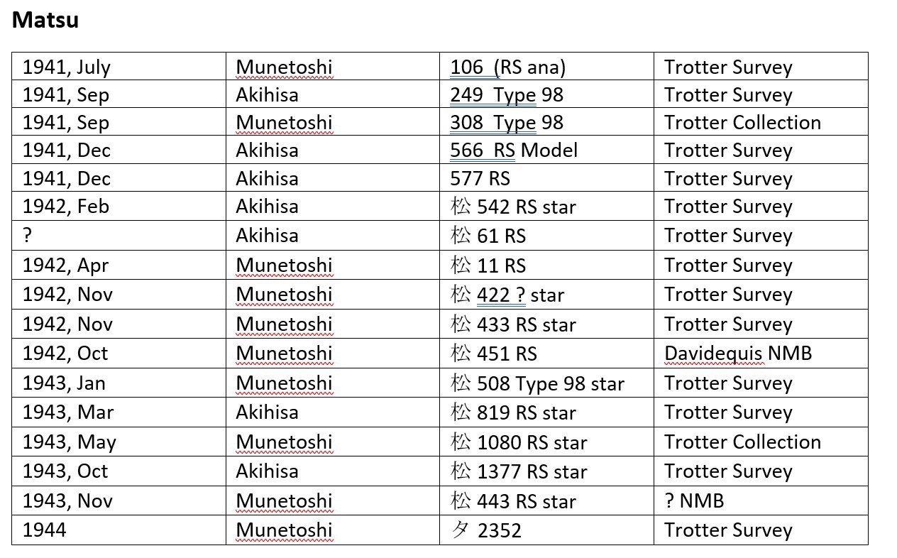

Matsu Stamp update
Thanks to George Trotter, I've completed my survey of blades marked with the circled Matsu (none other form was found).
Munetoshi43Rinji1080Matsu.jpeg.f42c60fdd19fdc55053e8fec9c91209a.jpeg After searching 4 sword forums (haven't done a web-wide search yet), the stamp, so far, is only found on blades made by the Yamagami brothers, Akihisa and Munetoshi.  George said their forge was north of Tokyo - nowhere near Osaka - so it would appear the stamp was unique to the two smiths, and not associated with the Osaka Supervisory unit of the Kokura Arsenal.
matsu
小倉陸軍造兵廠大阪監督班
Ōsaka Supervisory Unit of Kokura Army Arsenal
Considering that all observed inspector marks are the bare mark without circles or sukura (Showa stamp is the exception, but it wasn't tied to an arsenal, so it doesn't really apply to this issue), it supports the idea that the circled matsu is not an inspector mark at all, but something used by the Yamagami brothers in their serial numbering system (also supported by the fact that they moved to kana in 1944).  Marks inside circles, stars, sakura, etc, tend to be shop logo or unique to sword shops.  The only exception that I can think of is the Toyokawa anchor in sukura on seppa (which might actually indicate the seppa were made by a shop exclusive to the Toyokawa arsenal).
I still can't shake off the coincidence of their stamp appearing in 1942, when the Army took control over nation-wide blade production, and the corresponding change in 1944 to stamps that reflected the locales/provinces where the blades were made.  As RJT smiths, maybe their stamps were created to meet Army regulations.
If anyone has further data that would add or change this issue, please let me know!

Analysing the data.
Date of manufacture and numbers are not sequential.
Possible reasons
Option 1
Dates reflect the time of production and numbers are part of a larger allocation pool of area/region supply.
I think this option is unlikely. The theory is disrupted by the nov 1943, #443, that sequentially belongs to the oct/nov 1942 numberset.
This theory is further disrupted by the oct/nov 1942 numberset being out of sequence (oct 451, nov 422 & 433)
Option 2
The numbers do relate exclusively to the brother’s production sequence, however the dates reflect when the sword actually left the business, rather than the date of production.
This would explain how number 443 can leave the shop a year later than numbers 422, 433 & 451. It also explains why 451 leaves the shop before 422 & 433.
It would also make sense that any smithy would have a stock of swords for customers to choose from. Customers (private or government) would not pick based on number sequence but on aesthetics, materials and price.
Similarly, Smith’s would price on aesthetics, method of manufacture (traditional/non-traditional) and materials (tamahagane/mill steel) not number sequence.
This theory is supported by the total production numbers as a reflection of output.
The 1944 #2352 suggests wartime production 1939-1944 of 2352 swords at a production rate of 32/month from both brothers, or 16 each, which (i read somewhere) was the maximum traditional output.
Sooo why the Matsu stamp?
If they did make 2352 swords from 1939-1944, there are 17 known examples making 0.7% survivors from their body of ww2 production.
Looking at the matsu stamp there are 12 examples of which 8 have star (66%) verified by the government as traditional. The verdict on #451 without star is that it is traditional. I assume #11, #61 & #2352 are also traditional.
The brother’s were traditionally trained and won awards - they made quality swords.
It would make sense that at time of manufacture, when the brothers signed and numbered the tang they would also indicate its quality of manufacture and materials (the matsu).
In a market flooded with military swords all with numbers, various government stamps and  of varying quality, the brother’s wanting to clearly identify their brand would be logical.
Why some matsu without star?
The star is a government quality certification for government purchased blades. The matsu is the brother’s certification for quality blades. Thus, matsu without star is not government purchased.
Welllll at least, that is my theory:)
At least we got some gears turning!  The more heads that we can get together on this, the more likely we'll come up with some useful information.  Glad to see you working it David!
On the sequencing - the numbers fall in line better if you look at the 2 smiths separately, and also assume the numbers started over each year - not perfect, but better.
The 4-digit numbers are interesting in that they parallel the 4-digit numbers of the Mantetsu line.  There is an odd-ball in 1940, but the 1XXX numbers show up in 1942 and 1943, with the 2XXX numbers appearing in 1944.  I don't know if this explains it, but Nick Komiya, Warrelics, revealed an order from the Army to randomize serial numbers to obscure production capacities from Allied Intel.  I'm not sure this was actually carried out by any factory, but it could explain the parallel jump to the higher numbers.
Your thought about bunched/stored blades getting out of sequence has some merit.  Army inspectors would travel around to the forges (and there were many!) monthly, bundling up blades and shipping them to Tokyo arsenal warehouses for distribution.  The only glitch to this explanation would be that it would require that the date inscriptions would have to be applied by the Tokyo operation as the blades went to market for the numbers to be out of sequence, and I'm not sure it was done that way.
Interesting stuff, eh!

Thanks David!  That 2353 is pretty cool!  I doubt it is the 2352 of the Trotter survey, the numbers are easy to see.  Also, number stamping on the war blades is quite varied, with numbers not aligned and differing sized numbers/letters commonplace.  As I searched for your 443 reference I found a couple more that I didn't have!
Here's the updated table:
Matsu
1941, July
Munetoshi
106  (RS ana)
Trotter Survey
1941, Sep
Akihisa
249  Type 98
Trotter Survey
1941, Sep
Munetoshi
308  Type 98
Trotter Collection
1941, Dec
Akihisa
566  RS Model
Trotter Survey
1941, Dec
Akihisa
577 RS
Trotter Survey
Akihisa
61 RS
Trotter Survey
Akihisa
97
NMB
1942, Feb
Akihisa
542 RS star
Trotter Survey
1942, Apr
Munetoshi
11 RS
Trotter Survey
1942, Nov
Munetoshi
422 ? star
Trotter Survey
1942, Nov
Munetoshi
433 RS star
Trotter Survey
1942, Oct
Munetoshi
451 RS
Davidequis NMB
1943, Jan
Munetoshi
508 Type 98 star
Trotter Survey
1943, Mar
Akihisa
618 RS star
Vajo NMB
1943, Mar
Akihisa
819 RS star
Trotter Survey
1943, May
Munetoshi
1080 RS star
Trotter Collection
1943, May
Munetoshi
1082 RS star
baldi1942 NMB
1943, Oct
Akihisa
1377 RS star
Trotter Survey
1943, Nov
Munetoshi
443 RS star
? NMB
1944
Munetoshi
2352
Trotter Survey
1944, Feb
Munetoshi
2353 Type 98 star
For sale on web

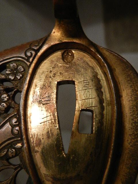

Came across this unknown shop stamp during a conversation with a guy about a gunto.  I don't think I've ever seen it before.  "S" on one side of the kabutogane, and "T" on the other; then "S  T" on both sides of the habaki.  The seller didn't post pics of the nakago, but said in the description that there is a Toyokawa blade in the fittings.  I suspect the shop did a top-dollar custom job on the fittings by the look of that seppa, cut to fit around the sakura on the tsuba.
If anyone has any info on this shop, I'd love to hear about it.  Likewise if anyone has similar fittings from this shop, please post.
I was going to post this on an old thread about fittings with stamps on the kabutogane, but I can't find it.
pix084004298.jpg.b8e0447f5b89e426f6d8d68654d3ac4f.jpgpix931884431.jpg.17ec5c7123e48c77c57fbfad120b84fe.jpg
pix392148303.thumb.jpg.a99925bb6317045ab3c67387535b52f3.jpgpix430600789.thumb.jpg.0ce20bcbacfe0a3b9ff7c67c02be05ae.jpg
pix691262030.thumb.jpg.a3388d9b5f5b7f82e75159de5bca13f4.jpgpix545346637.thumb.jpg.5836da5669d96dddc46d3bc350a89d8b.jpg

There is a Kanezane blade being discussed HERE that has Kanezane's kao, but it also has a Seki stamp.
I had been assuming that the presence of a kao (hot stamp or an inscribed mark) would indicate the blade was made traditionally, because blades can be found by that same smith that don't have the kao.  But this blade has a Seki stamp which means it was not.  Hmmmm.   Of course, this hearkens back to the debate about stamps - are they always an indication of a non-traditionally made blade, or could they sometimes simply be an acceptance stamp.
The answer could lie in the reality that some blades with a smith's mei were really made by apprentices, so maybe the kao would indicate that this blade was made by the smith?  Another issue is that many WWII blades were signed by a professional mei-cutter (there's a word for that).  Maybe the presence of the kao, simply means the mei was cut by the smith himself?
What we know for a fact is that the government ordered all non-traditionally made blades to be stamped.  We do not have proof that stamps were being used in other ways, so with the assumption that the Seki stamp on the blade means that it was non-traditionally made, then the kao's significance lies somewhere else, like who made it or signed it.
