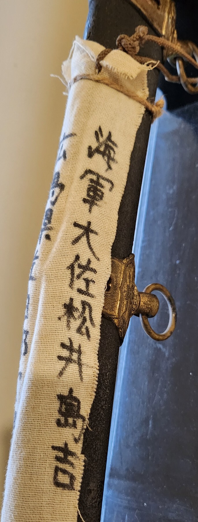

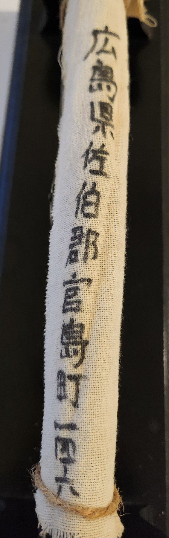

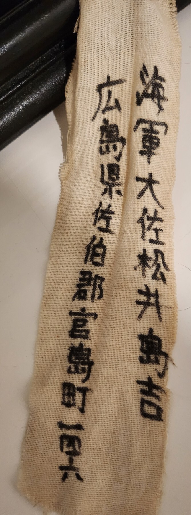

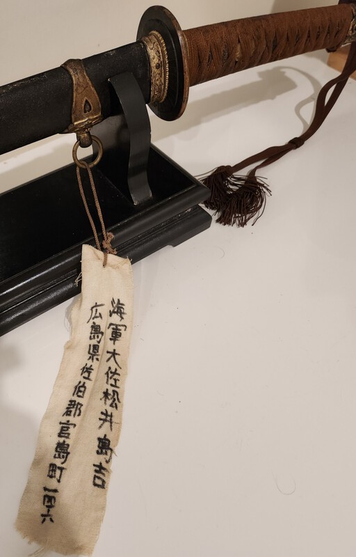

Hi there, i have a new purchased 20260524_155609.thumb.jpg.61481b5e6087a18654eaaa69dfd96317.jpg20260524_155609.thumb.jpg.61481b5e6087a18654eaaa69dfd96317.jpg20260524_155609.thumb.jpg.61481b5e6087a18654eaaa69dfd96317.jpg20260524_155609.thumb.jpg.61481b5e6087a18654eaaa69dfd96317.jpgnavy sword to my collection. There is a surrender tag on the saya. When i bought this sword the translation was : Colonel Matsui Shimakichi, 146 Miyajima, Saeki - gun Hiroshima. However after research i can not find this exact officer. It comes back as a possible mistranslation.  Any help would be greatly appreciated. Thank You in advance.

Hi Andy,
I think the translation that you have for the tag is accurate:
島県 – Hiroshima Ken - Hiroshima Prefecture
佐伯郡 - Saeki Gun - Saeki district
官島町 – Miyajima Machi - Miyajima town
一四六 – 146
海軍大佐 – Kaigun Daisa (Navy Colonel)
– Matsui Shimakichi (Given name)
I don't know anything about Japanese Navy ranks, however, when I put "Daisa" into the online dictionary that I use, the definition comes back as "colonel; (navy) captain" so it might just be a semantic thing. https://jisho.org/search/daisa
That said, how convinced are you that the surrender tag is genuine? It looks practically pristine and the ink is so black it could have been written yesterday...

Hi Andrew,
The Kai Gunto looks good from the little that's shown.
Sword aside, I am no expert re translation or surrender tags for that matter.... I have only one but i have seen many. I also know what I would believe and buy and this 'surrender tag' is not it.
To be honest I would be making observations and asking lots of questions of the seller. IMO this tag is just not >80 years old.
The age of the material (Calico?) is so wrong as is the new twine and fresh texta kanji.
Maybe it's a copy of the original that fell apart or was lost? But, considering the above and with the anomaly of the rank IJN vs IJA, I would question both the authenticity of the 'tag' and any supposed relationship with the sword.
For me, what ever is written on the tag is academic.
Don't mean to be negative ....just my opinion.
All the best.
Rob

The tag looks very new indeed, do you have any history of how it came to Australia? I couldn't find a record of a Matsui Shimakichi in the list of Etajima graduates, it is possible he was a graduate of the IJN aviation academy or a civilian employee working for the Navy.
It would help to know where the sword was surrendered to narrow down the possibilities.
  • Love 1
Hi there, it was a ebay purchase from showa22. I know His descriptions can be off. Ive bought a few swords off Him several times before over the years. Never had an issue with authenticity. Just not accurate condition description. The seller is from America. The cotton does have a large crease down the middle. Its a bit of a mystery, if it was not a genuine surrender tag, id rather take it off as the sword itself and fittings are right. But at the same time i dont want to throw it away incase its genuine or like mentioned re written.
I just spoke to the seller showa22. They said it is definately an genuine surrender tag.. the blade is actually a traditionally made blade by kunimitsu.
I have to agree with the above assessments on the tag. My initial thoughts were that it looks too new. The ink looks like it was from a Sharpie rather than brushed. Can you tell  up close? I guess it could be original IF it is brushed/ink pen AND were kept in a sealed box for the last 80 years. Not even a speck of dust on the cloth. But I would question it.
John C.
The tag looks questionable to me.
The town’s name Miyajima-cho (宮島町) was used after 1950. If the tag was written just after the end of WWII (1945), the town’s name should be Itsukushima-cho (厳島町).
At the time, Hiroshima-ken was most likely written as 廣島縣.
There are three kanji on the tag. They are all wrong characters.
looks strange. It looks like
  • Like 8
  • Love 1
Hi guys, sorry for the late response. I do believe it to be a genuine surrender tag. It was folded in half obviously for a long time, i used new cotton string to hold it in place on the saya.. but these photos are how i got it originally. The writting looks fresh because it was folded so only the back got stained. The seller i bought it off is certain its a genuine surrender tag. I do too as the tag shows age appropriate wear. I will be doing further research on this. Thank You to everyone for Your help.
Andrew:
Please re-read Moriyama-san's response. The kanji used to identify the town and city names were not used during WW2. When translating WW2 artifacts, it's important to know that the entire kanji system was revised in 1946. 385 kanji were redesigned (mostly simplified), the base requirements of kanji that one needed to learn changed, and the types of kanji used in Names was established. This was actually a law.
So when Moriyama-san says that incorrect kanji were used, it's important. It means the tag could not have been written prior to 1946 (after the war). And indeed, one of the town names did not change until 1950. So while the tag may be "old" it is most likely NOT from WW2.
Just food for thought.
John C.
I don't recall all that he said, but as to the date of the tag, there were some swords handed over and presented to soldiers sometime after the war.  Just an option.
