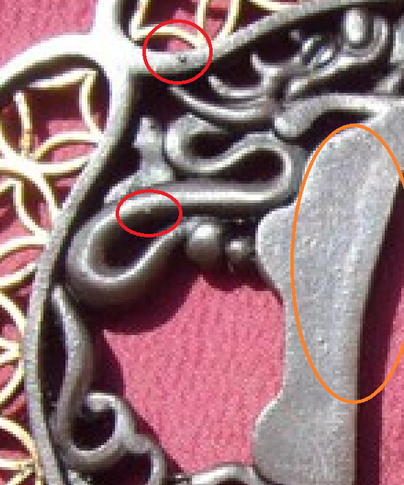

buchtas Posted September 17, 2025 Report Posted September 17, 2025 Hi, everyone, I was browsing my go to auction site for some bits n pieces unrelated to nihonto and stumbled upon a seller who is offering mostly WW2 Japanese military stuff, in description he states that items are either imorted form Japan or from his personal collection, but whatever. What I found is quite nice tsuba, seller states in the description that it is 20th century, fair enough could be. I just wanted some opinions of the amazing people here what do you think? Does it look authentic? Is it really Meiji era tsuba or otherwise? I mean it looks really nice so even if it was contemporary i would probably get it. It is priced around 40 Euros. Any opinion is welcome. Best regards, Martin 1 Quote
Brian Posted September 17, 2025 Report Posted September 17, 2025 I'm betting that is pretty modern. 3 1 Quote
Dan tsuba Posted September 17, 2025 Report Posted September 17, 2025 Hi Martin, My opinion is that the tsuba looks modern and fairly recently made to me. But hey, if you like it that is all that matters! 40 euros is a fair price for a modern tsuba (again, my opinion!). Onward! 1 Quote
buchtas Posted September 17, 2025 Author Report Posted September 17, 2025 1 hour ago, Brian said: I'm betting that is pretty modern. Just now, Dan tsuba said: Hi Martin, My opinion is that the tsuba looks modern and fairly recently made to me. But hey, if you like it that is all that matters! 40 euros is a fair price for a modern tsuba (again, my opinion!). Onward! Yeah, that is what i thought, mainly because of how the material was worked, filed down, etc..., I can see that but was not sure if this is modern modern or something from last century. You learn something new every day Thanks But i assume that this is probably something better than averge cast replicas of today. 1 Quote
Dan tsuba Posted September 17, 2025 Report Posted September 17, 2025 Martin, I like the tsuba! It is well done and maybe it is not cast, but machine cut. It is nicely painted and shows great detail (my opinion). I don't know! Maybe it was made in the last century? But it doesn't appear to have been mounted on a blade. But if you like it, that is the important thing! Onward! 1 Quote
ROKUJURO Posted September 17, 2025 Report Posted September 17, 2025 Martin, looks like 21st century, and not made in Japan. Compare with real TSUBA! 1 1 Quote

Curran Posted September 18, 2025 Report Posted September 18, 2025 "seller states in the description that it is 20th century" That is probably accurate. Personally, I doubt it is pre WWII. 4 Quote
Spartancrest Posted September 18, 2025 Report Posted September 18, 2025 Machine made, there are a few spots [literally] where the laser has dropped spots of metal on the design. Nakago-ana is a little "off" and the seppa-dai is slightly depressed. Not Meiji in my opinion and fairly recent. Still, could you make it yourself for 40 euro? 4 1 Quote

Guest When Necessary Posted September 18, 2025 Report Posted September 18, 2025 It has a linear surface texture, similar to that found on items which have been laser printed. Also, there is distinct flash around the fine 'carving'. Quote
Shugyosha Posted September 18, 2025 Report Posted September 18, 2025 @Spartancrest and @When Necessary Good eyes! 2 Quote
