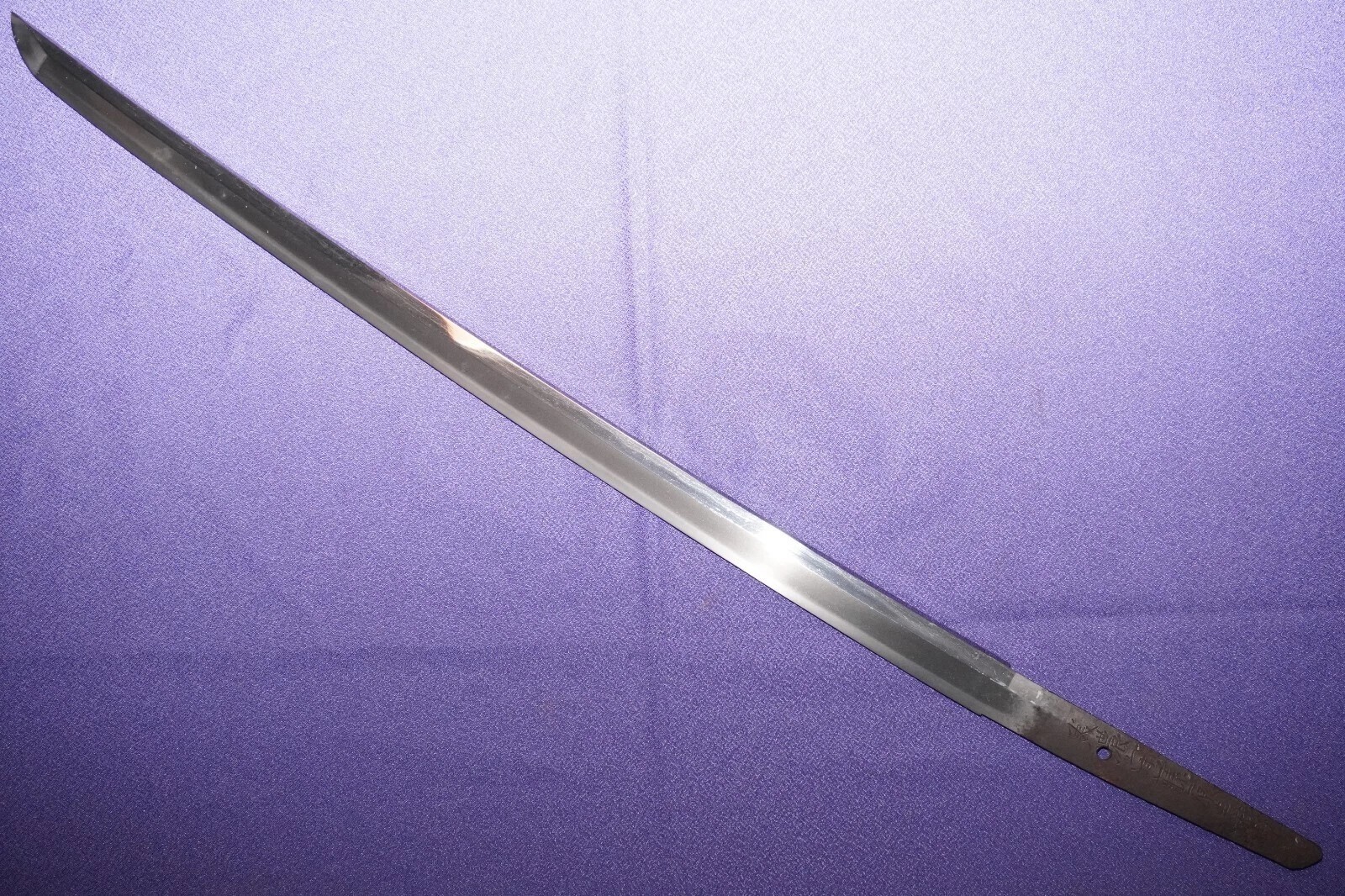

klee Posted June 13, 2025 Report Posted June 13, 2025 Good evening Bought this off of an ebay auction as just a display piece and not really part of my actual collection since im certain it s super gimei ( Mino No Kami Fujiwara Jumyo ) But I am curious to know what time period it might be from. It kind of looked shinshinto to me but im sure other here are far better at at making educated guesses. I liked the blade for what it was and for a couple hundred dollars I did not mind it at all. Thank you in advance -Kevin L Quote
PNSSHOGUN Posted June 14, 2025 Report Posted June 14, 2025 Little Sori was popular during Kanbun Shinto, and later Shin Shinto. 5 Quote
YourBabyBjornBorg Posted June 14, 2025 Report Posted June 14, 2025 Hi! Can we have a look at the signature? This could be a genuine Shinshinto Jumyo. Sugata looks Kanbun, but Kitae is Shinshinto-like, so it would help if we had specific data on this sword, if this is notably long, broad and thick, then it is more likely a Shinshinto. 1 Quote

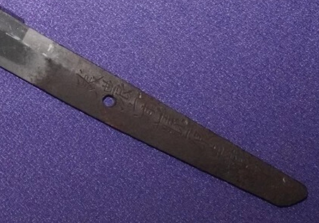

klee Posted June 14, 2025 Author Report Posted June 14, 2025 59 minutes ago, YourBabyBjornBorg said: Hi! Can we have a look at the signature? This could be a genuine Shinshinto Jumyo. Sugata looks Kanbun, but Kitae is Shinshinto-like, so it would help if we had specific data on this sword, if this is notably long, broad and thick, then it is more likely a Shinshinto. Hello ! Thank you for the insight. Yes here is the mei/nakago close up. I am not very familiar with Jumyo but it seems the only Jumyo who signed like this was Kanbun Jumyo. I did compare the mei and it looked quite different than the nbthk authenticated ones from Kanbun. It is also a long wakizashi ( 54cm ). The nakago patina also seemed a bit strange to me. Quote
YourBabyBjornBorg Posted June 14, 2025 Report Posted June 14, 2025 Edited: Oh! I'm sorry, but this does look like a Gimei. Looking at the Nakago, this could be Shinshinto or even Showa IMHO. Yes! I did not know people would do this, but just like what Rivkin san said, the Nakago is cleaned. So no Showa, but Shinto (or Shinshinto). 1 Quote
klee Posted June 14, 2025 Author Report Posted June 14, 2025 3 minutes ago, YourBabyBjornBorg said: Oh! I'm sorry, but this does look like a Gimei. Looking at the Nakago, this could be Shinshinto or even Showa IMHO. Lol no worries. I was very certain this was gimei when I bought it. It was just a pretty blade for $300 so I figued id enjoy it as it is 😊 1 Quote
Rivkin Posted June 14, 2025 Report Posted June 14, 2025 Nakago was cleaned recently, i.e. the rust inside characters is actually quite old. I am 80% for the signature being authentic. Probably 1670-1730, might be a lesser known generation in 1700s, it is often the case as sword market collapsed completely 1705-1710. Not a typical style for the school, but one of Edo period's attempts at something Rai-ish. 4 1 Quote

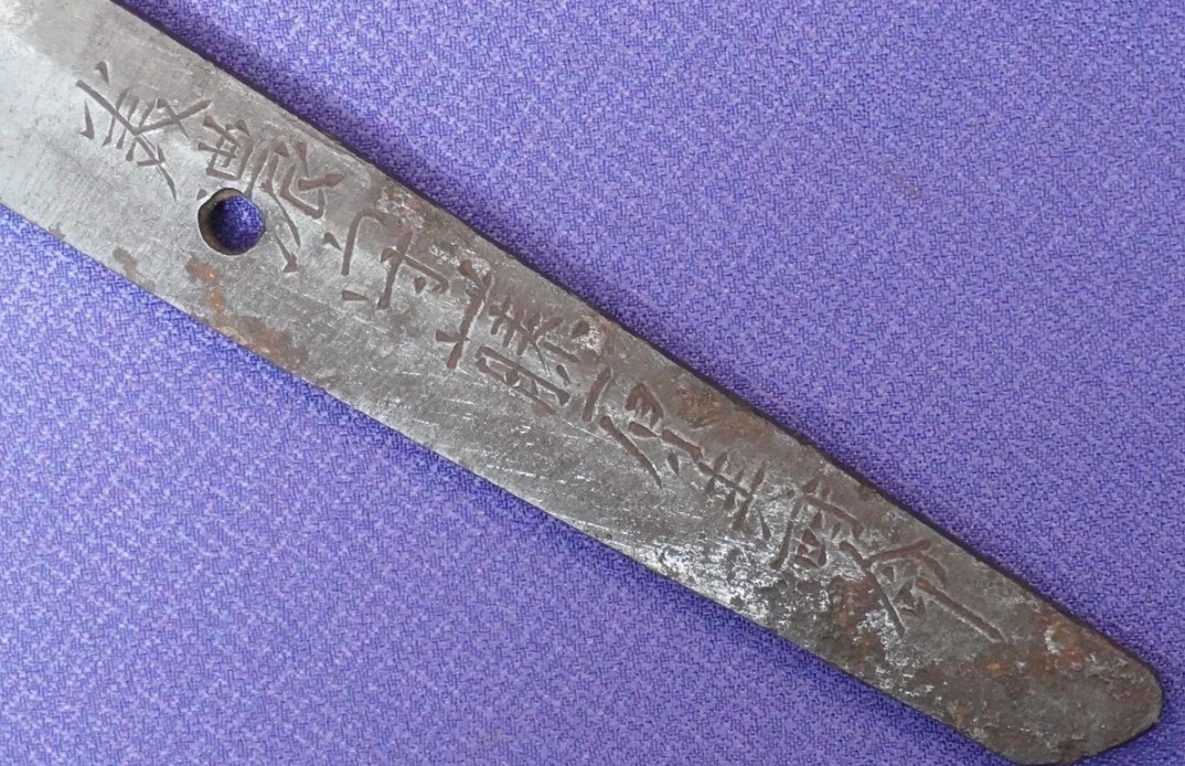

klee Posted June 24, 2025 Author Report Posted June 24, 2025 Blade arrived today and im pretty appaled at how nice this turned out to be. I guess the auction photos were in pretty rough lighting. And the nakago does not look like it s been cleaned. No idea how it was made to look like that on the ebay pic. In beautiful polish as well. 100% not what I thought I was getting from a cheap auction 6 2 Quote

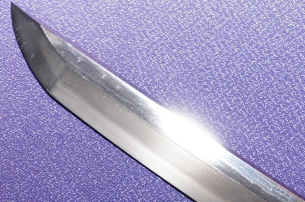

klee Posted June 25, 2025 Author Report Posted June 25, 2025 3 hours ago, Rawa said: Could you post boshi picture? Yes here is the boshi Quote

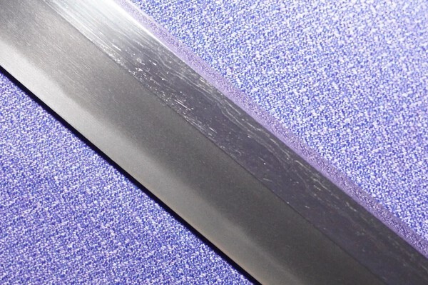

Alex A Posted July 14, 2025 Report Posted July 14, 2025 Its Shinto, note the masame in the shinogi-ji and have others have mentioned, has Kanbun sugata. Looks a decent sword. Quote

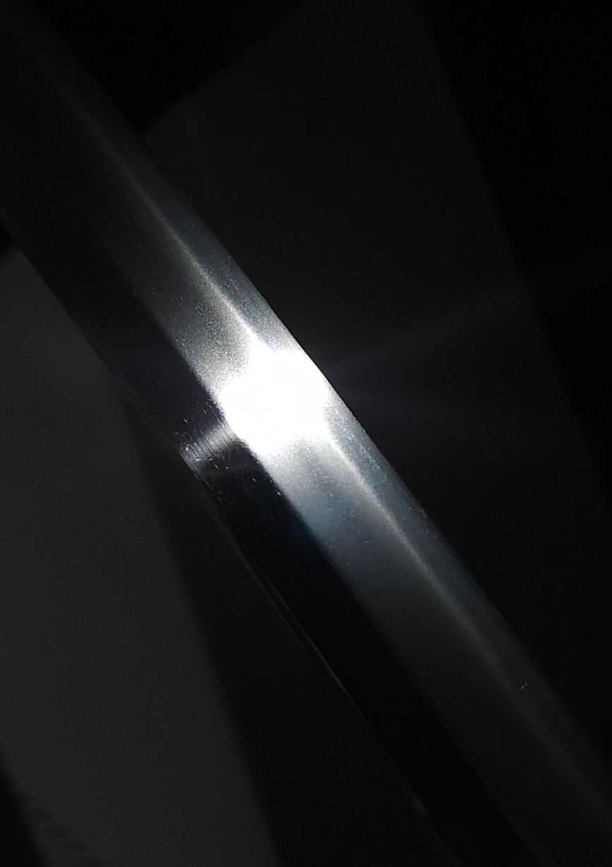

klee Posted July 14, 2025 Author Report Posted July 14, 2025 Yes the measurements are Nagasa 53.7 cm. Sori 0.6 cm. Motohaba 2.5 cm. Motogasane 0.7 cm. Sakihaba 1.8 cm. Sakigasane 0.5 cm. It s not a particularly wide blade but it is extremely thick and heavy. Very tight itame and while the nioiguchi is very bright, there is scarce activity Quote
