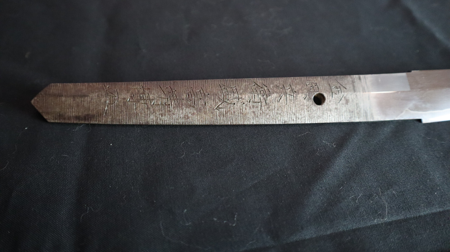

Hi guys,
i'm sorry for the terrible photos but I've seen similar inscriptions on another thread (very anti American and British slogan) and wondered if this was the real deal?
Thanks as always!
Dee
Hi Dee,
Yes I think it expresses some of those kind of sentiments but one of the better linguists will have to tell you exactly what it says. In the first picture there's a reference to the Empire, something I can't make out and then "no bones": 無骨 - the swordsmith's name follows that. On the other side, something about (my paraphrasing) the Imperial declaration of war against the USA and England and a wish for good luck - perhaps wishing the owner of the sword good luck in the war against the allies.
I have a Moritaka with a similar slogan. It's signed "Koteki Mu Kotsu  Minamoto Moritaka + Kao"
According to the seller: "Muteki Kotsu = patriotic saying & meaning "our enemy has no backbone""
image.thumb.png.0ea66d1ff8240e883c8c0112130afd80.pngimage.thumb.png.771216a062f6370bcd01aedec7893bc0.png
皇敵無骨 = Kōteki Bukotsu    Enemies of the Emperor/Empire are savages. (Well, the meaning of "bukotsu" is "unrefined", but somehow that doesn't quite work as a slogan when translated back into English, although you can find a lot of web sites that use this as a translation). Even the word "savage" or "brute" doesn't feel particularly impactful to our ears, but perhaps in 1940s Japan this was a profound insult.
The other bit on Dee's sword looks like
対米英宣戦之告被作 Made upon the declaration of war against the US and Britain.

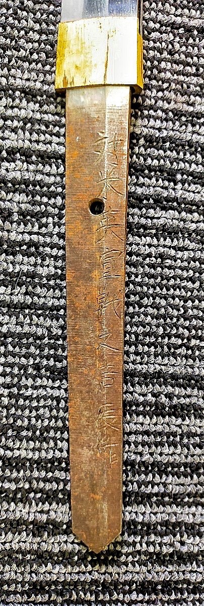

6 hours ago, KungFooey said:
the translation is exactly as @SteveM said
I was one character off. According to the registration card, the inscription is 対米英宣戦之吉作 (made on the auspicious day of the declaration of war against America and Britain).
Wow! So made on December 7th, 1941?
Thank you yet again, Steve!!!
Dee
Well, I think its more of a spiritual marker than an actual temporal marker, but yes sometime around that date (note that Japan is one day ahead, so Pearl Harbor happens on the 8th for them).

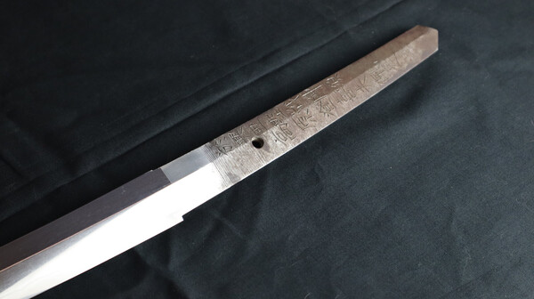

1 hour ago, PNSSHOGUN said:
Very nice, Chris. Do you have the owners name translated?
Tokio Takahara is the owner's name I believe. I haven't been able to find any information on him yet, so I believe I'll need to reach out to the Japanese Consulate in Chicago.
1 hour ago, KungFooey said:
That's a fine sword @ChrisW!!!
What is the patriotic slogan - declaration of war, invasion of Singapore or other?
Thank you!
Dee
Something to the effect of "For the frontline of the Asian holy war of Unification" I believe.
