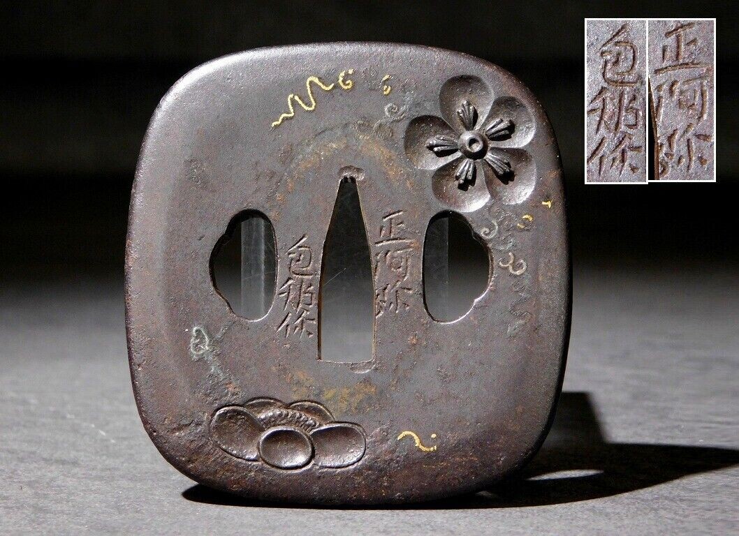

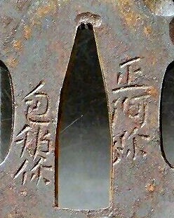

kissakai Posted May 23, 2023 Report Posted May 23, 2023 Hi I can see this is Shoami but can't find the maker I'm sure I've seen the 1st kanji but can't find where. It looks like 垉 Last kanji 作 but even that doesn't look right Quote
ROKUJURO Posted May 23, 2023 Report Posted May 23, 2023 Grev, first name KANJI looks like KANE to me. (KANETSUNE?) Quote
kissakai Posted May 23, 2023 Author Report Posted May 23, 2023 (edited) Hi Jean I'm sure you are right with Kane 包 but can't find a suitable kanji for tsune unless you think it may be this one 佐 Edited May 23, 2023 by kissakai kanji added Quote
ROKUJURO Posted May 23, 2023 Report Posted May 23, 2023 Sorry, I was on the wrong track when I thought of this KANJI: 恒 Quote
kissakai Posted May 23, 2023 Author Report Posted May 23, 2023 No problem Jean and it did give me a start In the Haynes Index there is only one 'Kane' using that kanji but this was not the correct maker Quote

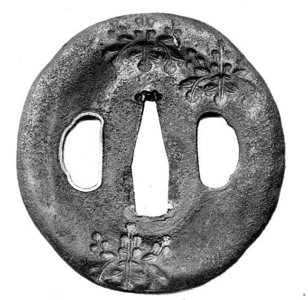

kissakai Posted May 24, 2023 Author Report Posted May 24, 2023 A bit more info Japanese SWORD-MOUNTS IN THE COLLECTIONS OF FIELD MUSEUM BY Helen C. Gunsaulus There is in this collection an iron tsuba on whose entire surface tendrils and blossoms of the kiri (Paulownia imperalis) are carved. It is signed "Shoami Kanenori," an artist hitherto unlisted in the records. The kiri design very often appears on Shoami tsuba. In Sesko’s book of mei he lists a Kanenori as late Edo Mutsu Aizu Shoami I would be nice if anyone can find the one referenced in the Gunsaulus book The tsuba: 2 Quote

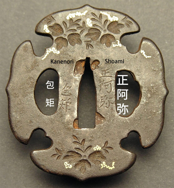

SteveM Posted May 24, 2023 Report Posted May 24, 2023 There are two Kanenori (包矩) listed in Wakayama. Both are from Aizu. One is listed as coming from the Shōami school. The other has no affiliation. Both are late Edo. Wakayama speculates that they are both one and the same person. Quote
kissakai Posted May 24, 2023 Author Report Posted May 24, 2023 Thanks Steve Putting flesh on the bones Also in the Kinko Meikan Quote

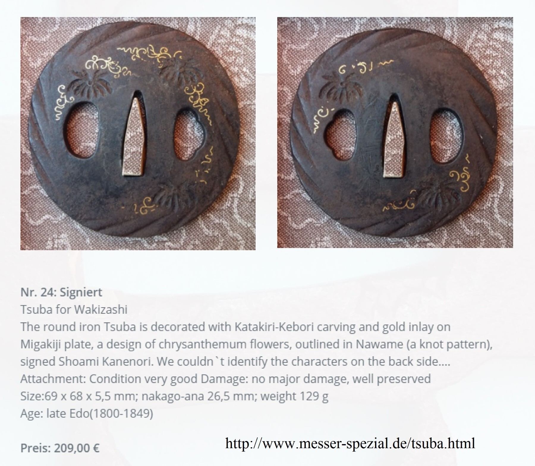

Spartancrest Posted May 25, 2023 Report Posted May 25, 2023 A cobbled together 'Daisho' both signed Shoami Kanenori from my collection. A post from way back in 2012 shows this one with the same kanji: https://www.militaria.co.za/nmb/topic/10570-tsuba-translation/ Quote

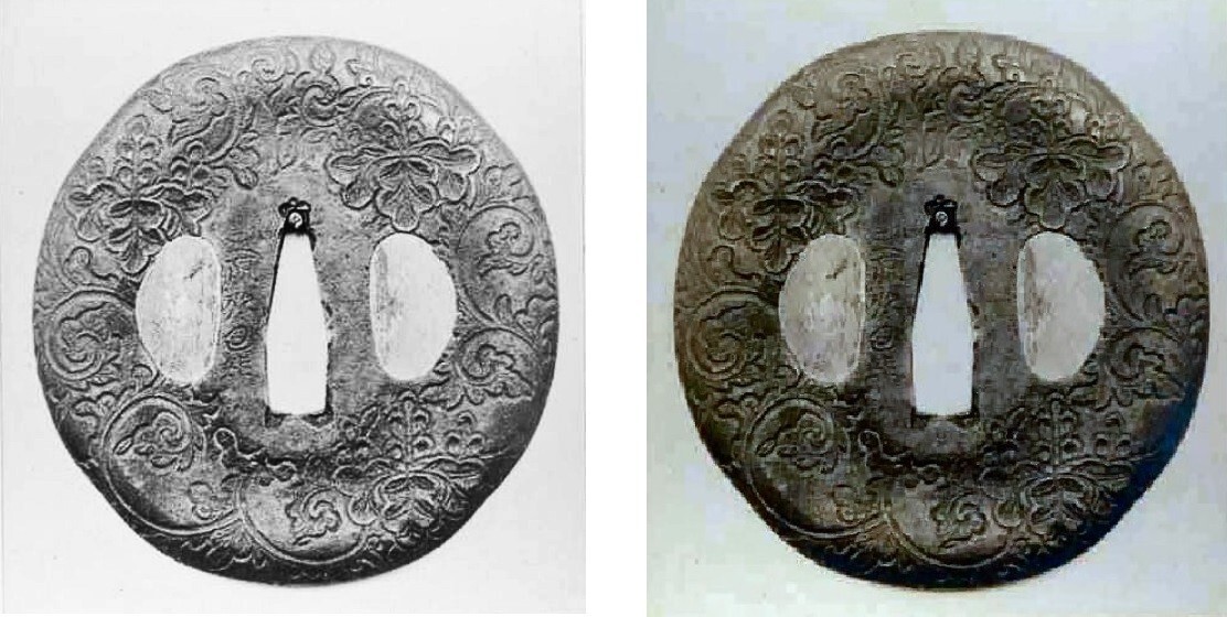

Spartancrest Posted May 25, 2023 Report Posted May 25, 2023 Grev, might it be this image you are looking for? It doesn't show the signature. Catalog Number: 131036.nosub[1] Quote

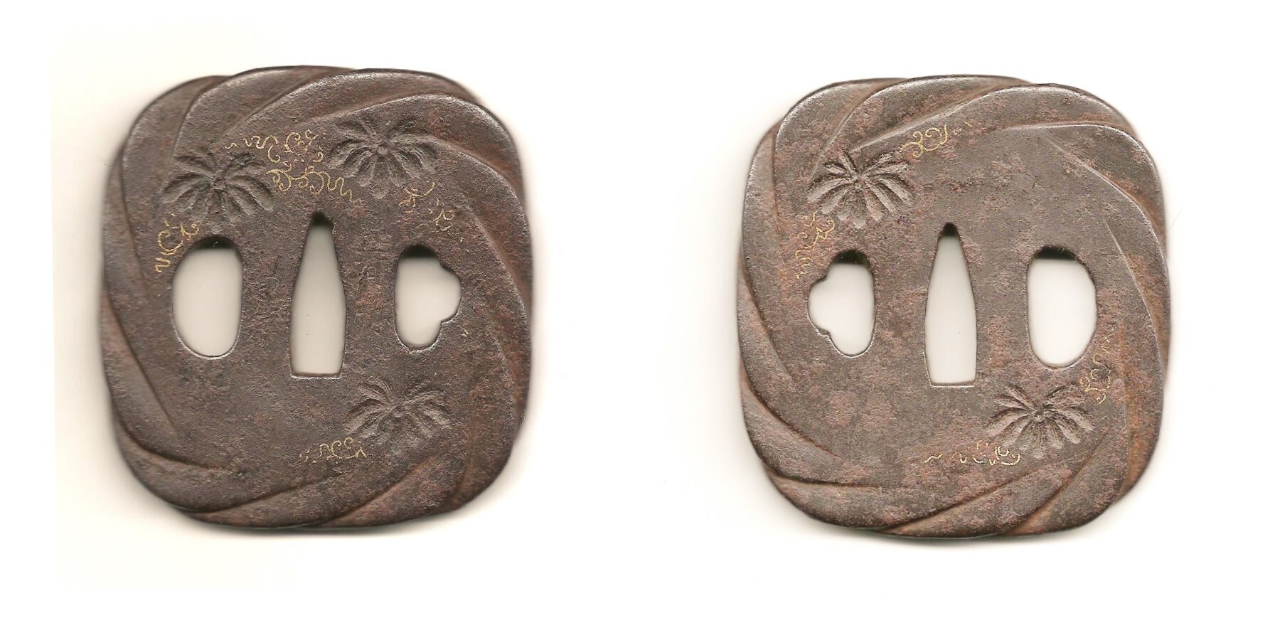

kissakai Posted May 25, 2023 Author Report Posted May 25, 2023 It is very similar to four from the set of 6 images above I would have thought that the on from the Field collection would be signed Many thanks Quote

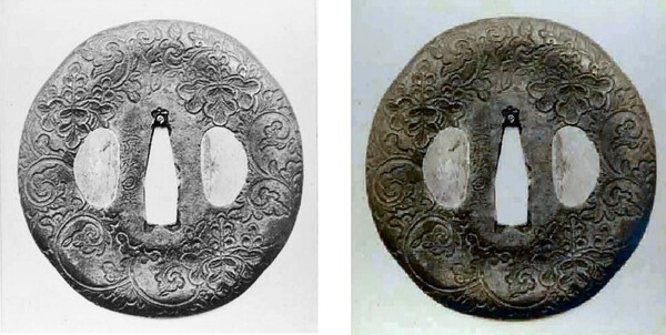

kissakai Posted May 25, 2023 Author Report Posted May 25, 2023 I had this from a curator at the Field museum and it is signed but not the best image Quote

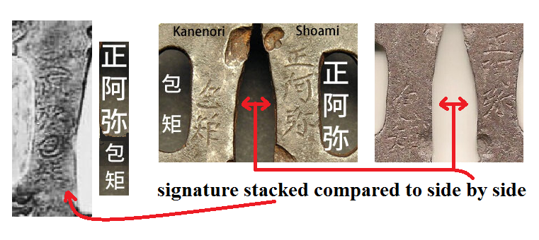

Spartancrest Posted May 26, 2023 Report Posted May 26, 2023 I enhance the image from the website and added the image you posted - but from the look, the signature is not oriented the same as the others above. Is this rearrangement of the mei something that is common? 1 Quote
kissakai Posted May 26, 2023 Author Report Posted May 26, 2023 It does seem unusual but I know as soon as you say there is a rule it gets broken When I read up on school characteristics there will always be exceptions! 1 Quote
