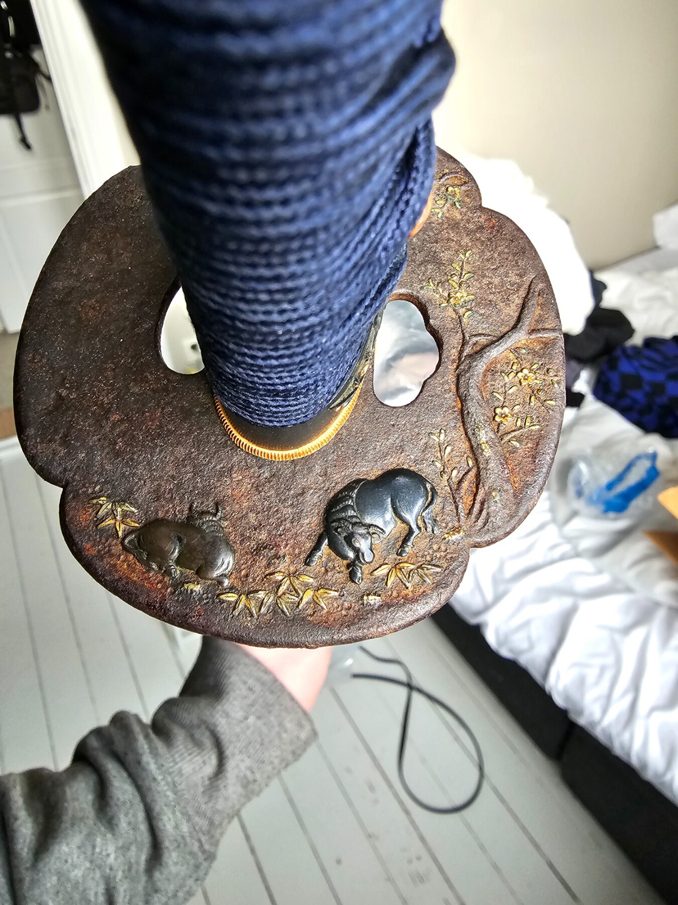

This side of the tsuba has more active rust then I am comfortable with, besides patience and gentle bone treatment here is there anything else I could do? I think there is too many spots where oil could soak in and resurrect the problem in the future so not looking to do that.

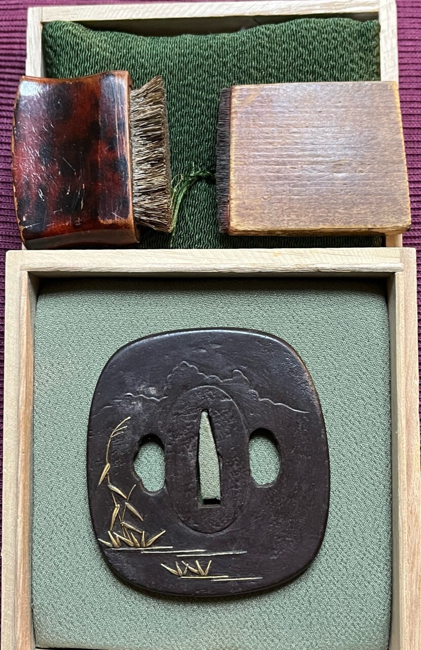

Yes, the problem here is not an overall iron tsuba, but Omar's tsuba above which requires patient delicate work on the iron ji, without touching the precious metal inlays. I have a similar problem tsuba which is an ongoing work of love.

Thanks for the tips all, I think I'll have to look into the fiberglass pen. I'm sure it works for some but I won't use oil or any harder material like steel wool here, for the exact reasons Grey mentioned with the inlayed metals. Bone and patience is what I started with and eventually it should be enough, if the fiberglass pen is what I think it is the areas around the inlays should be treatable as well. Has anyone tried regular wooden toothpicks for this? I'm slightly apprehensive about trying to reach those small spots with what have to be pointy bone or ivory that would apply too much pressure and possibly scratch the patina as well as red rust.
I've never considered having this tsuba professionally restored, it's a nice mumei tsuba I believe could be Mito, or I might be way off, but not a piece I think would at this point warrant such an expense. I've spent my whole fun budget for a while on rare books and travels in a post pandemic frenzy.
Also apologies for the terrible first photo, it looks miles better on my phone but I realized using my laptop that the HDR (extra lighting) layer gets removed when uploaded in addition to added compression noise, this should give a better impression:

Now with a less terrible photo up, am I right assuming the left buffalo is shibuichi?

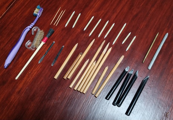

Among the tools I've used for restoring iron tsuba (removing rust) are old broken ivory crotchet hooks that can usually be found at flea markets. With varied shapes and sizes available, just the right one for the job often presents itself. I've not had an issue with these ivory pieces causing damage on an iron surface.
Richard is fairly spot in with the dangers of fibre glass pens, although, I suspect there are differing degrees of hardness to them. I have two different kinds, one tends to be able to get into solid stuff, where as the other just smudges, if that makes sense. Modern day tent struts can be cut down and worked into a suitable shape with a power sander.
This picture is an example close to yours in both smith and condition, I used the pen for the plate and hard up to the inlay (and on the inlay), I used a pine toothpick. Everything else was soap and a "soft" spec toothbrush. Unfortunately I have issues with remembering to photo a Tsuba "before", the before photos in this case didn't show the rust well (or at all really) so focus on the wax removal on the sakura

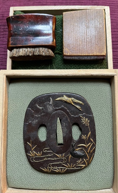

@Bugyotsuji Piers, it reminds my of my own tsuba with the same theme.  Two geese representing unity and/or marriage and an oni.  In mine case the oni is specifically Tsuno Daishi.  This is why I wonder if your cloud and moon oni is on purpose. Sorry again for hijacking the thread.
  • Love 1
鬼の姿で疫病を滅する! “最強”の「角大師護符」とは?|そうだ 京都、行こう。 (souda-kyoto.jp)
Really fascinating background story. I wonder if we could run this through a translation machine?
Since the priest 良源 Ryogen's alternative name was Ganzan Daishi 元三大師, and Tsuno Daishi appeared in his meditation to ward off a pestilence in Kyoto, I wonder if the two birds are a play on words, the sound 'Gan' also meaning 雁 (gan) wild geese?

I actually had the tools out today, so I thought I might take a picture for the visual explanation of the fibreglass pens.
In the photo you can see the the brushes, bamboo sticks, various fibreglass pens (some almost stubs now), pine toothpicks, and two mystery utensils for special occasions, which I won't go in to (Aluminium and brass).
