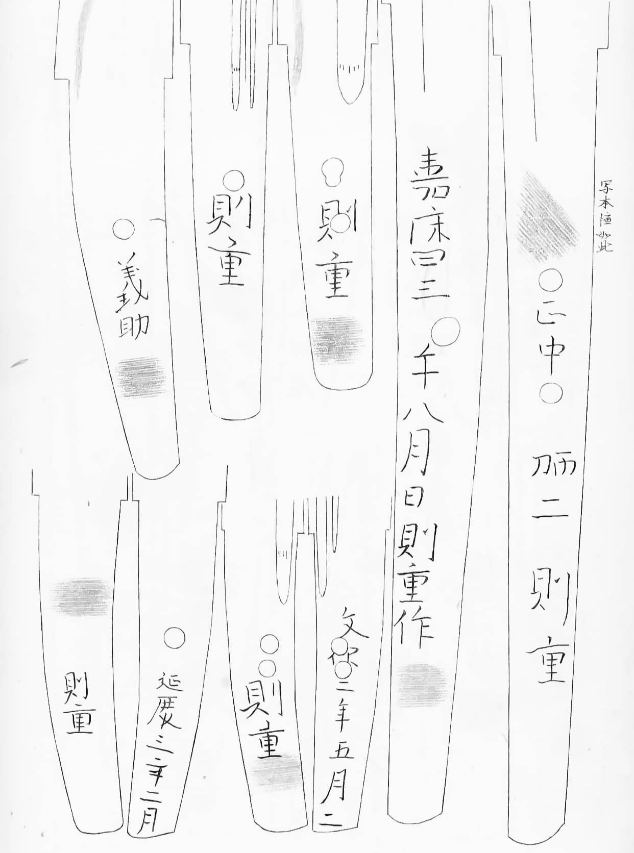

Rivkin Posted August 30, 2022 Report Posted August 30, 2022 1 hour ago, Jussi Ekholm said: For Norishige the youngest date I currently have is 1320, it is actually missing the year but can be judged as it has zodiac and it is only reasonable date in 60 year cycle. There is one that has 1321 date that was featured in old Tōken Bijutsu number but it seems for it the Norishige signature is fake but year signature is genuine. Always an issue whether oshigata can be taken seriously. There are Norishige 1308 and 1314. For Shintogo there is oshigata as late as 1328 and a blade with 1324. There is a position there might have been two or three generations. 1 Quote
Gakusee Posted August 30, 2022 Report Posted August 30, 2022 1 hour ago, Rivkin said: Always an issue whether oshigata can be taken seriously. There are Norishige 1308 and 1314. For Shintogo there is oshigata as late as 1328 and a blade with 1324. There is a position there might have been two or three generations. I am in two minds about oshigata. I do believe the blades existed as represented in the oshigata, with the appropriate mei and nengo. Just we cannot be too sure if the blade indeed is deemed zaimei shoshin per current standards or was just passed down as zaimei through the generations. All these oshigata books contained Daimyo and shogunal blades and the NBTHK in most cases acknowledged that provenance and upheld it. Re: Norishige, there is a Juyo blade which has a nengo of 1320. Quote
