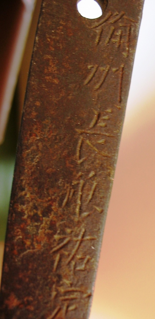

waki - Bishu osafune sukesada opposite side mei help
Hello again,

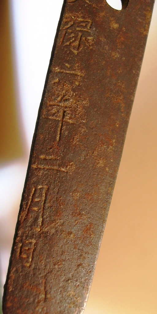

I kindly ask you to help me read mei on waki - on the reverse side of nakago (one side is Bishu Osafune Sukesada) . Waki was sold on our local antique meeting, as a gimei blade. I will preare more photos of the blade.

On this side of the nakago, it is the date. First kanji is missing on the photo.
? + "roku" 5 nen 2 gatsu
So read it as the febuary of the 5th year of ???roku
Maybe bunroku (1592-1596) ?

Eiroku has the same problem, maybe Genroku.
John, finding a ....roku nengo with enough years to fit in, is a somewhat ....unorthodox way to evaluate a smith. A mei: "Bishu Osafune SUKESADA", dating from Genroku period, written like that, is highly unlikely. The sword was sold as gimei, probably for good reasons. I guess we should leave it at that.

The year in the date inscription is not 5 but 6. The era cannot be at least Bunroku, because the last year of Bunroku is 5th.
You are right 五 is 5, 六 is 6. Sorry for this mistake. :oops:

sorry for missing kanji on picture with date inscription. Think that is Bunroku. Is that any chance not to be a gimei signature of Sukesada?

If the mei is gimei, then the nengo (date) is very likely false too.
So treat the blade as if it is mumei and judge it by the work itself?
Brian

As probably a gimei signature, what kind of date is then writen on nakago.
Nengo reads: "Bunroku 6th year......", which is about as silly a date as "January 32nd." (which makes it a gimei for sure).
