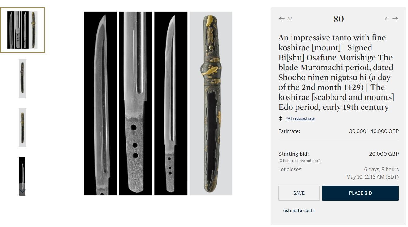

41 minutes ago, Bugyotsuji said:
Where can you see the Mei, Ruilong?
(Surely Sukesada came later on, no?)
The mei looks like Sukesada祐定. It seems not Morishige(but it also looke like Motoshige元重). The year looks like Daiei大永
Another point, they believe this sword is Osafune Morishige dated Shocho正长. But there is no smith named Osafune Morishige(or Motoshige) active in Shocho era.
