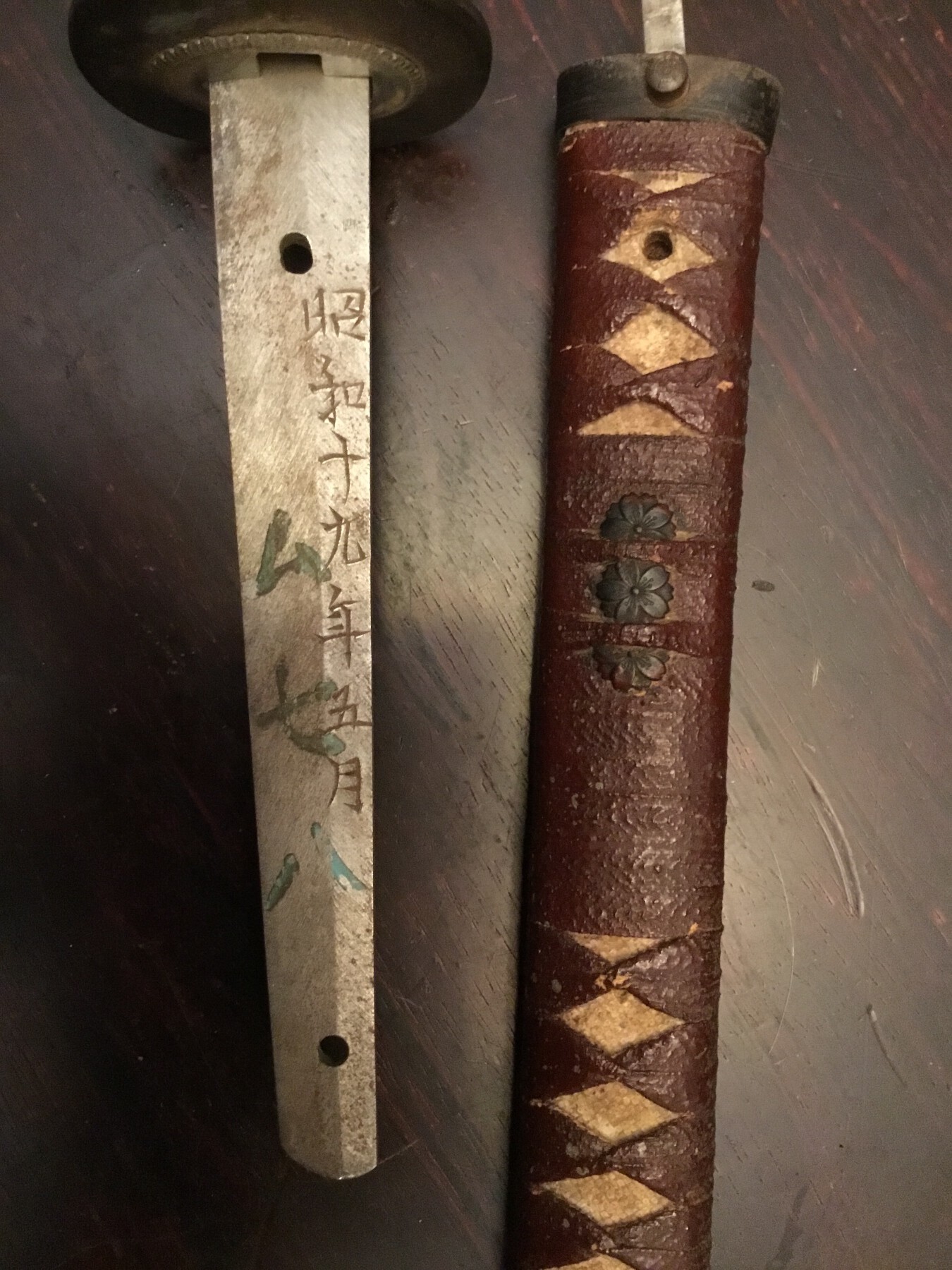

AirDog01 Posted August 23, 2021 Report Posted August 23, 2021 Sorry everybody, I posted this elsewhere before noting this topic section. My apologies for the other post. Will try to delete. Just picked up a late WWII piece with some interesting markings and signatures. It’s off to the polishers now, but any help deciphering would be greatly appreciated. Mark G (AirDog) 1 Quote

Bruce Pennington Posted August 23, 2021 Report Posted August 23, 2021 Mark, the date is May 1944. Someone will help with the smith. Would you mind taking a look at the back edge of the nakago to see if there are any stamps or numbers? Also, are the metal fittings stamped with any numbers? 1 Quote
AirDog01 Posted August 23, 2021 Author Report Posted August 23, 2021 1 hour ago, Bruce Pennington said: Mark, the date is May 1944. Someone will help with the smith. Would you mind taking a look at the back edge of the nakago to see if there are any stamps or numbers? Also, are the metal fittings stamped with any numbers? Hi Bruce. Thanks for the date assistance. There are no other numbers or markings other than the text and the star pictured. This includes the fittings. I was kinda expecting to see those as well since it appears to have been made during the war vs an older piece placed into service. From what I understand sword making during this period was pretty chaotic with a lot of moving pieces Looks to be pretty well made but will see what the polisher has to say in coming weeks. I have a lot to learn! Quote
Bruce Pennington Posted August 24, 2021 Report Posted August 24, 2021 Mark, Your smith, Kaneoto, was an RJT smith. The star on the blade indicates this blade was made for the RJT system using Army-provided tamahagane. It is a gendaito. I see the Seki Ju in the mei. I found this Kaneoto blade and they said "Noshu Seki" is in Gifu prefecture: Quote
Bruce Pennington Posted August 24, 2021 Report Posted August 24, 2021 5 hours ago, AirDog01 said: no other numbers or markings other than the text and the star pictured. This includes the fittings Thanks Mark. Your blade is one of those with 2 sets of painted numbers. One is "(MU) ム 78" and the other is "429". I would love to say the MU 78 was an RJT number, but the mekugi ana closest to the tsuba shows that it was drilled twice, so this blade COULD have been re-fitted to the current fittings from something earlier. This would explain, from a fittings shop perspective, the two sets of numbers. Quote
DTM72 Posted August 24, 2021 Report Posted August 24, 2021 BTW your date is 昭 = Sho 和 = Wa 十 = Ju (10) 九 = Ku (9) 年 = Nen (Year) 五 = Go (5) 月 = Gatsu (Month) 1 Quote
DTM72 Posted August 24, 2021 Report Posted August 24, 2021 関 = Seki (City) 住 = Ju (Lives in) 藤井 = Fujii (First name) 兼音 = Kaneoto (Art Name) 作 = Saku (Make) 1 Quote
