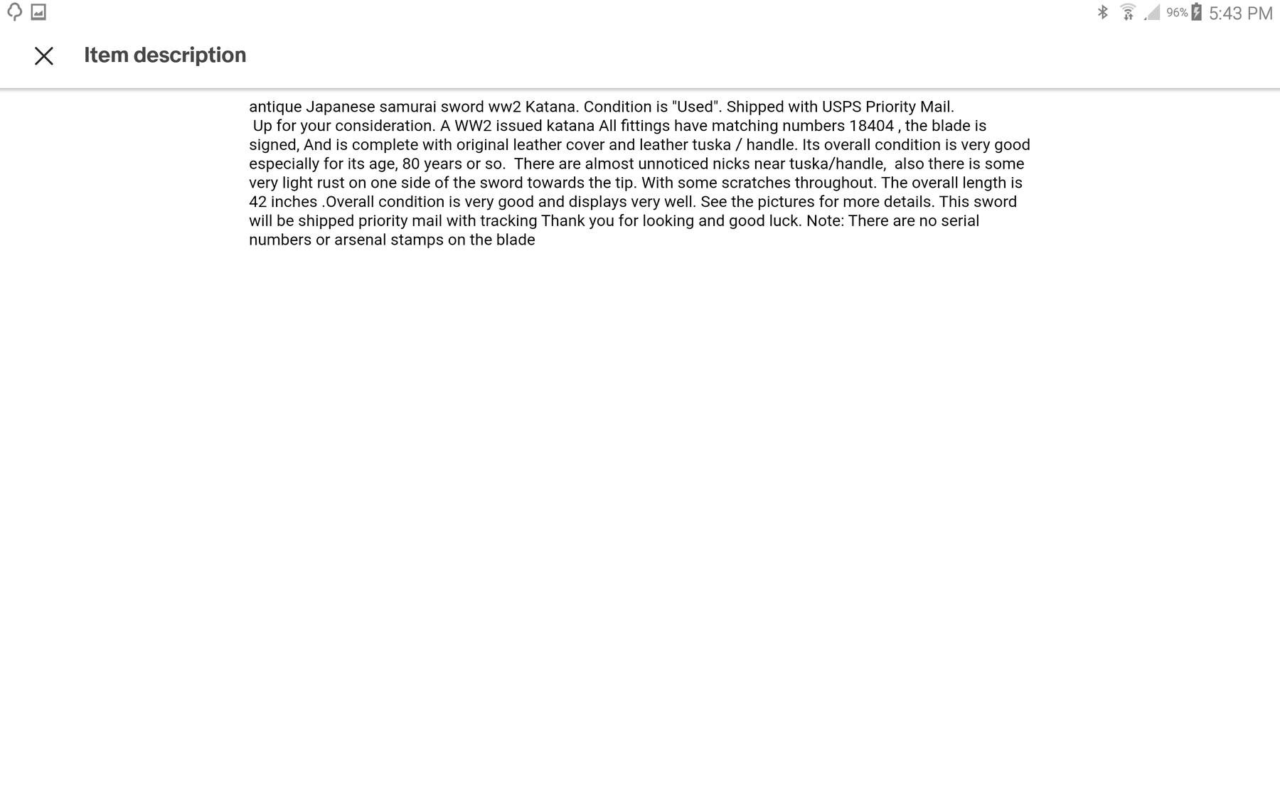

Sorry to post things that may be fake (rather than good stuff) but it makes me really angry when I see sellers describing swords that, some would consider, not genuine.
Noticed this sword at....
https://www.ebay.com/itm/384240327437
Now I am far from an expert (no, REALLY far), but there are a number of things I see in this sword that, in my mind,  don't equal "antique" "Origin Japan" 'WW2 1939-45' etc.  The seller has 100% feedback so that makes me cautious.  I have been wrong many times in the past, most recently with a fake 95 (looked genuine 🤔 but clearly accept the concensus ).
So do you think its a rip-off low down fraudelent listing or a genuine gunto in all respects?

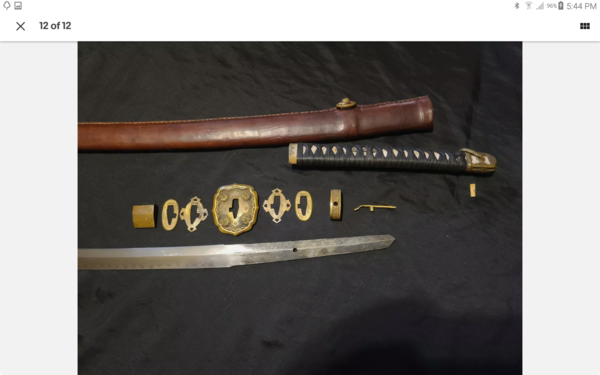

I think a "Bitser", possibly an original very very worn blade, and the rest a grab bag of replica parts. The leather of the saya is a give-away, it should be vegetable tanned with very small stitches.
Thanks Tom and Paul.
Dave, leaving others bits out at the moment, in regard to the blade do you think there's anything incorrect with the ...
1. (lack of) lining up of the Ha-machi and Mune-Machi,
2. the exceptionally pointed nakago-jiri
3. the rough file marks on the nakago
4. The strange shape of the Ha- machi
5 and the very 'almost vut not quite 'aged nakago
Rob
Thanks John and Jean, this cements my view.
