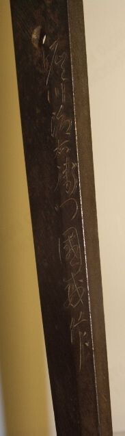

mattlehman Posted January 1, 2009 Report Posted January 1, 2009 Thanks in advance. The story goes that my grandfather picked this sword off a body in WW2 and marched with it for a few miles in his pant leg before he could ship it back to my grandmother. He had to carry it in his pants because if caught, the officers would take it from him and send it home themselves. He always wanted to try to find the family (if it was possible) and give it back to them. I learned of that upon his death and it was given to me. My research has given me more questions than answers. It does have the star stamp which is associated with Rikugun Jumei Tosho. Any help as to the maker or date would be great. I think it was probably a factory made sword, since they would be more common, but I could be wrong. Thanks again Quote
Stephen Posted January 1, 2009 Report Posted January 1, 2009 date is 1942 posting the pix so its not such a head turner,,Kuni ..something...hiro??? Quote
mattlehman Posted January 2, 2009 Author Report Posted January 2, 2009 Thank you for that much. I also forgot to mention that there is a 487 stamped on the bottom of the tang. Don't know if that helps or means anything. Quote
Nobody Posted January 2, 2009 Report Posted January 2, 2009 The mei is 堀川治右衛門國威作 (Horikawa Jiemon Kunitake saku). Quote
mattlehman Posted January 2, 2009 Author Report Posted January 2, 2009 Thank you again. Is this just a mass produced sword for WW2 or is there anyway marking to help locate the original family name? Quote
John A Stuart Posted January 2, 2009 Report Posted January 2, 2009 Horikawa Jiuemon Kunitake was born in 1897 and worked as a Rikugun Jumei Tosho during WWII. He founded Akita Prefecture Danrensho and worked as the first president. He was regarded as the best Showa smith that worked in Akita with Shibata Ka. This is who made the sword not who may have carried it. You need personal info, like surrender tags, or notes from your grandpa as to where it was obtained or maybe even by family mon on the fittings to give you direction in this kind of search. John Quote

mattlehman Posted July 13, 2009 Author Report Posted July 13, 2009 I was finally able to pick up the sword and here are full pictures. Can anyone give me a ballpark figure of it's value. I need to figure out if I am going to put it on my insurance. thanks 1 Quote
mattlehman Posted July 13, 2009 Author Report Posted July 13, 2009 as you can see it's in pretty darn good shape. a few small nicks on the blade and the part of the handle that houses the button release is broken. All the parts are there and working, but the wood around it has deteriorated with age. Quote

shibeni Posted April 19, 2019 Report Posted April 19, 2019 Guess, if your's Kunitake was made in 1942 with number 487, my was made by him January 1943, and has number 490..Could be Kunitake's sword production numbering? Regards, Bojan S. 1 Quote
