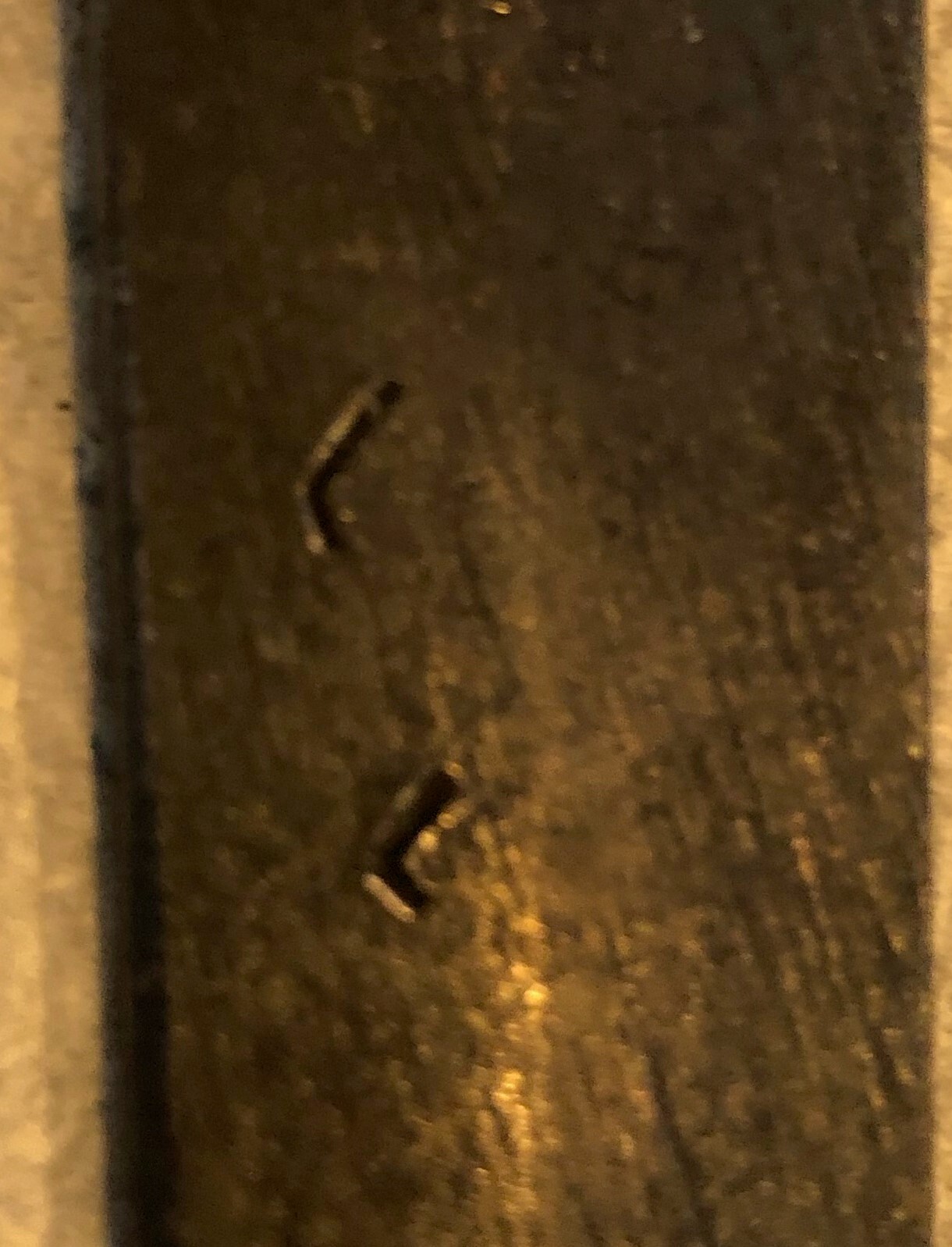

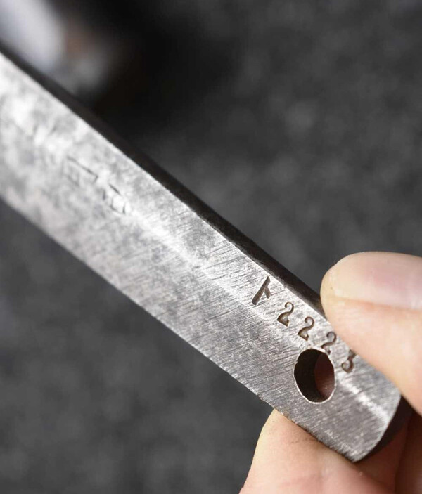

Bruce Pennington Posted June 11, 2021 Report Posted June 11, 2021 I'm bringing a non-RJT blade to the discussion because it's a good example of how difficult it is to pin down this question of stamped numbers on nakago. It's one owned (or posted) by @Stegel. I can't find the original thread or I'd post the link. It's a late-war Type 95 blade, with the ヘ HE of the Heijō Factory of Jinsen Army Arsenal. No bohi, and the fact that it was made by Jinsen puts it in the last year of the war, most likely. It's in "standard" Rinji seishiki fittings, but with a low quality Type 98 tsuba. I'm discussing it because the nakago is stamped "1285" while the fittings are stamped "21". First glance screams "Post-war piece-together!", but I don't think so. I think it was simply last year of the war, Jinsen, or a shop in the area, used whatever parts were available to get an officer gunto put together for a buyer. To my knowledge, there are no NCO Type 95s with stamped numbers on the nakago. So, if it were made for an officer, or re-purposed for one, why would it have "fittings numbers" stamped on the nakago that don't match the fittings? Of course, like the other mis-matched numbers discussed on another thread, the blade could have been re-fitted after some damage to the original fittings, but, in the last year of the war? Seems a stretch. But if the numbers on the nakago aren't fitter stamped, then why are they there? More examples of Jinsen type 95 blades with numbers would certainly help with answers, but this one example seems to tilt the issue a tiny bit toward the numbers being put there by the factory or Army inspectors. Then again, I may be stretching the whole example when the easy answer is the blade was stamped 1285 by the first fitting shop and then re-fitted with the current set of RS fittings after damage, or even post-war. If post-war, that still leaves a sticky-wicket question of why would a Type 95 blade have stamped numbers on the nakago. Which STILL brings the issue around to "not done by fitters." Thoughts? Quote

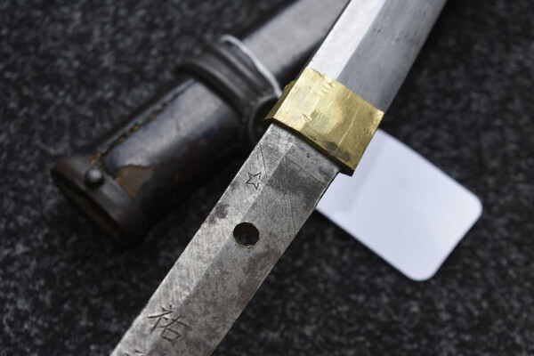

BANGBANGSAN Posted July 3, 2021 Report Posted July 3, 2021 @Bruce Pennington I‘m not sure if you have this one on file.Tang marked #20. 親房 皇紀二千六百年三年二月日(1943.2) 1 Quote
Bruce Pennington Posted July 3, 2021 Report Posted July 3, 2021 3 hours ago, BANGBANGSAN said: not sure if you have this one on file.Tang marked #20. 親房 Trystan! This one is a game-changer if I've translated the mei right - Chikafusa of Nagano prefecture? It has a faint "Matsu" stamp in front of the number. So, if Chikafusa is right, then this is the first known Matsu stamped blade we have that's not Akihisa or Munetoshi (Yamagami Brothers). @george trotter !!! 1 Quote

BANGBANGSAN Posted July 3, 2021 Report Posted July 3, 2021 1 hour ago, Bruce Pennington said: Trystan! This one is a game-changer if I've translated the mei right - Chikafusa of Nagano prefecture? It has a faint "Matsu" stamp in front of the number. So, if Chikafusa is right, then this is the first known Matsu stamped blade we have that's not Akihisa or Munetoshi (Yamagami Brothers). @george trotter !!! Bruce It should be 櫻井親房 from 長野. http://ohmura-study.net/025.html He is #36 in 鍛錬刀の部 入賞刀位列 list. Never say never to WW2 Gunto that's what I’ve learned. 1 Quote
Bruce Pennington Posted July 4, 2021 Report Posted July 4, 2021 11 hours ago, BANGBANGSAN said: 櫻井親房 from 長野 Thanks again Trystan! I don't see a star, is this your gunto? Is this the best photo of the nakago? Quote
Bruce Pennington Posted July 4, 2021 Report Posted July 4, 2021 Interesting that the Yamagami brothers and Chikafusa were in adjoining prefectures: Quote
BANGBANGSAN Posted July 4, 2021 Report Posted July 4, 2021 1 hour ago, Bruce Pennington said: Thanks again Trystan! I don't see a star, is this your gunto? Is this the best photo of the nakago? Unfortunately, it's not my sword. But I think there is a star stamp on top of the Mei. 2 Quote
