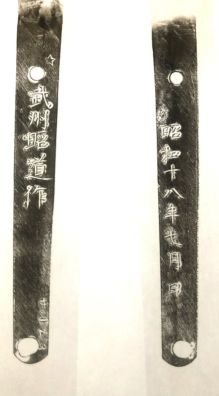

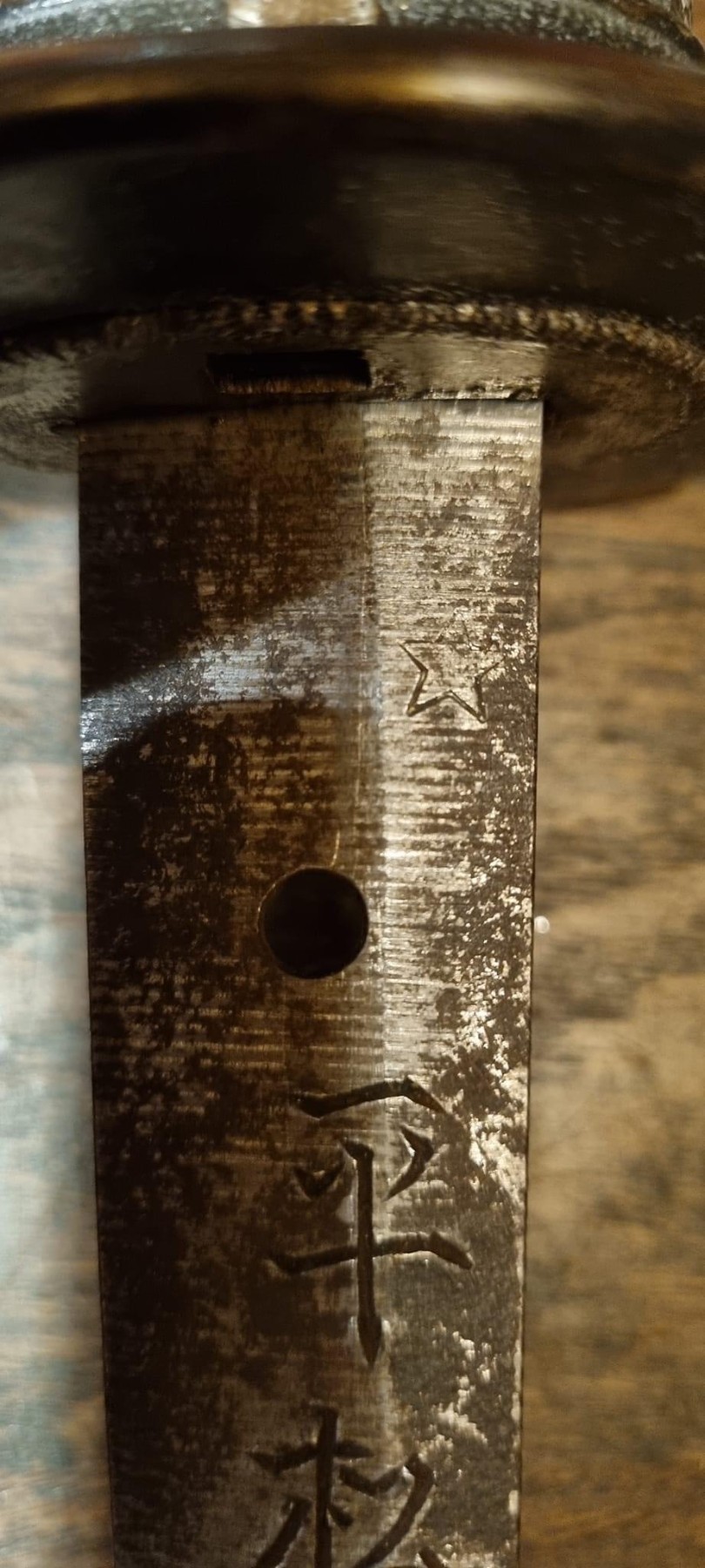

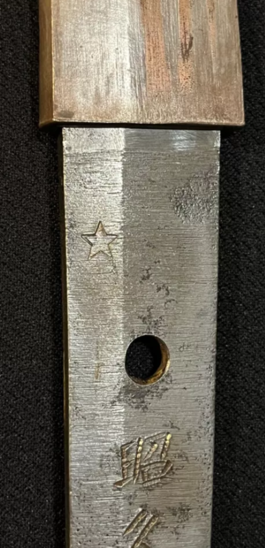

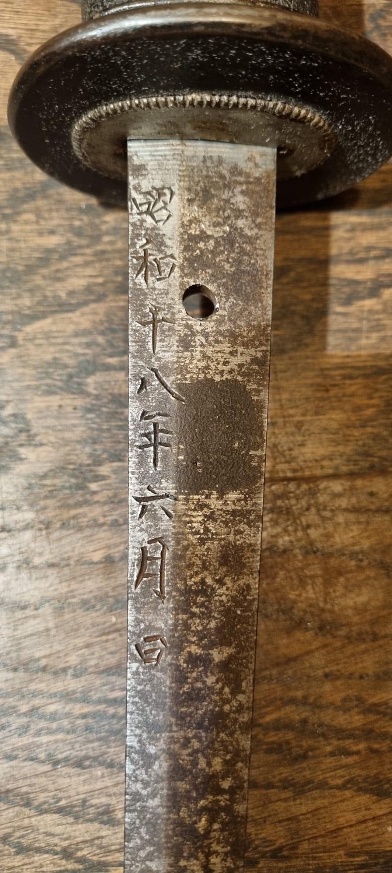

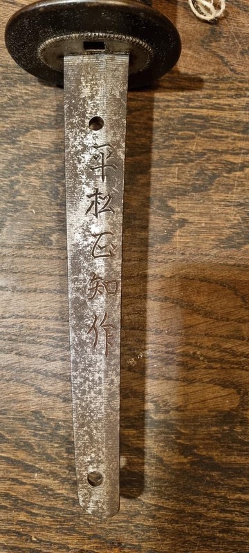

Star stamped Rinji ,June 1943,平松正知  Hiramatsu  Masatomo
MASATOMO (正知), Shōwa (昭和, 1926-1989), Ōsaka – “Masatomo” (正知), real name Hiramatsu Danji (平松団次), born October 27th 1901, he studued under Morita Masamichi (森田正道) and worked as rikugun-jumei-tōshō。

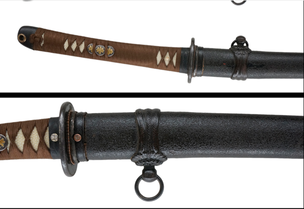

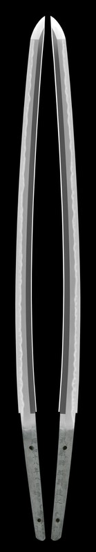

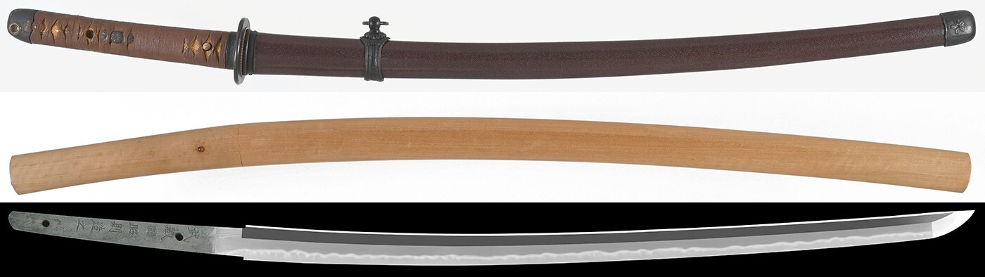

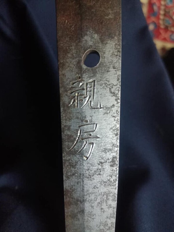

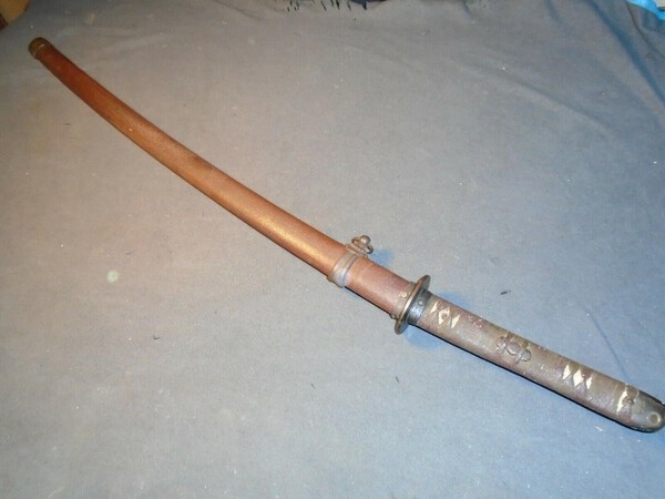

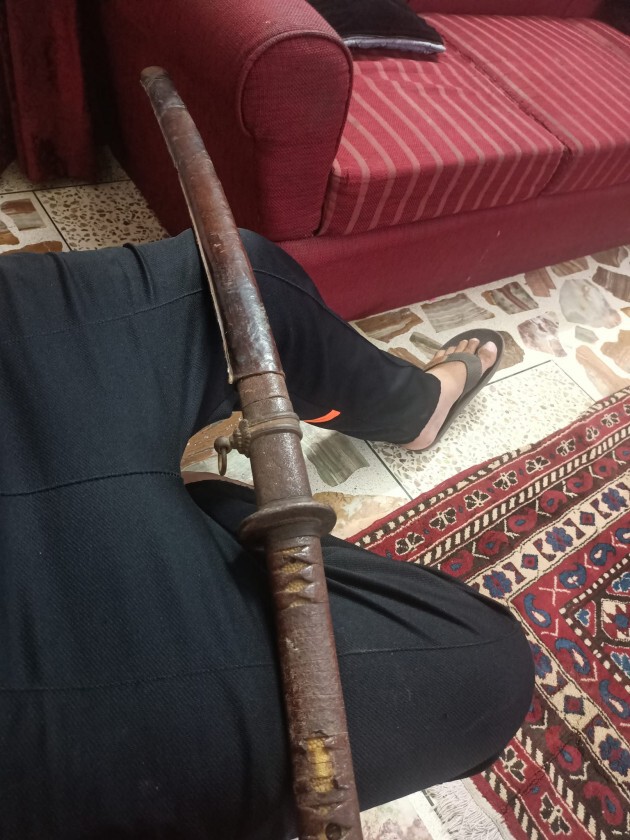

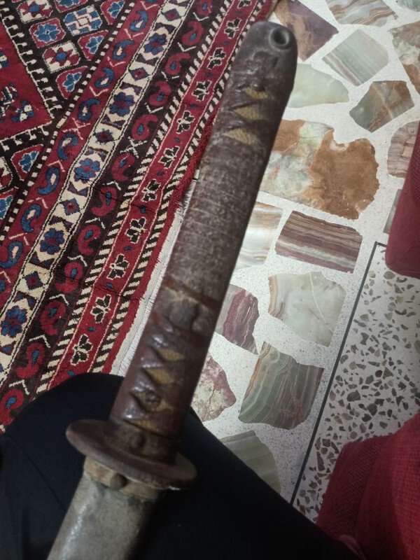

A type 3 niigata Chikafusa gendaito is offered on facebook for $1000
If someone wants to jump in i don't know where this sword is located. Looks like Pakistan or something else in that region. After some research the same guy postet that sword 2021 first and asked for any infos.
Chikafusa is something rare.
It looks like a job for Indiana Jones.
https://www.facebook.../groups/255263006217

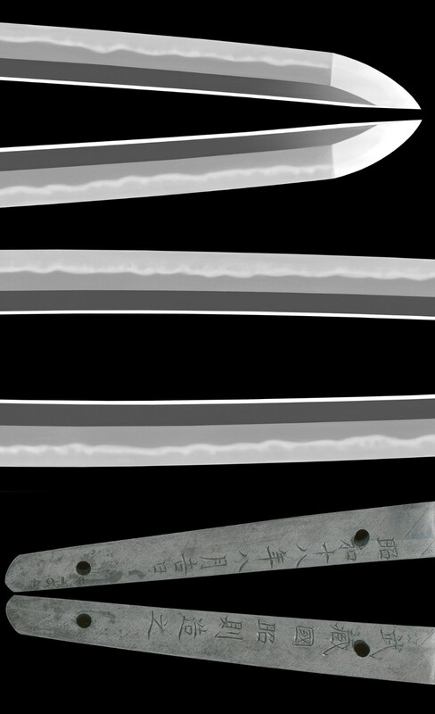

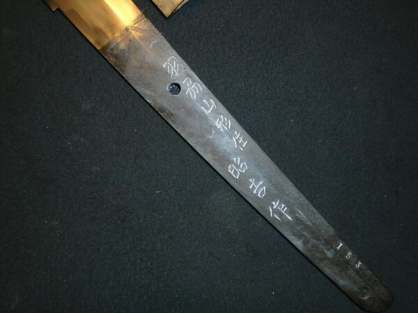

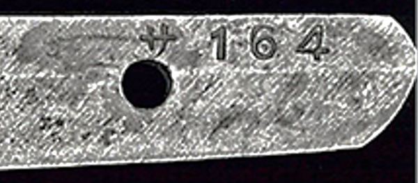

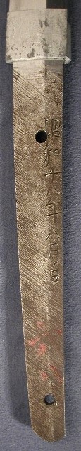

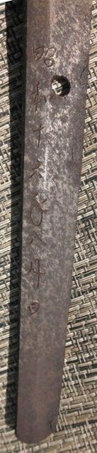

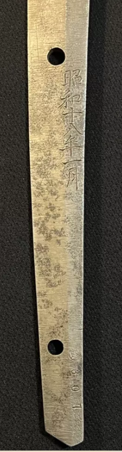

☆ 武蔵国昭則造之 Musashi-no-kuni Akinori Tsukuru Kore.
昭和十八年八月吉日 サ164 A lucky day in August 1943 SA-164.
A Type 100 with a star stamp and prefecture serial number.
品番No-sw23169
Good eye, Thomas!  But Stephen beat you to the punch.  See my post just above Trystans.
Chris,
I'm not on Facebook.  Any way to get a clear shot of the full nakago.  There very well might be a stamped number, with kana, on the end.
Date looks like 1943.

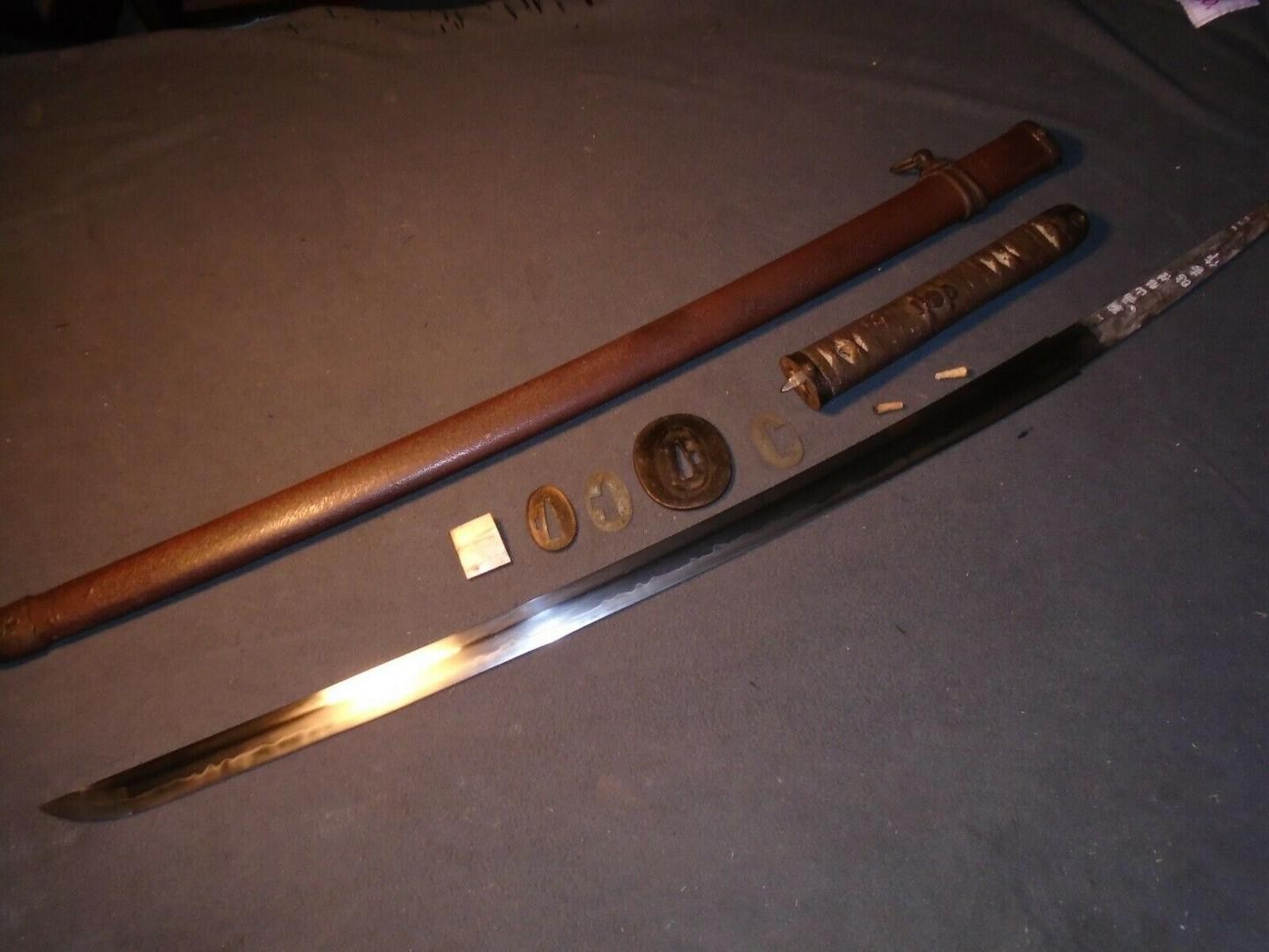

He did not answer yet. Others sent him offers around $800. It's a little strange. Someone cut out the menuki from the tsuka :doh:
  • Wow 1

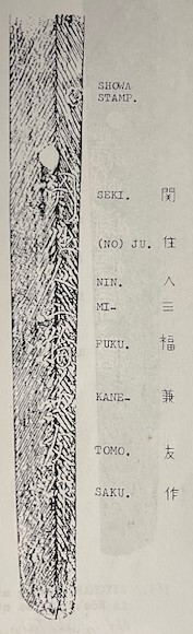

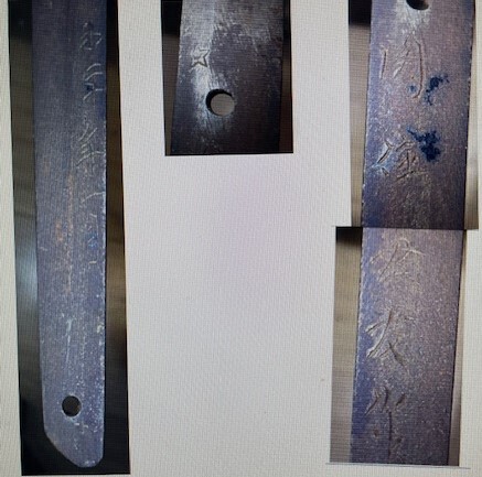

Mei is      Seki Ju Kanetomo      date is Showa 20 (1945)  February    and he is RJT with star.  Maybe is he this one:  but not 100% sure
KANETOMO (兼友), Shōwa (昭和, 1926-1989), Gifu – “Miwa Kanetomo saku” (三輪兼友作), “Kanetomo” (兼友), real name Miwa Shizuo (三輪静夫), born March 31st 1916, student of Kojima Kanemichi (小島兼道), he worked as guntō smith and died July 27th 1994, jōkō no retsu (Akihide), Second Seat at the 6th Shinsaku Nihontō Denrankai (新作日本刀展覧会, 1941)
image.png.1b1588f71f99b4b5d137b8c401a27c87.png            tomo1.JPG.e51b58cecc6551ea77802cd5423518e4.JPG           tomo2.JPG.24982d756524613d3a9082fec05e80df.JPG
Speaking of poorly cut mei!  Look at that "Sho" at the beginning of the date:
01F86D47-FA8F-49BF-9D71-1E30996030DF.thumb.jpeg.905ad48f8f333fe714924b7b058fb6ac.jpeg.c9b9628ef53f9166f1fae46428237578.jpeg
Makes me think of that other discussion we were having.  This is Jan '45, and the other is not dated, but fittings bespeak late-war.  They must have had some really inexperienced labor in that last year as we were decimating the sword factories.

昭和十七年一月吉日 A lucky day in January 1942.
馬場継清作之 Baba Tsugukiyo saku kore.
馬場継清作之 昭和十七年一月吉日
1476
昭和十七年八月 August 1942.
群馬今井兼継 Gunma Imai Kanetsugu.
群馬今井兼継 昭和十七年 NO1476
1786
祐弘作 Sukehiro saku.
皇紀二千六百二年仲冬 Midwinter 1942.
皇紀二千六百二年仲冬1786祐弘作銘陸軍士官三式軍刀拵え入り刀
馬場継清作之 763 Baba Tsugukiyo saku kore.
馬場継清作之 昭和十七年一月吉日
Number 1476 via text.
群馬今井兼継 昭和十七年 NO1476
祐弘作 Sukehiro saku.
皇紀二千六百二年仲冬 1786 Midwinter 1942 1786.
Thanks Thomas!  I never would have seen those on those sites.

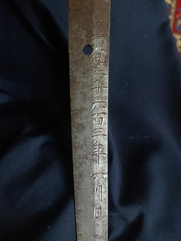

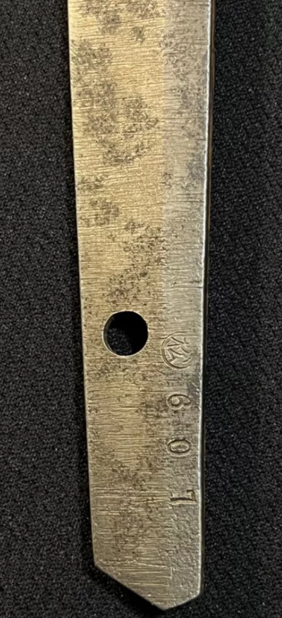

A June 1942 Hiromasa, sent to me via email from Robinalexander.  Nakago only photos.  Has the Yama Ho stamps.
@mecox
20220122_171049.thumb.jpg.5d70a1149cb10cfe52ab3f4ab53f2756.jpgStudio_20220122_171825.thumb.jpg.4fc2a4e1cec31190fd8d82b5775f9c01.jpgScreenshot_20240926_112112_Gallery.thumb.jpg.e71fdf4736313a1b107eadccc6e5626d.jpg
Just a reminder.  We had been discussing a June '42 Masatsugu on another thread and it was said that it might have been too early for the RJT star to be present.  After logging this Hiromasa, I was reminded of 3 earlier blades:

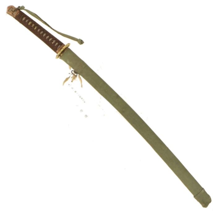

11 hours ago, Bruce Pennington said:
More star news!  Only the second MUMEI, no date, star-stamped blade I've seen.  First one was posted by @BANGBANGSAN here:
This new one is on this ima-usa.com page:

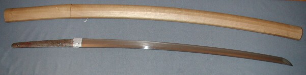

Thanks for posting this. It looks like there were some engravings on the tang, but they were scratched off?
The tassel is very interesting. It looks like it was fieldmade and wrapped around the wrist to prevent slipping, rather than to indicate rank.
