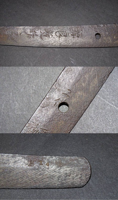

John @PNSSHOGUN just found a beauty that I think might be a zoheito.  Uniquely has the Suya Shoten stamp on the nakago by the number "14"  Is this Yoshichika?  And what is the single kanji at the top of the mei, cut by the ana?
Update: After talking it over with John, the Suya stamp likely indicates this blade had been previously fitted by the Suya Shoten Co. and the blade is likely traditionally made.
found HERE.

Many Yoshichika swords, Shodai & Nidai, are found in Suya mounts but I have never seen the stamp on a sword before. Could this mean they were making swords for Suya directly at some stage, or at least contracted? As Yoshichika made swords for the Imperial Guards as well perhaps they are all connected somehow.

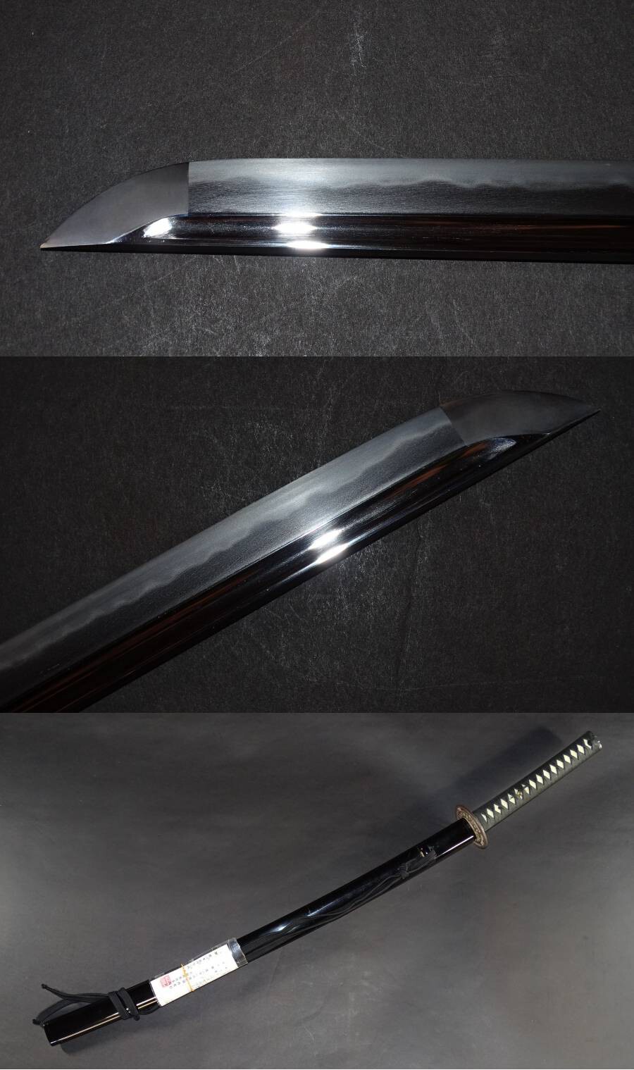

A nice zoheito found by @mecox, thanks Mal!
https://vi.raptor.ebaydesc.com/ws/eBayISAPI.dll?ViewItemDescV4&item=134007324527&category=165599&pm=1&ds=0&t=1643389175924&cspheader=1
I’m away from home at the moment.  Will post some pics when able.
Note the copper mekugi the seller apologized for damaging during removal.  I have seen a couple of these come up recently, and I had mentioned to the owners that I thought it was post-war because I did not know they made copper ones during the war. But this one sure looks like it was original.

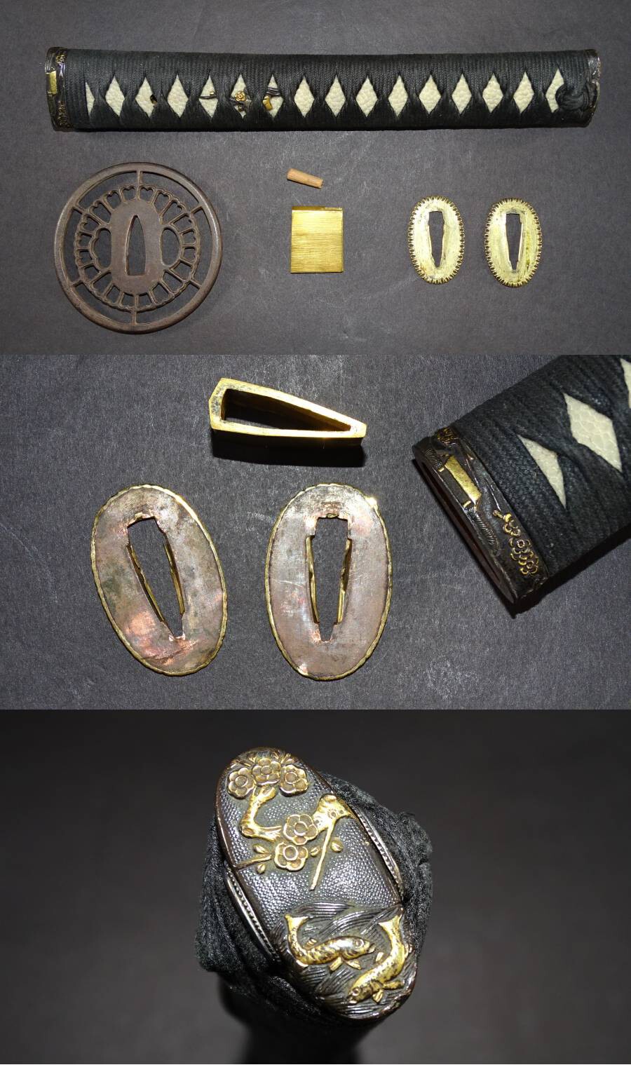

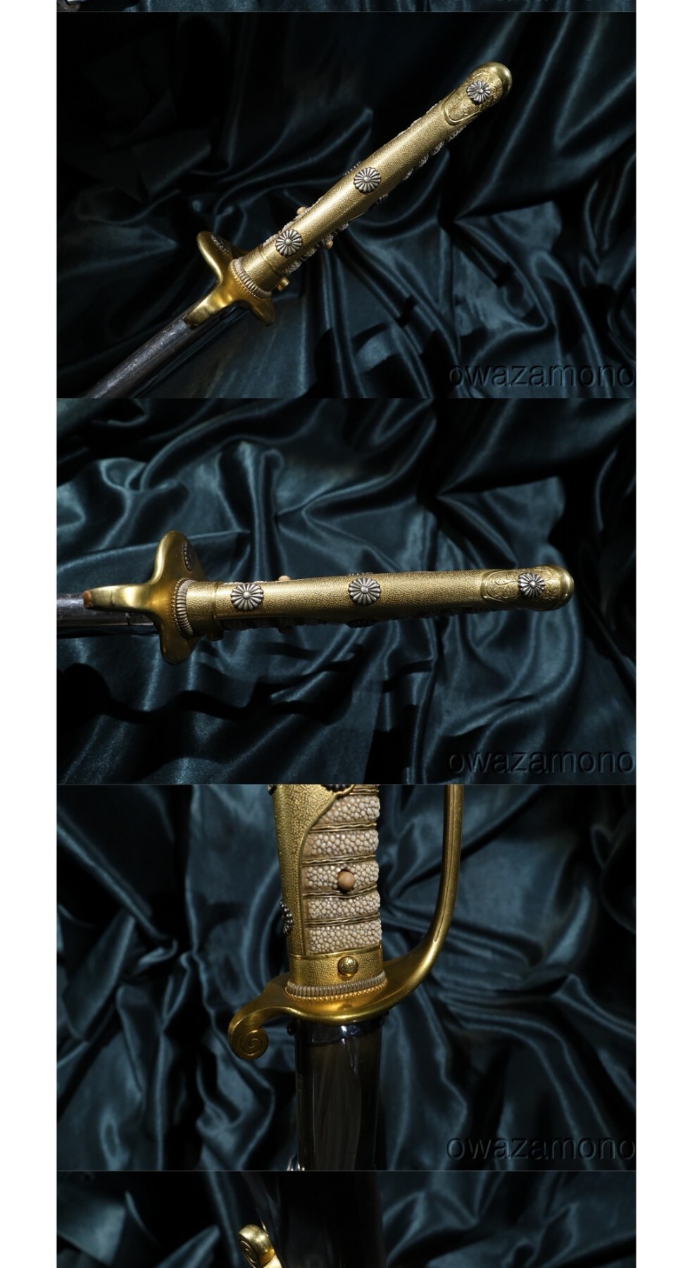

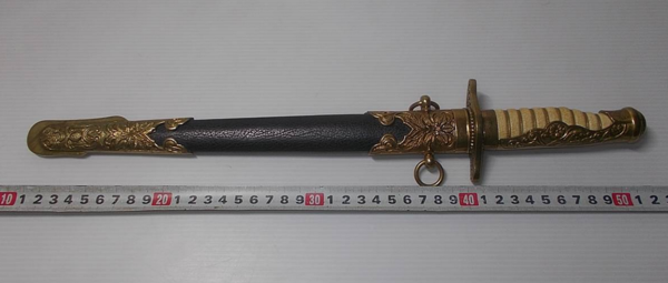

Almost certain those fittings are modern reproductions, similar ones have cropped up on yahoo.jp auctions before. Here is a stated replica dagger with the same style. A good reminder that not everything coming out of Japan is automatically original.
https://buyee.jp/item/yahoo/auction/w1041773928?conversionType=service_page_search

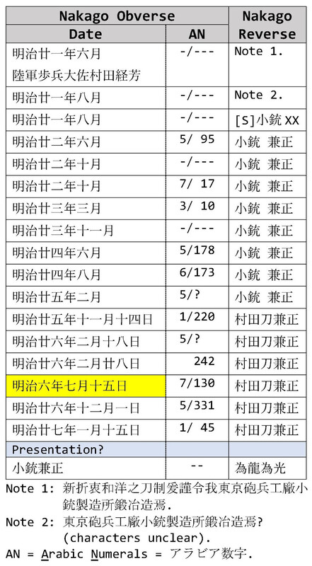

The prefix rifle 小銃 used by Kanemasa 兼正 is most likely the location where the blade was made.  In this case, the Rifle Factory of Tōkyō Artillery Arsenal 東京砲兵工廠小銃製造所.  The first two blades are actually marked with the full name.

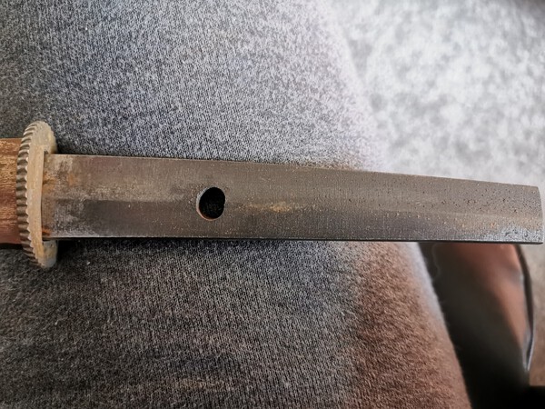

On 5/11/2022 at 7:46 AM, Ontario_Archaeology said:

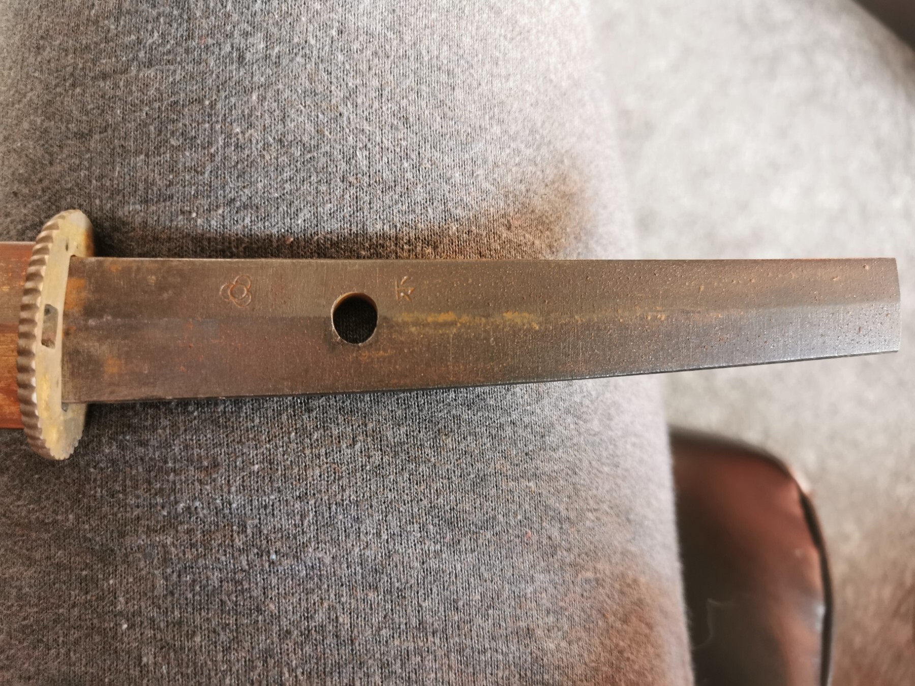

I recently bought one from the Plimpton collection... Here are some photos of the tang. Sorry this might be a murata to. I'm not sure if these are the same or not.
This is a 造兵刀,"ホ" is Kokura Army Arsenal  First Factory inspection marks.

Welcome to the forum Ryo.  I ran across your father's sword over at GBF and have the number down as 5/95 as shown in the list above.  The 小銃 is probably referring to the location, in this case the Rifle Factory of Tōkyō Artillery Arsenal.

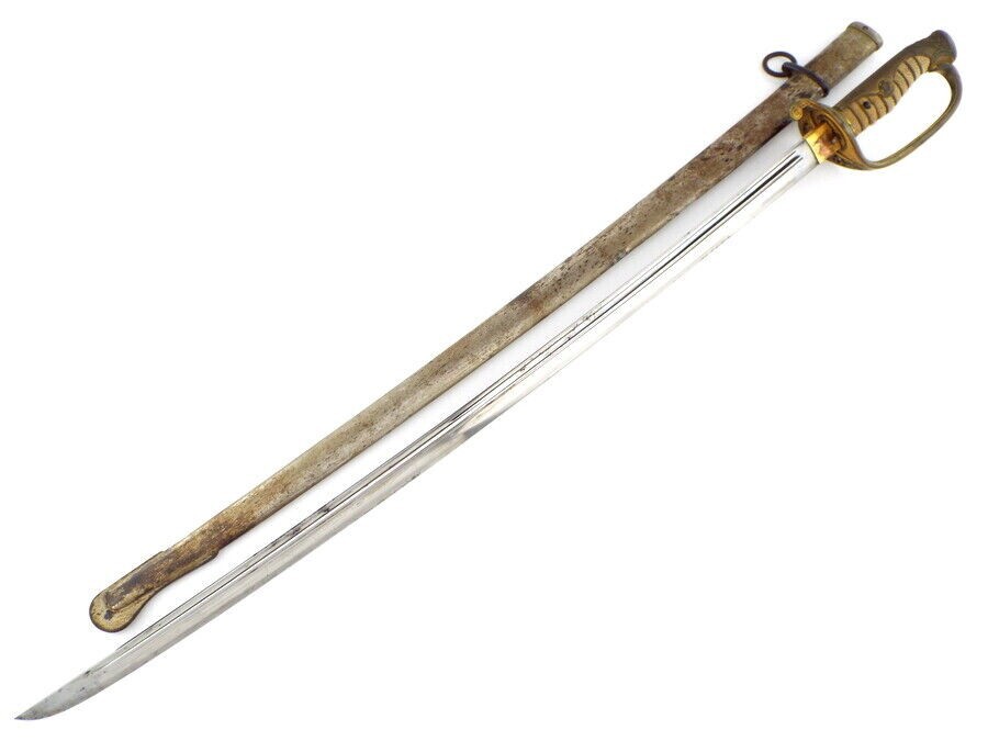

Nice one John!  The blade tip doesn't look like a standard zoheito.  Maybe a Muratato?

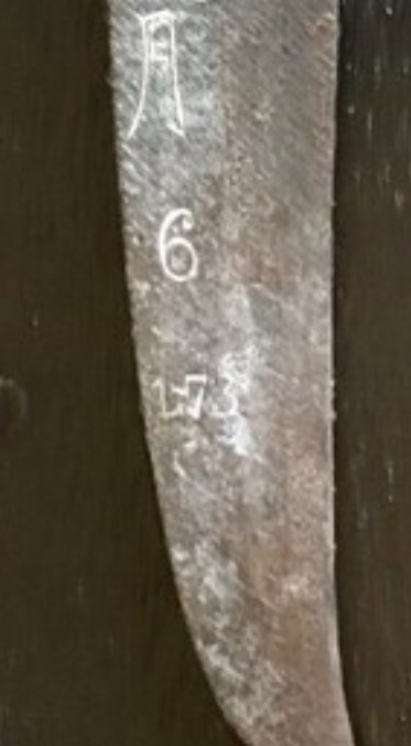

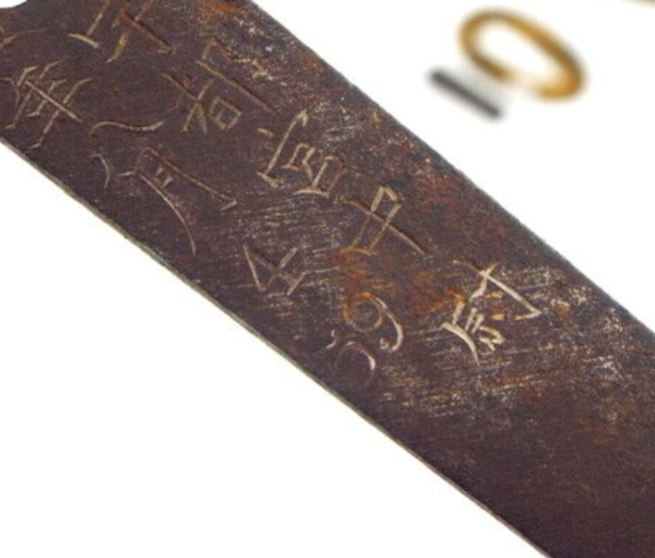

Can anyone make out the date?  I see Meiji (1868) [?] 4 year, 8 month.  It's that one kanji I don't recognize:
The fittings are really well made, too bad about that wire wrap.
1854986069_s-l1600(1).thumb.jpg.3a39ba9088f19939e3b364b02cb98e65.jpg860943279_s-l1600(2).thumb.jpg.7fd7f9938de1a942acfbf0006ad2cb3d.jpg
Also numbered "4  59"
