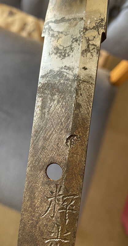

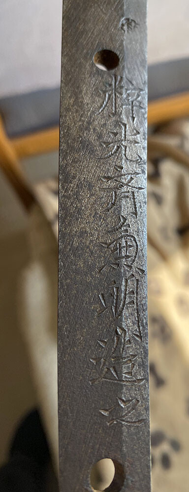

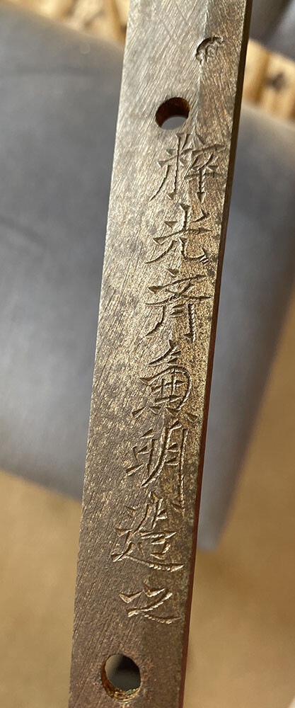

Brian Posted August 24, 2020 Report Posted August 24, 2020 An acquaintance popped round recently with 2 swords he purchased, and asked me for any info. Can't sit at the pc for long enough to have a go, so am asking the members if they don't mind assisting? Bit unusual because we don't often see wakizashi with a Sho stamp. I assume that is what the partial stamp is. Also, is that tsukuru kore? So not just bar stock. Anyways, it had what appears to be a very controlled sanbon sugi hamon. Can anyone assist with the mei? Quote
Mark C Posted August 24, 2020 Report Posted August 24, 2020 Hi Brian, Could be: Suikosai Kaneaki tsukuru kore wo Japanese Sword Index has an example under Oshigata of Showa swordsmiths 3 Quote
Bruce Pennington Posted August 25, 2020 Report Posted August 25, 2020 I agree that it's a partially struck Sho stamp. Quote
Brian Posted August 25, 2020 Author Report Posted August 25, 2020 Thanks all. So one of the scarce wartime wakizashi made as such and with arsenal stamp. I do find them uncommon...most being earlier blades. Quote
Bruce Pennington Posted August 25, 2020 Report Posted August 25, 2020 I wish it were dated. We have 1 Showa stamped blade from 1935. The rest are 1938 and beyond. 1 Quote
