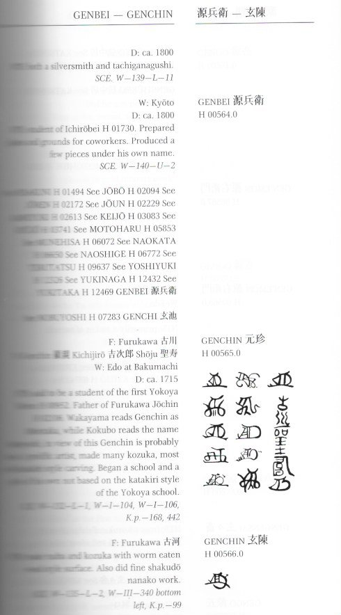

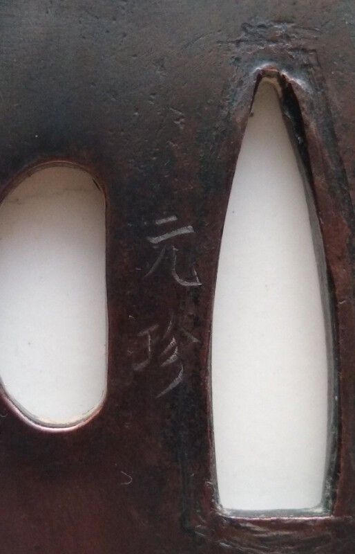

Babu Posted August 9, 2020 Report Posted August 9, 2020 I picked this up the other day sold as Hotei by MotoYoshi. I think this may be wrong as I read the mei as Motochin 元珍 or even Genchin. Furukawa Genchin was an artist of the Edo period who signed with these characters. Also I don't think this is Hotei. I believe it is Jizo, Jizo has a sort of double role. To protect children, also to protect the souls of children who passed away and unborn babies. In the Japanese belief, it is thought that the soul of children who died before their parents, have not built up enough good deeds so are not able to cross the river to the afterlife. They remain on the side of the river, having to pile stones as an act of penance. Devils come to try to destroy these stone towers, and this is when O-Jizo-san appears and saves them by hiding them from the evil spirits in his clothing. He then looks after them as as guardian in replacement of their parents eventually smuggling them across the river in his robes. 2nd Jizo also protects travelers, which is why you will often find Jizo statues on the side of the roads. This tradition is derived from the ancient belief of Dosojin. Dosojin is a deity who protects travelers. The deity statue was placed on mountain pathways, crossroads, and at the borders of villages. The statues were generally in the shape of a couple. Within time, Jizo has taken over their role. Jizo also protects firefighters and saves the souls suffering in the afterlife. So looking at the tsuba, we have Jizo the child protector. With Japanese culture promoting the idea of saving face and having strong Hara, are we to assume that this was only way for this samurai or person to actually grieve? Quote
SteveM Posted August 9, 2020 Report Posted August 9, 2020 You are right about the kanji, but the reading should be Mototaka (元珍). I don't know about the subject matter. Quote
Babu Posted August 9, 2020 Author Report Posted August 9, 2020 That's interesting Steve. Such complexity in a language. Thank you Adam Quote
SteveM Posted August 9, 2020 Report Posted August 9, 2020 Every day I pick up something new myself. I wouldn't have guessed that reading...I found it in the Wakayama reference. Quote
Babu Posted August 9, 2020 Author Report Posted August 9, 2020 It's also exactly the same kanji for Genchin I've seen the same mei on tsuba. The real trick here is which one as both were Furukawa school. I've never had a mei that could be read more than one way. I'll look into it tomorrow. Thank you for the steering. MODS CAN YOU PLEASE MOVE THIS INTO TOSOGU? THANK YOU ADAM Quote

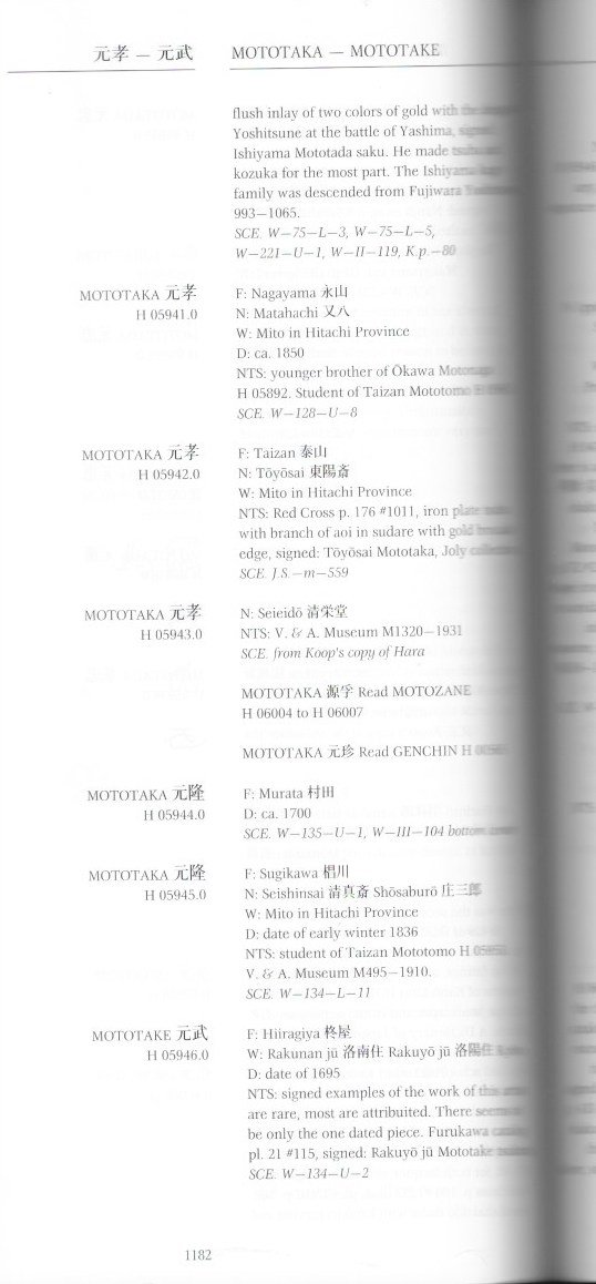

Kurikata Posted August 10, 2020 Report Posted August 10, 2020 Surprisingly, Haynes does not list any MOTOTAKA with the 珍 Kanji.... but we find 元孝 or 元鷹. But we have the Genchin guys.... Quote
Babu Posted August 10, 2020 Author Report Posted August 10, 2020 If mototaka He was the founder of the Mito school Sekijoken line. One of the four main division of Mito in Hitachi province. The son of Taizan motonori,a pupil of the Yakoya school. Lived during the last part of the 18th century and long lived. Records indicate he was a skilful copyist of the style of Nara artists, Joi, Shozui, Yasuchika Toshinaga etc. Also a teacher of great ability. His studio was crowded with pupils amongst them Takase Yeiju aka Hisanaga. Artists of this school first followed the yokoya style then turned to nara school style. Quote
Babu Posted August 10, 2020 Author Report Posted August 10, 2020 Just seen your reply Bruno. In that case it may well be Genchin or Gimei. Quote

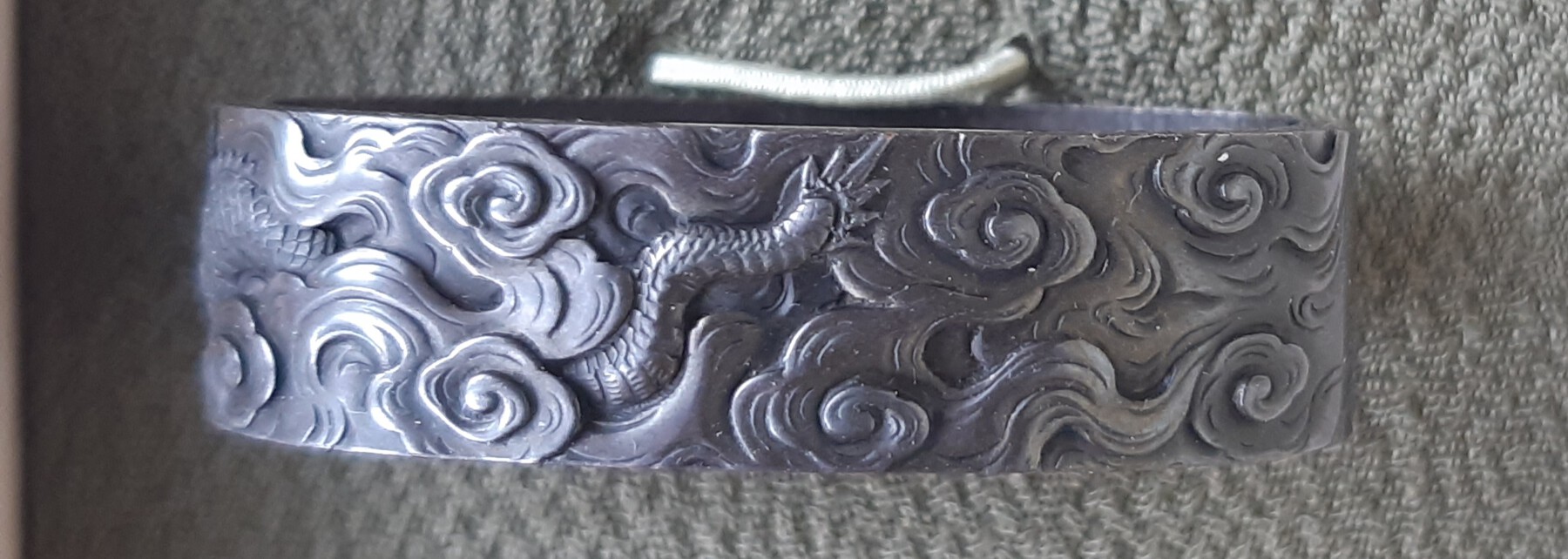

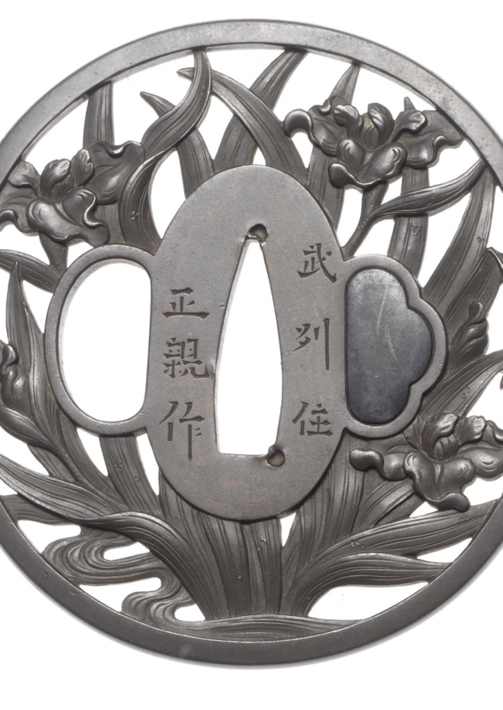

Babu Posted August 11, 2020 Author Report Posted August 11, 2020 It really does depend Dirk. As an example I have a Fuchi kashira by Masachika.Bushu-ito school ,Kitani family. John lissenden thought it was Tsuchiya Masachika aka Yasuchika.Nara School. However I found a tsuba papered by the artisan Bushu Masachika. It is IMHO the same level of skill and the same mei. It also conforms with Markus Sesko examples . So what will shinsa offer other than a document of beautiful calligraphy and a photo? This is just my opinion and I appreciate others will have different. I'm not trying to be controversial. 2 Quote
DirkO Posted August 11, 2020 Report Posted August 11, 2020 Well, with some luck the paper will say Masachika (Bushu Ito). It will confirm your own findings and - which I was alluding to - provide peace of mind and certainty to a future owner should you choose to let it go at one point. Obviously papering for commercial reasons only makes sense from a certain price point, the other reasons for papering being educational to confirm your findings, or shed light on doubtful mei,... Quote
Babu Posted August 11, 2020 Author Report Posted August 11, 2020 But in your opinion do you think the example I've posted is in any doubt? This is the point I'm trying to make. Would you even consider that a shinsa would pink slip this fuchi kashira? If they did, wouldn't you challenge them (if that were possible) based on what you see here? Quote

Babu Posted August 14, 2020 Author Report Posted August 14, 2020 Swords and tosogu are very different beasties. If a sword does not conform to a specific smith it will if signed be pinked. Tosogu cannot be judged so critically as an artisan can offer many styles of workmanship. The above Fuchi-kashira and tsuba by Masachika are identical in style of workmanship and quality of the work. I have no doubt it is by the same person. Only my lack of photography skill let's it down. Quote
Tanto54 Posted August 14, 2020 Report Posted August 14, 2020 Hey Adam, that dragon Fuchi is very nice, but as discussed, it is probably not a pair with the Kashira that you have. Quote
Babu Posted August 14, 2020 Author Report Posted August 14, 2020 Thank you George. I appreciate your opinion you are indeed a very valuable asset to the community and I say that from the heart. They are still not for sale but thank you for your offer. I can only go on the data provided on the collector ”cards” which I am slowly adding to my own way of recording this old data. Both came off a tsuka that was collected by WA Young in 1922. ”Lone tsuka (for uchigatana or wakizashi) no menuki. Ito is jabarra and looks significantly degraded. Samegawa:coloured shark skin Fuchi of a dragon signed Masachika Kashira of a plum tree (Ume) partially in decay possibly by the same artist though stylistically different, similarities are noted and discussed. Probably a special order set." The connection was established as this and similar themes of dragons and Ume as a connection: The sleeping Dragon plum tree Tokyo The Crouching dragon plum tree at Kameido. Etc This does mean that you could be right. However the metropolitan museum has a set with this kashira but an altogether different and highly suspicious Fuchi which is no match in style or IMHO theme. This is because I believe it's believed theme is the three friends of winter. This should then be featuring pine,matsu 松, plum,ume 梅, and bamboo,take 竹; all of which retain their vigor during cold weather. The pine was associated with chastity, the bamboo with uprightness, and the plum with purity and renewal. However I caution that the metropolitan museum piece is again stylistically different and executed thus: Tsuchi-me-ji (hammered surface) with usu-shishiai-bori or usuniku-bori.(low relief carving) There is no reference to the pine on either piece I noted when I saw them. So there are two extent examples of this kashira and two different Fuchi. Yet which is correct, if indeed any? Regards Adam Quote
Tanto54 Posted August 15, 2020 Report Posted August 15, 2020 Thanks Adam, just to clarify, my statement of interest in this Fuchigashira was made a long time ago in relation to another thread before I had seen the supposedly matching Kashira. Just like here, in that earlier thread you posted a picture of the Fuchi without the Kashira... (why do you keep doing that??? Why not post pictures of the Fuchi and Kashira together?) Now that I've seen the Kashira, I wouldn't be interested in them as as set (but would be interested in the dragon as an orphan - it is really good - I mean that sincerely). In this thread, you asked Dirk why should you bother with papers for this set of Fuchigashira. Well, papers would give you an authoritative answer (but I'm fairly certain that they won't paper by the NBTHK as a set - as mentioned before, the quality, motif, style, carving, chisel marks and alloys do not match). Quote
Babu Posted August 15, 2020 Author Report Posted August 15, 2020 The offer was made July 29th so two weeks ago, but be that as it may you have not seen the two together so I'd be concerned your making a few assumptions based on what you think you can see in one bad image I provided . If John lissenden and WA Young were happy, then I will leave it at that for now. I'll take on board what you say though and investigate further thank you. Still be that as it may we are off thread and you're clearly, from your PM's and responses to posts in which I comment, now intent on disruption and discredit. You seem to be ignoring your own PM'd advice George. That could, if I didn't know you better, make you a hypocrite. Therefore don't trouble yourself any more, you do not need to comment on my posts or indeed anything I say in other posts. This way you will reduce your stress levels and you should enjoy the forum more. So my advice is Enjoy the forum, enjoy life as none of us know how long we have , But please from now on refrain from commenting in my posts. Thank you and God bless Adam. Quote
