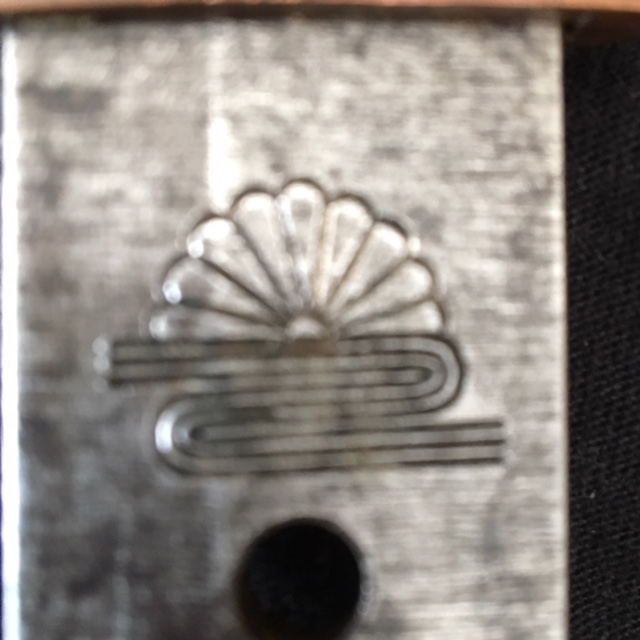

Here are some pictures of my Minatogawa. It has a lacquer scabbard and canvas tsuka covering instead of same. Any comments are welcome.
Thank you all in advance.
Tom
Tom,  the mon on the nakago looks worrisome to me.
Yes Dave, I also noticed the kikusui was hand cut. This sword was in a collection since the mid 80’s that I know for sure. I sure hope they weren’t faking Minatogawa’s back then.
Tom

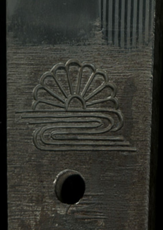

The habaki does not have 3 continuous lines. From the top, lines #3 and #5 are not attached, do not look to be continuous as they are in Neil's picture.
Tom, I asked for an enlargement of the kikusui mon, as Dave points out it is cut wrongly, and there if definitely alarm bells ringing for my eyes. And yes, there are forgeries out there, and have been for years.
For potential Minatogawa owners, just ensure the Kikusui mon on the habaki and nakago match. If not would be like buying s Ferrari with a prancing horse badge on the front, and a donkey badge on the steering wheel.

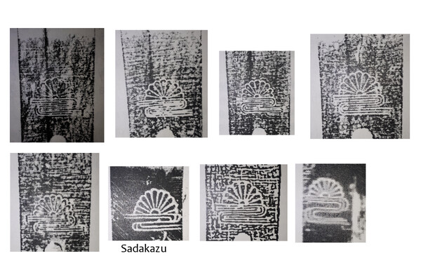

Neil the mon can be different. I dont think it is a true sign to compare. Better it is to compare the mei? What you think?
Chris, I think you're right.  Wish I had Wallinger's book.  Curious how many variations of the Kikusui mon are shown in it.
Edit:  Presuming the Minatogawa smiths made blades outside of the shrine, and used the same signature, then I think you have to look at both the signature and the mon.  I would expect the faker's to be looking for genuine Masa_ _ _ _  blades w/o the mon, and adding it in order to up the value.
I take a look later in the book but i remember that there a not many mon to see. He was more concentrating on the mei.
These are all the Mon from Minatogawa in Herman Wallingas Book
I hope that helps.
You see that every mon has its own style and it is not uniform.
Yep. Thanks Chris!  There's always going to be a little variation, but there's more than I expected.  I would have been skeptical of the Sadakazu, due to the extra petals.  It's just my nature  :dunno: I'm liking Tom's mon now  :thumbsup:.

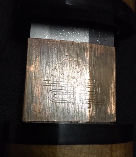

Tom, take a forensic close up look at yours, it is not cut but a collection of semi circular punches that don't line up and overlap. Of course there are variations of cut mei, but not to my knowledge not made by a tool from the hardware store. That's why I wanted a close up before judgement.
Hello:
Having known Herman Wallinga well and sharing his interest in Minatogawa, and having contributed a thing or two to his now scarce publicat-
ion, I can assure all that the Kikusui mon are individually cut, however variation should not be substantial. They are wonderful "treasures" to own.
