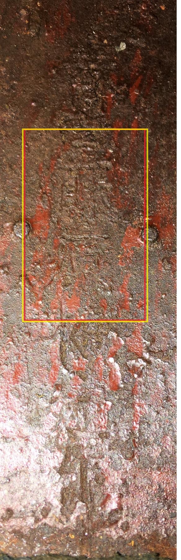

Higo-san Posted September 3, 2017 Report Posted September 3, 2017 Dear all, does someone have a comprehensive list of Haruta katchushi? I am looking for a katchushi who signed "春田藤原 ?? 作" (Haruta Fujiwara ?? Saku); the smith's name is almost impossible to read: the first kanji could be 利 and the second Kanji could be 光. I have attached a picture of the helmet (does not make much sense to post more pictures of the mei as you will not be able to recognize anything...). Thanks a lot for your help, Chris Quote

Higo-san Posted September 4, 2017 Author Report Posted September 4, 2017 Christian, I have already made a similar request on the The Samurai Armour Forum by Dave Thatcher. There are many kind and helpful people there (as there are many kind and helpful people on this forum). However, a comprehensive list of katchushi by one specific school is not something that can easily be found. Therefore, I am trying to adress as many collectors as possible including the 1-2% and the exceptions you are referring to in your post, Christian, who read the "katchu" section of this forum. Concerning my request: The first Kanji could also be Kazu or Masa (和). I have tried to make a sketch of the second Kanji based on what is visible under different angles and light. Based on my sketch, Mitsu now seems rather unlikely (however, one can never be sure because it is difficult to differentiate between rust spots and tagane marks). If there was some kind of list, I could try and narrow down the many options. Kind regards, Chris Quote
SteveM Posted September 4, 2017 Report Posted September 4, 2017 I don't know about Haruta or Kazu, but I think its a fairly safe bet that the kanji in the square are Fujiwara 藤原 Quote
Higo-san Posted September 4, 2017 Author Report Posted September 4, 2017 Thanks, Steve. That is correct. And the Kanji above Fujiwara read 春田 (Haruta). The next Kanji could be Kazu/Masa or Toshi. The last Kanji is definitely Saku. 1 Quote

uwe Posted September 4, 2017 Report Posted September 4, 2017 As mentioned at the SAF Chris. I could not find an Haruta smith, who was signing in this combination "春田藤原....." Quote
Shugyosha Posted September 4, 2017 Report Posted September 4, 2017 I've had a look through Shin Kachushi Meikan and drew the same conclusion as Uwe. Quote
Higo-san Posted September 4, 2017 Author Report Posted September 4, 2017 Thank you both - perhaps I have to accept that the Mei has become unreadable over time. Quote

Anthony de Vos Posted September 9, 2017 Report Posted September 9, 2017 Hi! This one? https://www.jauce.com/auction/c615598623 Mei; Ietsugu Fujiwara, a Haruta smith from Nara. AdV Quote
uwe Posted September 9, 2017 Report Posted September 9, 2017 Hi! This one? https://www.jauce.com/auction/c615598623 Mei; Ietsugu Fujiwara, a Haruta smith from Nara. AdV But he signed "Yamato no Kami........" Quote
Anthony de Vos Posted September 9, 2017 Report Posted September 9, 2017 Hi! Do you mean my example from Yahoo, Uwe? Can you read the whole mei on that one? Anthony Quote
uwe Posted September 9, 2017 Report Posted September 9, 2017 Yes Anthony! The mei reads "Yamato no Kami Fujiwara Ietsugu" (大和守藤原家次) Quote
