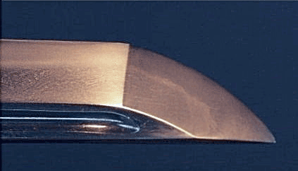

AndreasU Posted December 16, 2007 Report Posted December 16, 2007 First to the sword: I would not buy it. "Belly feeling" Kissaki seems reshaped and not symmetrical anymore. Yokote is set on the worng point and differs from the left to the right side. on the pictures it looks like that tha Ha in the hamachie area is "facing inward" (don't know a better word for it in english, concav?) if not the sowrd will have a "funny" funbari..... Noticed that there is no total picture of the sword? Now the last statement to paul's reply: "4. ~~~~~ To write off names and go with gut feel is rather arrogant and an excuse for not taking the time or making the effort to study. As an individual one is perfectly entitled to do this. To recommend it as an approach is I think rather misguided." I agree only if I would be interested to collect with the target to collect "important" names....... I prefer to collect good preserved swords. That can mean that sooner or later I have to go the way you describe but I don't see that necessarily! Proof me wrong but there are excellent "Mumei" swords out there? I bought "The connoisseur's Book of Japanese Swords" last week at Amazon for a bargain of US$ 44,95, and will study now some more detailed. Maybe I get enlightened and will follow your approach later Quote

Martin Posted December 16, 2007 Report Posted December 16, 2007 Kissaki seems reshaped and not symmetrical anymore. Yokote is set on the worng point and differs from the left to the right side. Hi Andreas, I rotated & twisted the Ura side of the Kissaki and placed it on top of the Omote side. Then I lowered the opactity of the upper picture. I cannot really make out a big difference in the placement of the Yokote... Quote

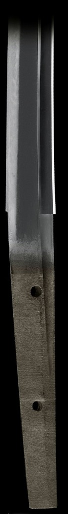

Paul Martin Posted December 16, 2007 Report Posted December 16, 2007 The pics are not of the best quality, but if you look closely at the nakago omote (katana), you will see that the yasurime between the two ana are not consistent with the rest of the nakago. Also the width of the hi in that area changes. Taking this into consideration, I would say that the mei has been removed and it is trying to pretend to be osuriage. Not uncommon. also both sides are in a similar condition width of the hi etc. The condition of the nakago of a well carried out suriage procedure on top blades is different due to the proper suriage process. Best Quote

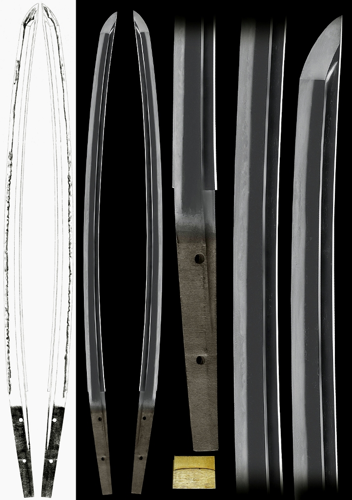

Jean Posted December 16, 2007 Report Posted December 16, 2007 Talking about healthiness of kamakura blades, I must confess there are a lot of swords incredibly healthy - and shame on us, we , European, have not the equivalent. Here are some shots of my Kamakura Enju Quote
Jacques Posted December 16, 2007 Report Posted December 16, 2007 hi, Jean Is your blade papered? Quote
Jean Posted December 17, 2007 Report Posted December 17, 2007 Hi Jacques, All the blades I buy are papered (at hozon - to confirm an attribution), then I ask to see if Tanobe sensei agrees to put a sayagaki on the shirasaya. He was very pleased with this one (so Zenon), He states in his sayagaki that the blade is late Kamakura. I would placed early 14th century as the famous Enju Shira Keru (turbid white Hada) is not present - Very/Very Raï looking. Quote
Jean Posted December 17, 2007 Report Posted December 17, 2007 Just a precision : " I would placed early 14th century as the famous Enju Shira Keru (turbid white Hada) is not present" Shira Keru is a main kantei for Enju swords but for the first smiths generation who remain very close to Rai style, other kantei points have been already mentioned , kaeri, boshi ... You will see on Aoi Art website in the Sale section a Juyo Enju, with some kantei points which are pointed out . It is an early Enju sword and there is no Shira Keru. As in some schools (Naoe Shizu ..), the quality of Kamakura Enju smiths is very high and homogeneous so it is very difficult to have a particular smith pinpointed in a kantei. On Nihonto Andy Quirt site (Nihonto.us), there is a Yamato Kaneuji Juyo blade and a letter from Homma Junji Sensei discussing this sword and the difficulty of kantei (last paragraph)..... Quote

paulb Posted December 17, 2007 Report Posted December 17, 2007 Jean, thank you for posting the images of your Enju blade. I think it clearly demonstrates that Kamakura period blades can be and in may cases are very healthy. I think the problem is that until very recently most of the early swords seen in the west were tired and of variable quality. With the openning of the market many better quality swords are now finding their way in to western collections and we are taken by surprise when we see how well preserved they are. I think it says a great deal for a sword that it has been so highly regarded and cared for over so many centuries. Quote
