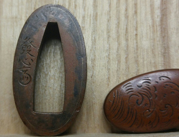

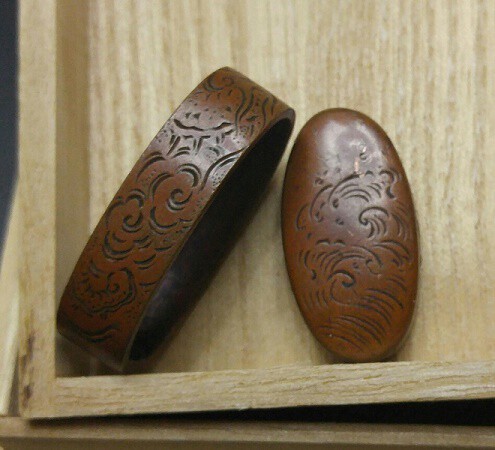

Stephen Posted December 10, 2015 Report Posted December 10, 2015 Got the two orphans today and very happy with the close match, even more so with Dgarbutt fuchi having a mei, i need help with the first kanji something shin? kao 2 Quote
John A Stuart Posted December 10, 2015 Report Posted December 10, 2015 發心 Hatsushin. ?? John 1 Quote
k morita Posted December 11, 2015 Report Posted December 11, 2015 Hi, The mei says "Ho'shinsai" (發心斎). Quote
Stephen Posted December 11, 2015 Author Report Posted December 11, 2015 Thank you Morita san, so des not a kao...Hai Domo!! Quote
Stephen Posted December 11, 2015 Author Report Posted December 11, 2015 googled kanji and markus's book toso-kinko, came Hatsushinsai page 290 Quote
John A Stuart Posted December 11, 2015 Report Posted December 11, 2015 I saw the Hatsushinsai and had thought it was a kao as well hence my ?? Makes sense though now as Morita san indicates. John Quote
TETSUGENDO Posted December 11, 2015 Report Posted December 11, 2015 Stephen, Patina match is great. You have got the Sea and the Sky - all you need now are Mt.Fuji or dragon menuki and all is complete. Steven K Quote
Greg F Posted December 11, 2015 Report Posted December 11, 2015 Hard to get a better match than that Stephen! Greg Quote

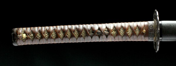

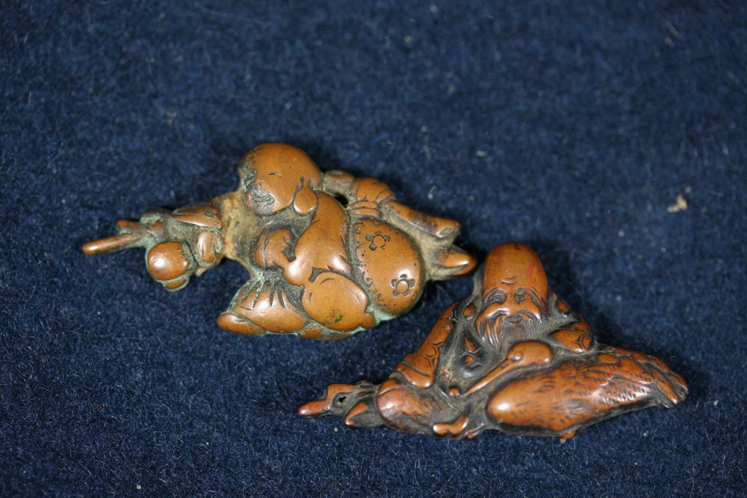

Stephen Posted December 11, 2015 Author Report Posted December 11, 2015 Thanks Greg and Steven Dragon will be on tsuba, flash lightens the copper, patina is same as F/K (thanks Ford) sages for menuki would like a ito like this if possible 1 Quote
Greg F Posted December 18, 2015 Report Posted December 18, 2015 That will all look sweet together Stephen. That ito is very attractive, big nodules on the ray skin always compliment a nice wrap. Hope to see it all together. Allthe best. Greg 1 Quote
