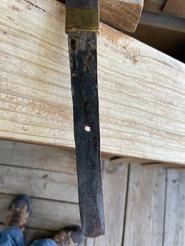

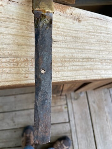

The fuchi-gashira are not standard WWII Japanese military pattern. The handle has been rewrapped and incorrectly placed two menuki on one side of the tsuka. The tsuba looks a bit thick. I am guessing this may be a non-Japanese made item. Show us pictures of the blade and nakago to be sure...

First up please sign your posts with at least a first name, (board rules). We need to see pictures of the rest of the sword to be certain but at the moment there are some question marks. The mounts are not shingunto mounts, the hilt wrap is certainly wrong and the tsuba is also doubtful. If you can find it there should be a mekugi, (bamboo peg) under the hjilt wrap at some point. This should push out though you may have to struggle a bit. When this is free the sword should come out of the nakago, can't resist saying that you need to be careful at this point. The decorative motif, which I assume you refer to as the markings, has no connection with anything railway oriented I'm afraid.
A picture of the blade overall and of the nakago with any markings, as well as overall shots of the whole sword will allow people to give you the lowdown.

We do need to see the tang though, and also some pics of the blade. Then we can tell for sure.

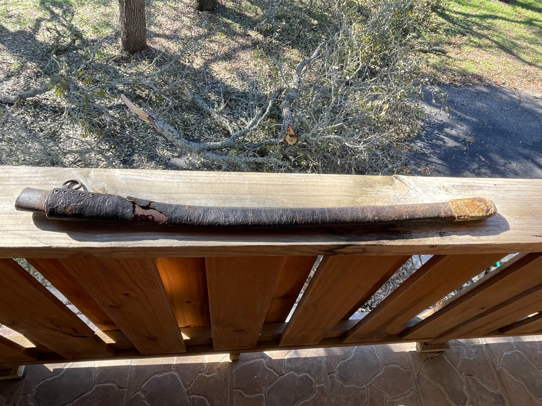

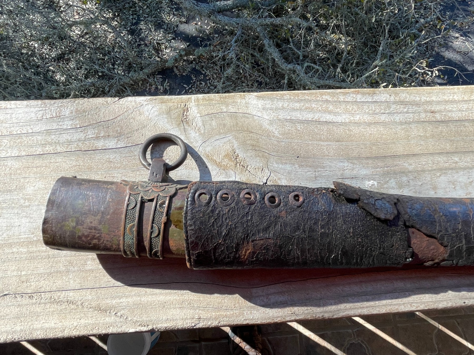

Hi Dale, I think these fitting were intended for use on swords used by the Chines puppet government(s).  Some fittings appear to have been made in Japan while others were made in China.  A rather obscure subject but worthy of scholarly research.  Here are some more examples for your edification.

At the end of the war, the 1st Marine Division, the same division mentioned in the OP, was sent to North China.  As a result, here in the United States, we have a good sampling of Chinese weapons courtesy of these marines.  These weapons range from old Imperial Chinese to recent Japanese and Collaboration Government production.  Sadly, the "forum" experts cry fake every opportunity they have when they see them!
