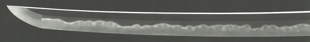

Bugyotsuji Posted July 21, 2025 Report Posted July 21, 2025 This is the same blade but opposite sides. Hadori/Kesho to Sashikomi. PS Although Mumei, and papered to Sue Bizen Sukesada, many have suggested this is a blade by Yosozaemon Sukesada. From To 3 3 Quote
Dereks Posted July 21, 2025 Report Posted July 21, 2025 Wow, thank you very much! @Bugyotsuji Sashikomi definitely speaks to me.. 1 Quote
Lewis B Posted July 21, 2025 Report Posted July 21, 2025 The differences are quite pronounced. Its clear one must choose carefully. Which style was the togishi championing? 1 Quote
