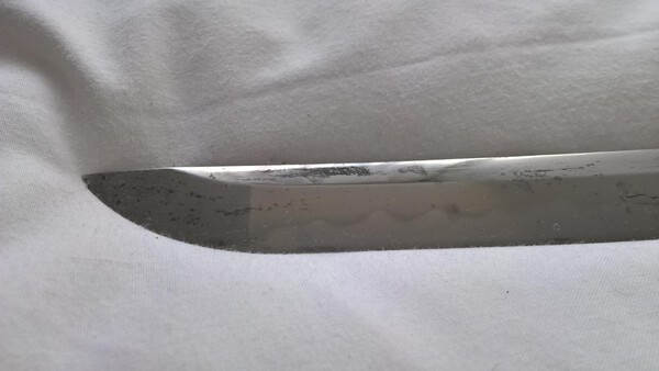

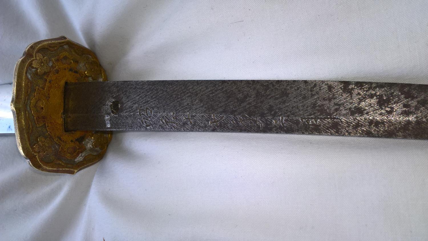

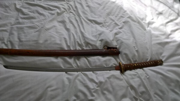

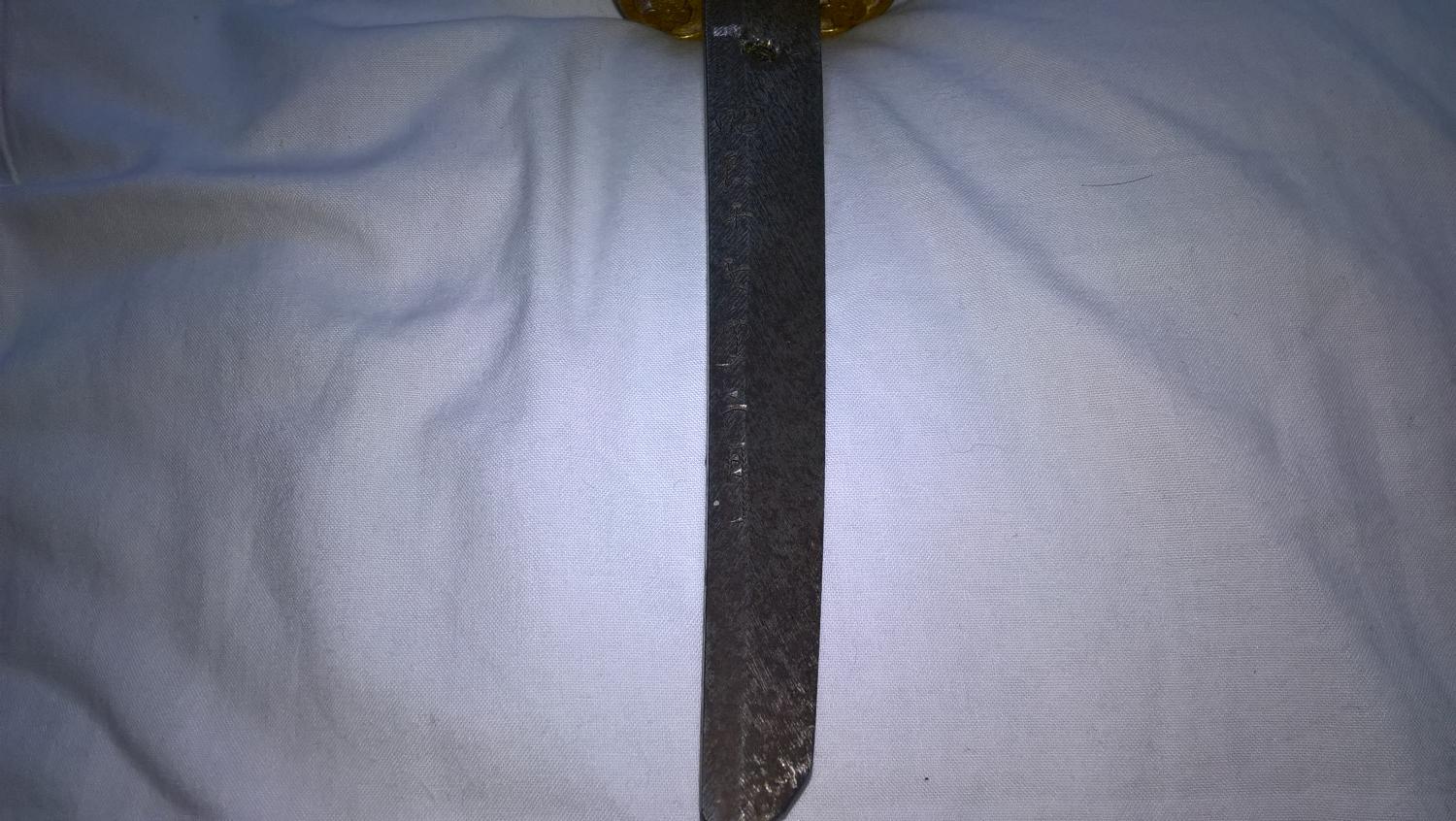

From the research I've been doing online, it looks every inch to be a shin gunto, but I was just wondering if anyone would be able to tell how and maybe even where it was made, e.g. machine made, or partially hand forged, etc. It's got a hamon, but not much evidence of hada and stamps on each side of the tang, although they're pretty difficult to make out.
I've posted a few pics here (sorry about the quality).  If anyone would be happy to take a look, that would be brilliant.

You're sword is a pretty standard example of a 98. I'd not say there were millions made! More NCO swords were made than officers swords, and there were only a few hundred thousand, give or take. Even so, very prolific!
Now as to the sword, I'm afraid there's not a huge amount to say. Please don't take this as an insult as it is merely a statement of fact, but the sword is in cheaper mounting. While It’s a little debatable, this could mean a later war sword, or more likely the officer was not able to afford a high end sword, since officers purchase their own.
The solid cast tsuba (hand guard) and field saya (scabbard) are the less expensive alternatives. The fuchi (collar before tsuba) appears to be the unadorned dot type, the sarute (tassle ring) plain wire one.
Under the leather cover, is the saya fairly crude black painted? The sword fits with some I have seen that have a sticker on the saya too, so worth a look if you can.

The leather cover is not in great condition and the saya underneath is painted black, and that's flaking off and splitting a bit.  And there is also some kind of sticker.  It's a sliver covered, roughly star-shaped sticker on the saya.  It's located near the top of the saya, just where the button fastener (excuse my lack of knowledge of the proper terminology here) was.  I say "was" because the fastener has disappeared along with half of the thumb strap that would have secured the saya.
I'm absolutely cool about the appraisal of the mountings, and the whole sword.  I reckoned it was not a traditionally made nihonto or gendaito and the mountings, and probably the blade itself, were likely to be of the lower cost and more factory-made variety, so I really appreciate what you're saying.

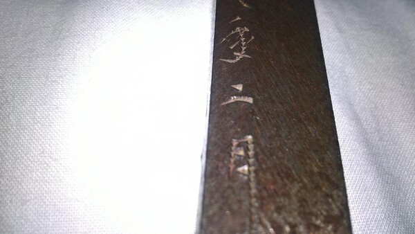

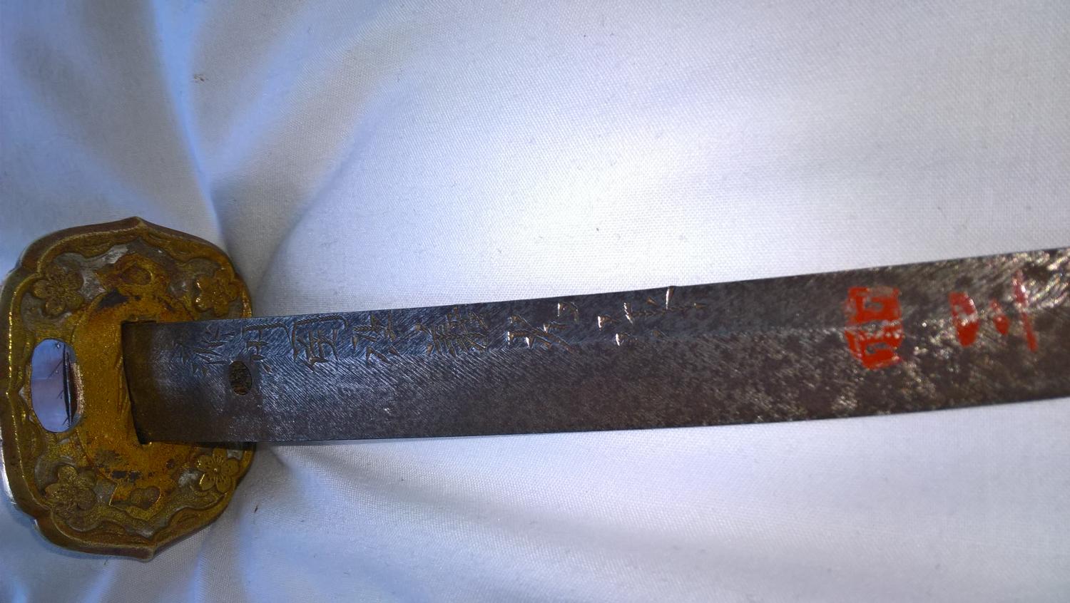

I think the date is 1942
昭和十七年二
Shōwa 17 (1942) February
The angle of the photo puts the two characters in blue in a bit of a dead spot, where the relief of the engraving gets lost in the rough texture of the steel. A different angle might remove all doubt as to those two characters.

I've taken another photo of the date and the signature (this time hopefully the photo has attached the right way up).
It's still difficult to make out from the photo but looking at the nakago up close, I think you're absolutely right

Here are another two photos of the date.  I've had to take two photos to get a good close up, with the first 4 characters from top to bottom in the first close up, and the three bottom characters in the second photo.
昭和十七年二
Steve, you're right, I didn't feel right about my '45 date.
