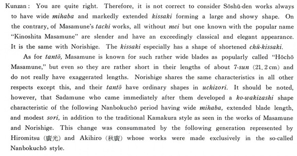

Anyway this is why Kanzan wrote that "Masamune, Norishige, Yukimitsu, these are three ways of saying the same thing." (paraphrased).
Attribution is the first part of quality appraisal and getting it into the right arena is the key thing, not because we have a time machine and can verify anything specifically, but because you need to be evaluating quality and putting it to a smith with the right quality reputation. A big huge Soshu style suriage tachi of excellent quality has to go to a smith with a reputation for that quality and the style. When you deal with such a blade, it can't go to Hiromitsu or Akihiro because of the very few signed examples (i.e. one, and half the signature is gone), so they won't do that. But maybe mixed into the Hasebe and Sadamune attributed blades are some Akihiro and Hiromitsu. But it's not a good answer to name them because of no verified examples other than the one.
And with that one, pre-NBTHK some people thought it to be Sadamune. The NBTHK couldn't possibly attribute it to Sadamune with only half the signature on it and declare it to be the only signed work of Sadamune, so they have to put it to a more acceptable answer with Hiromitsu.
Getting back to Kanzan, with Norishige, Yukimitsu and Masamune, each has habits that would let us put a blade to one of the three. Lots of Matsukawa hada, go to Norishige. Absolute top quality, to Masamune. More classical or even in Awataguchi/Shintogo style, go to Yukimitsu. But there is a zone where the three smiths overlap and an answer to any of them could be correct.
