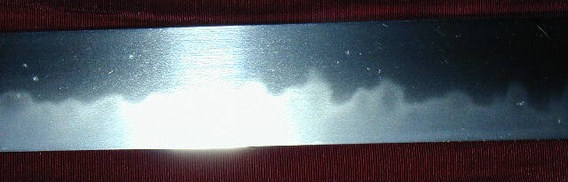

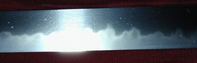

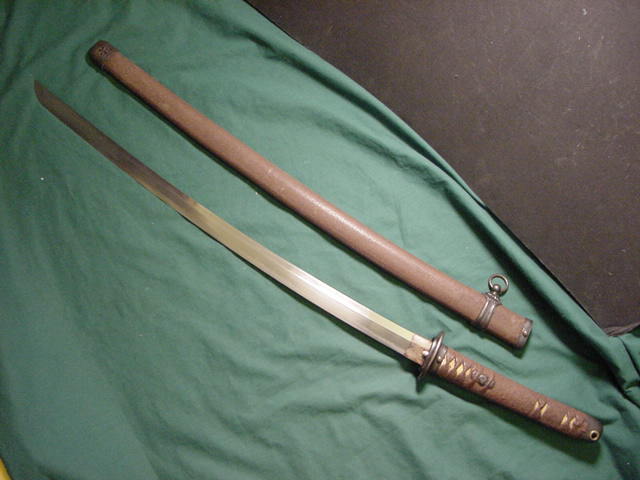

Here is a pic of Munetoshi's gonome/choji ba...he is described as working in Bizen den primarily, but I have also got one by him in ko-midare of ko-gonome with some nijuba. As Chris says, these turn up reasonably often.

The two blades posted above would benefit greatly from a good polish, the Ota blade in particular. He was a top rate smith. I have a blade by him that fooled a lot of people at shinsa. Most thought it was a shinshinto by a variety of Koyama Munetsugu school smiths.
Nice to see some good gendaito here.....
You are so right about the wartime polish Chris...although I tend to leave as found, scratches and all, I must say that the Yamagami bros polisher was a bit below par...these two swords of mine both have the most undulating finish of all gendaito in wartime polish I have seen (too much sake???).

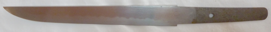

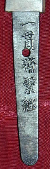

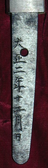

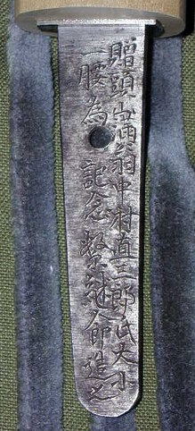

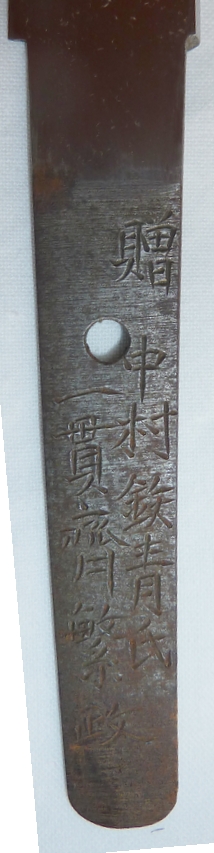

Here is a pair of Kasama Shigetsugu tanto in the Bizen den. The first was made for a wedding ceremony and is an early work from Taisho. It is quite small but the quality is excellent. The second was ordered by Kasama's patron, the famous right winger Toyama Mitsuru, as what appears to be part of a daisho, for a man named Nakamura Naosaburo, whom I believe was a wealthy industrialist and chief stockholder of the Eastern Manchurian Railway. It is a later work, done in Showa 13, and made at Toyama's estate in Tokiwamatsu. It has horimono on both omote and ura, which Kasama was known for. Note the attention paid to the quality of finish on the nakako and mei....In my opinion, this is a benchmark for early Showa work and what we as collectors should be looking for..

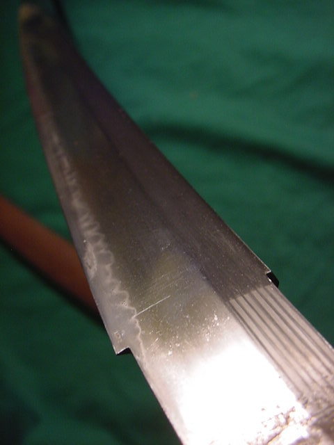

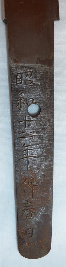

Here is another tanto in Bizen den by Kasama student Sakai Shigemasa. He is one of the so-called three "birds" trained by Kasama (the others are Miyaguchi Yasuhiro and Tsukamoto Okimasa). He didn't make a lot of swords during the war but was well known afterwards. This tanto was made for Nakamura Tetsuao, who was a well known tsuba expert and author. It is quite similar to the first tanto above made in Taisho by his teacher Shigetsugu. post-1462-1419683690617_thumb.jpgpost-1462-1419683691005_thumb.jpg

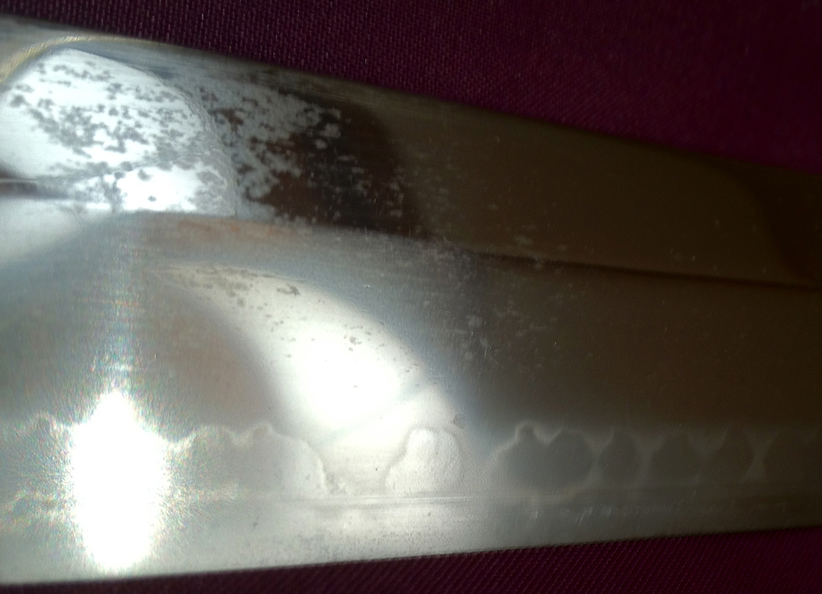

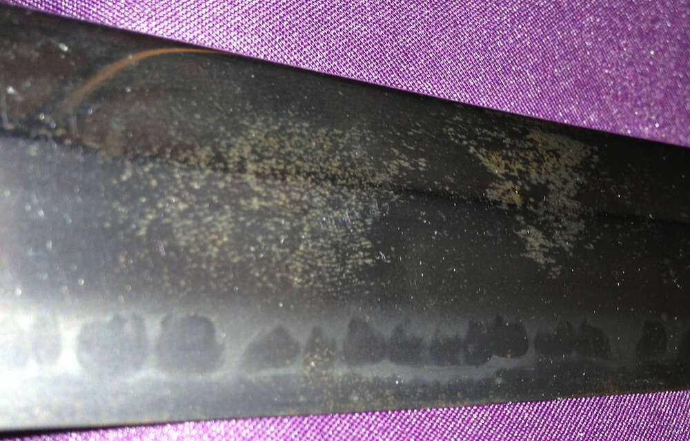

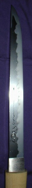

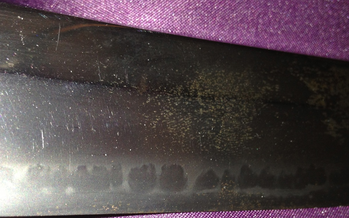

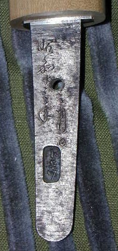

It was odd that you had mentioned Kanenobu in shoji, because I was in the process of buying one. I had an interesting surprise when I received the sword today. It is in Choji - or something like it. Take a look at the photos of the mei. What would you guys call it? It's much more like the choji nodules are riding on top of a suguha with clear definition between the two. It's clearly not a retemper, but a very interesting hamon design.
Sorry for the garbage photos.
The Kanenobu I have, is one of the founders of the Showa Seki school and Father of Niwa Kanenobu. At the Sydney Shinsa in 2009, this was chosen over a Shigetsugu I submitted as one of the best swords submitted. Unfortunately, it only recieved 70pts. This was because someone had removed the date. However Yoshikawa sensei chose this sword and commented, that it was made in the style of Bizen Kiyomitsu and that the date was probably removed to sell it as an old sword.
Sounds nice. Post some pictures.....Most of the Kiyomitsu blades I have seen were done in suguha-what style is your Kanenobu?
The date may also have been removed because the blade was a special order and the name and date were both removed. I have seen that a few times.
There were a few smiths signing Kanenobu in Seki during the war....Is yours and the one above the same smith?....Many Kasama blades were daisaku and there is quite a bit of variation in these...
