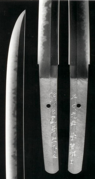

I'd like pictures of the boshi on both sides (the point/extremity of the blade with the tempered part) and of the hamachi/munemachi (The notches at the bas of the blade which is the frontier with the tang) and equally if possible one of the Hada (texture of the blade) and one of the bottom of the tang to see if has been cut.
