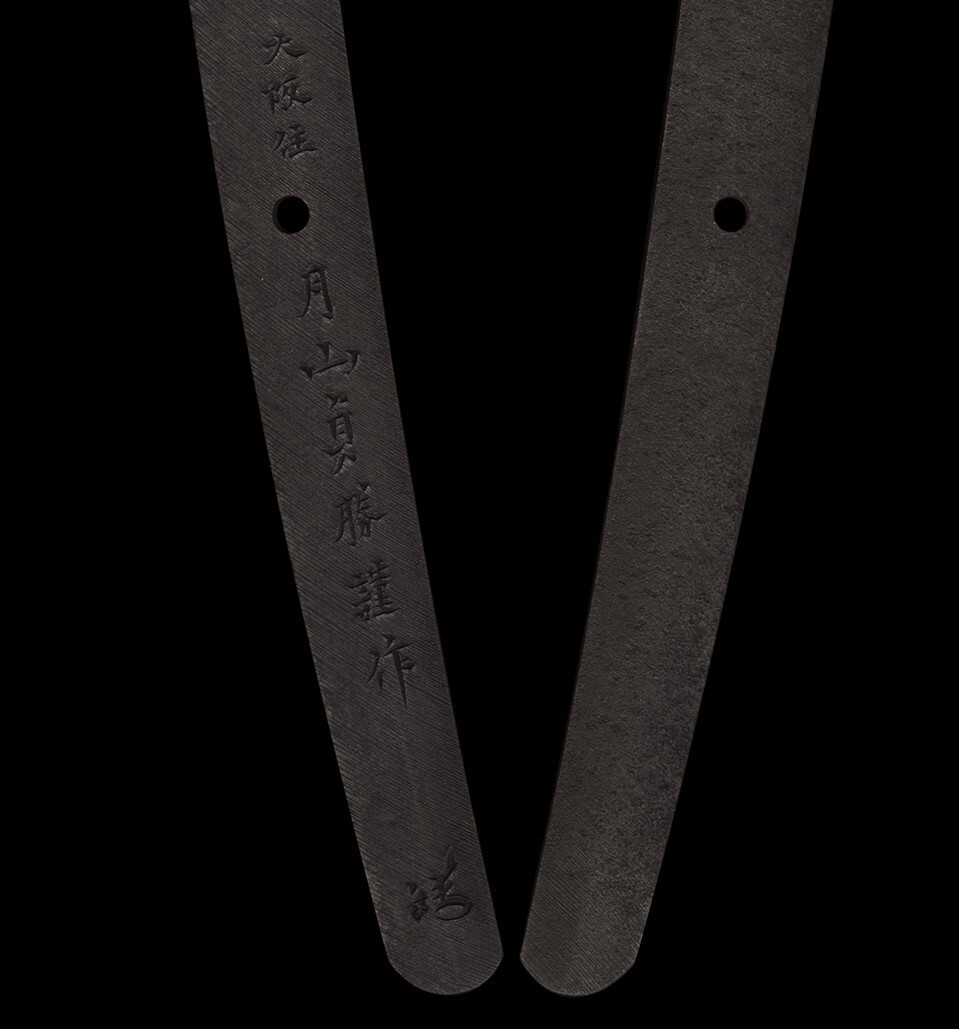

Gerry Posted Wednesday at 04:14 PM Report Posted Wednesday at 04:14 PM I'm considering purchasing this Gassan Sadakatsu katana from Aoi Art: https://www.aoijapan.com/katana-osaka-ju-gassan-sadakatsu-kinsaku-written-seal-marknbthk-tokubetsu-hozon-token/ What bothers me is that even though this blade has TH papers, the ura side of the nakago looks suspicious. Pretty much all Sadakatsu blades I've seen are dated, and this one isn't. However, if you zoom in on the ura side of the nakago, you can see faint chisel marks where the nenki used to be. Most of the Sadakatsu blades I've seen have very little to no corrosion on the nakago, whereas this sword seems to have rather pronounced corrosion only on the ura side. I'd like to know if anyone has opinions on why someone who purposely remove a nenki inscription from a perfectly good Sadakatsu blade. Quote
Ray Singer Posted Wednesday at 04:36 PM Report Posted Wednesday at 04:36 PM It may have been that someone removed the special order / dedication inscription, and the loss of the nengo (if it was there) was consequential to the special order column removal. You do see that in gendaito ocassionally, more so with commissioned shinsakuto. 9 Quote
Lewis B Posted Wednesday at 05:13 PM Report Posted Wednesday at 05:13 PM Could be the lighting making the nakago darker than in real life. Looks a little different in this image. Ask Tsurata san for a photo in natural light. 2 Quote
Gerry Posted Wednesday at 06:31 PM Author Report Posted Wednesday at 06:31 PM Hi Ray, Thanks for sharing this excellent point, and it's really a shame that however originally owned the sword chose to remove the provenance and damage the nakago. I'll just have to wait for a cleaner example to show up in the market. Quote
Bryce Posted Wednesday at 08:55 PM Report Posted Wednesday at 08:55 PM G'day Gerry, Just to back up what Ray said, I have seen this several times with Gassan Sadakatsu blades. I imagine it would have looked something like this. Cheers, Bryce 3 Quote

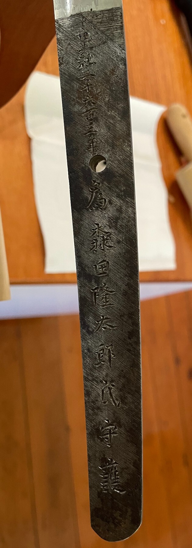

Hector Posted Friday at 06:46 AM Report Posted Friday at 06:46 AM I just obtained this shinsakuto. It's not by anyone special but the dedication to its original owner was part of what drove me to get it (that and the gorgeous choji hamon). Each to their own I suppose. 1 Quote
