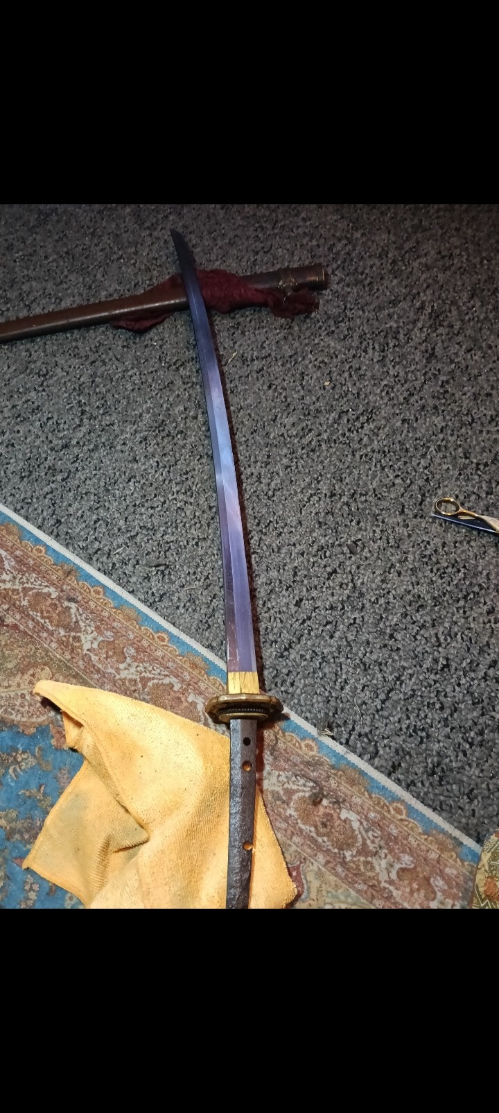

It's Been cut down I'm sure of it. I need someone else to tell me if its real I need some closure on this piece, WW2 family heirloom.. I've been on ai and went through everything in the sword it tells me it's a very very old sword 15th century owned by the Machida family which as heavy ties to older samurai family's

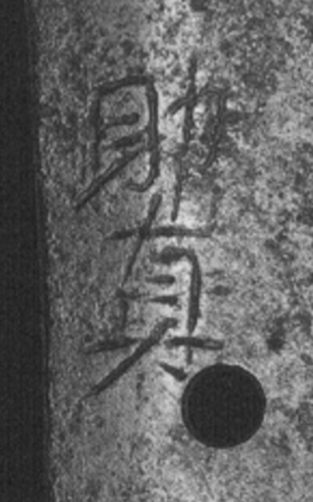

The signature looks old, but the first kanji does not appear to make sense. The best guess is that it is a "助真" (Sukezane) with a missing radical for the first character (possibly erased, damaged, or omitted by a forger). The style of the sword is not consistent with Ichimonji Sukezane, one of the foremost smiths of all time (https://nihontowatch.com/artists/sukezane-SUK460).
It could, however, based on the gentle suguha pattern be the work of Senoo Sukezane, a great and extremely scarce Bitchu province smith of the Middle Kamakura period (https://nihontowatch.com/artists/sukezane-SUK456)
This is your best candidate, as far as I can tell.

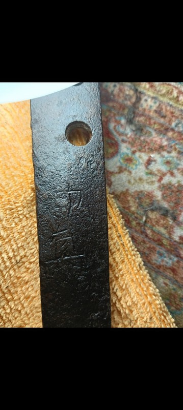

  • One of the mekugi-ana is in a meaningless position (the bottom one) - which is a sign of shenanigans (something trying to be passed off as old).
  • A radical is missing on the signature, which can be forger error - or, in the best case, a deliberate disfiguration to avoid "gift-giving" ceremonies (sword extorsion by powerful feudal families). For a sophisticated forger, it may also be an attempt at imitating disfiguration.

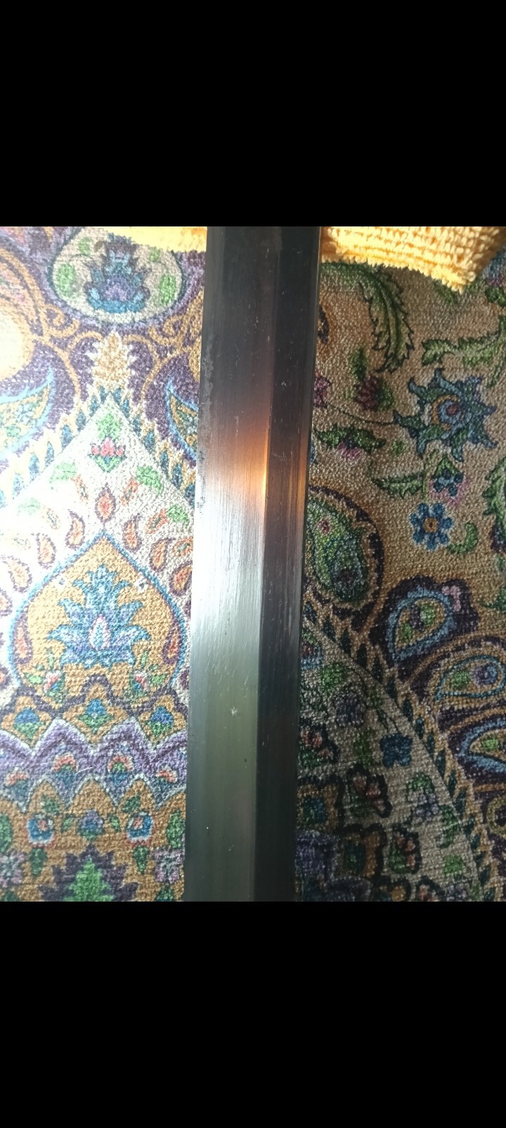

  • Someone appears to have heavily damage the area near the base of the blade causing significant and irreparable damage.
  • There is what appears to be an extended chu-kissaki or even O-kissaki (hard to discern, I can't see the shape properly on your photos), which are inconsistent with the period attribution of smiths signing Sukezane. This can also be a sign of shenanigans. This can invalidate the call.
  • The "真" character deviates significantly with the way these smiths executed the kanji although the variance is admittedly large.

For completeness, the kanji on the end of the handle do indeed read "Machida" (町田) indicating this was the name of the owner, at least during the war when the fittings were made. Machida, however, is a very common family name, and there is nothing that explicitly ties it to any famous family bearing that name. Having said that, to me it indicates the family who possessed it during the war had enough money to spend on this small customization, which is something. And it ties the sword to an actual person, even though we may not know that person's full name. So its a nice thing to have on a bit of militaria. Well, this is one of those swords that straddles the gap between militaria and antique "samurai" sword. Or, militaria and "nihonto", if you like.
In regard to Hoshi's comments above, I agree with just about everything he has written, except for this one bit which I think is highly unlikely,
Pretty hard to imagine this was a spelling error. I think the second part of that sentence is much more likely; i.e. some kind of disfiguration intended to deceive, or maybe someone started to erase the signature and either gave up, or abandoned it for some other reason. And I think the person to whom he is referring towards the end of his post is @Andrew Ickeringill, NMB member, Australia-based polisher, and occasional poster here.

This is just based on the one low quality overall picture but I do think if the sword is a bit shortened tachi as it would look like, then the 3rd hole would be the original one. To me it would seem like the upper 2 ones would be used when it has been used as a katana.
Please post more high resolution pictures of the sword, and like was said above people with knowledge in Australia would be best option for real life verification.

I would try to get good pictures. I would not focus on the signature (which is as was noted is an interesting one) - but the overall shape with good light, select couple of areas where work is visible and photograph them.

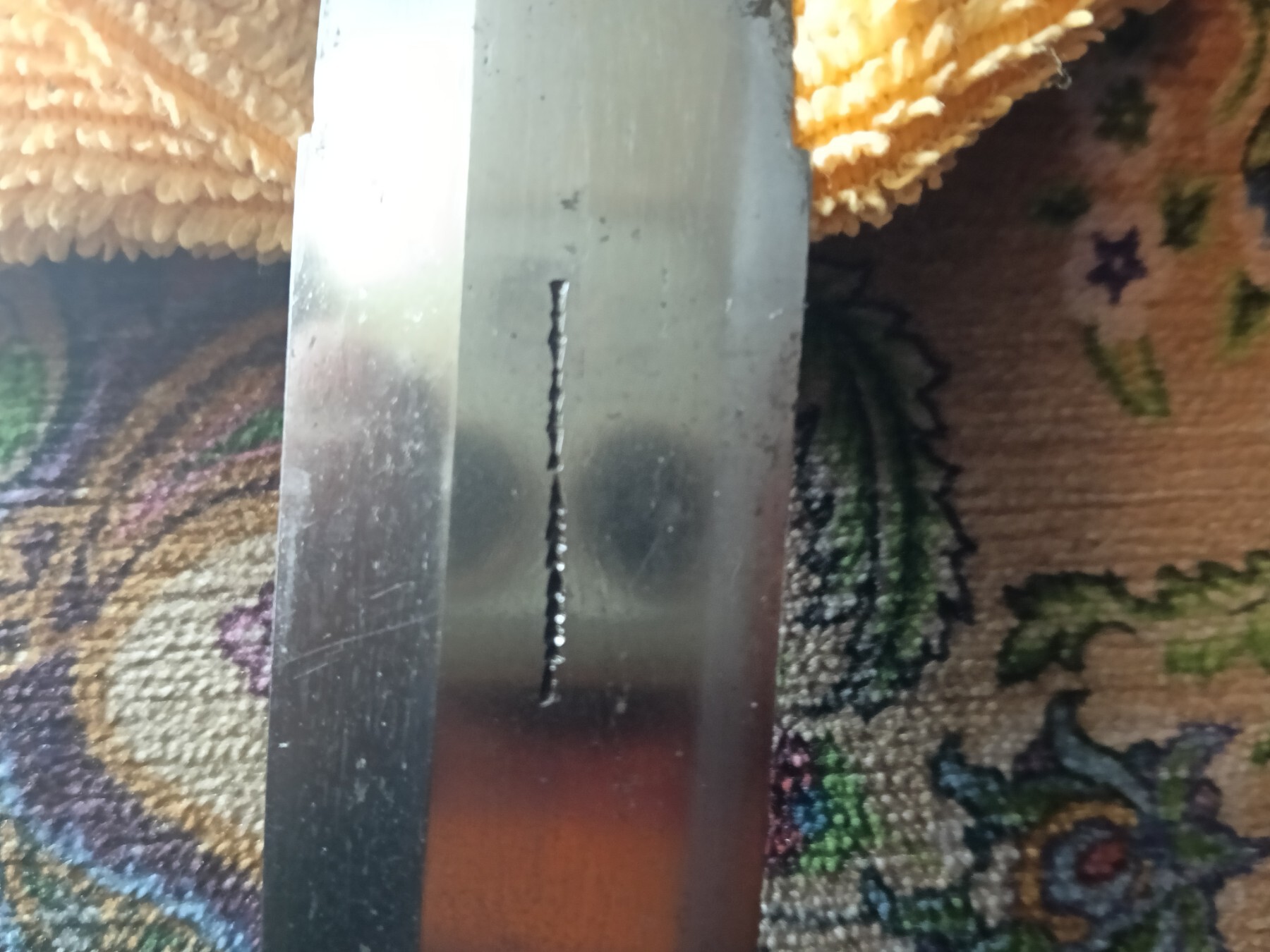

The gouge at the base of the blade is an issue, but the defect in the blade which is shown in the photo above (if I'm interpreting the photo correctly) is a potential major issue.  I have no idea what could have caused that, but if it's as deep as it looks its pretty close to irreparable, even by a skilled togishi.  Looks like a major loss of integrity in the steel, leading to loss of part of the steel.

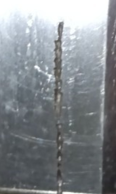

Remnants a Horimono perhaps?
Maybe a very early horimono hense the fukure the chizel mark seems to be there for a reason I believe. It doesn't look tampered or accidental

Maybe a very early horimono hence the fukure. The chisel mark seems to be there for a reason I believe. It doesn't look tampered or accidental.

Unfortunately, the chisel mark is a damage, whoever made it and for whatever reason. FUKURE and HORIMONO are genuinely not related unless a HORIMONO is executed to get rid (cosmetically) of a KIZU/FUKURE.
