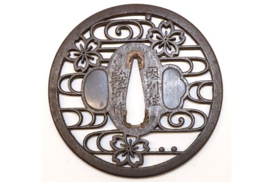

I'm looking at this tsuba at auction and I'm tring to get more info on it.
First, is it genuine? The workmanship looks good but the color is odd, might just be the lighting? The other pieces by the seller look genuine.
When was it made and what is the school? I've never seen this style before. Looks sort of french nouveau, which I like.
Hi Adam!
Wow, what an interesting and beautiful tsuba!
My opinion is that it looks genuine and it seems to be thicker in the middle then on the rim.
The motif is placed inside a sea cucumber type of tsuba design.
Looks to have been mounted on a tang at least once.
That is all I can tell you, other members will probably give you much more detail about the tsuba.
Posted (edited)
Yeah, whether or not it was mounted before is tricky because it seems like some from the meiji era were made to look that way. Not real clear on that.
Edited by Blueduck600
Spelling
Hi again Adam.
I don't know.  I don't think it is meiji era.  But it is all just a guess.
The tsuba looks intricately made by a very talented tsuba craftsman.
The sekigane (copper filler in the tang slot) looks authentic.
I all I can tell you is I think it is authentic, more than likely Edo, and I would like to have it in my collection!

Why not Meiji or later? It's true the samurai class was gone, but I've heard that a lot of interesting items were made post-Perry, as artistic inspiration was coming in from all over the world. Warrior caste demand would be down due to the political changes, but even so?
Is that wrong?
Hi George.
Like I stated before, it is all just a guess whether it is Meiji or Edo.
I refer the question to more knowledgeable individuals than I am.
Let us wait what others think and say.

Looks legit, and decent.
I would say it is more the photography, -that is just my opinion, but I've been looking at crappy photos for a very long time.
Chrysanthemums (or Sakura) on Water.
Very old and appreciated Life n Death allegory.
Chrysanthemum and flowing water is the Classical Chinese (Kiki Jido in Japanese) story, treated reverentially in Japan as the epitome of loyalty.
How could they hammer the metal inwards towards the Nakago ana without spreading it out and warp the delicate sukashi?
I have a set of F/K with the kikujido motif which I purchased specifically because of that story.
"Kikujido" has been a favorable theme since ancient times as a symbol of wishing for longevity. A beautiful child who drank water dripping from the chrysanthemum leaves that wrote the sentence and became an immortal hermit. It is said that the water flowed into the river, cured the diseases of neighboring villagers and benefited them with longevity. Recently, it has not been seen much, but the "Chuyo no Sekku" on September 9, where you wipe your body with chrysanthemum cotton and drink chrysanthemum sake to pray for good health, was once an important annual event.
Thanks for that, Calabrese! Interesting how many different ways the story was expanded.
The Kikusui (chrysanthemum + waters) crest certainly took on a life of its own in Bushi circles, becoming one of the most famous Kamon, especially for the Lord Kusunoki who is revered in Kobe’s Minatogawa Jinja.

The workmanship of the tsuba reminds me of Inshu Suruga work... I think the original kuchi-beni sekigane (lipstick style copper inserts) was knocked out from the top of the nakago-ana because you can see the sort of "horseshoe" indent that is there, which would have held the copper sekigane.
