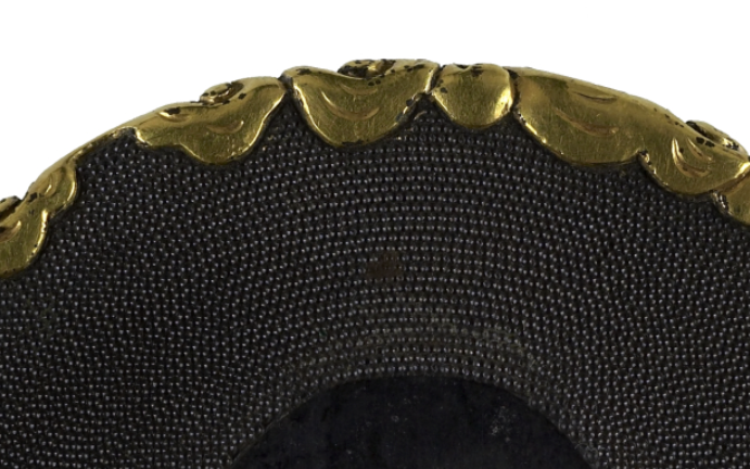

GreyVR Posted Thursday at 12:19 AM Report Posted Thursday at 12:19 AM Before anything else, I think I'm the problem here. That's why I'm posting. I'm looking for help. I was just posting something on colors in general. While looking for pictures to post, I found this Tsuba. https://www.supeinnihonto.com/product/marugata-copper-koi-nbthk-hozon/ I think the problem is in me. but I look at this texture, and I see modern machine make. Can anyone help me with this? This texture looks modern, but it seems from a number of examples that it is a historic texture. It's different from the fish egg pattern, does it have a name as well? I think perhaps the issue is that the top pattern is easy to produce by machine, but the ability to look at an object and see 'old' or 'modern' matters to me, and I seem to have a glitch in my brain on this pattern. Can anyone help? Quote

MauroP Posted Thursday at 03:52 PM Report Posted Thursday at 03:52 PM 15 hours ago, GreyVR said: It's different from the fish egg pattern, does it have a name as well? 針石目 - hari-ishime (or just ishime). PS: indeed the NBTHK paper reports suaka-ishime-ji. 1 Quote
ROKUJURO Posted Thursday at 04:15 PM Report Posted Thursday at 04:15 PM George, how do you personally define "old" and "modern" in TSUBA, and what kind of machine do you imagine to produce an ISHIME-JI (= "stone-like") texture on a TSUBA in the EDO era? Quote

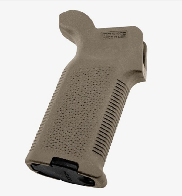

GreyVR Posted Thursday at 08:17 PM Author Report Posted Thursday at 08:17 PM 3 hours ago, ROKUJURO said: what kind of machine do you imagine to produce an ISHIME-JI (= "stone-like") texture on a TSUBA in the EDO era? Modern as in mass produced using entirely modern techniques, as opposed to the work of an individual artisan, or even a casting shop in period. IE, This one. As to how? There's lots of textures produced in metal by machine. https://tozandoshop.com/collections/fuchi-kashira/products/sakura-higo-fuchi-kashira Or by casting. In any shape you please. https://www.custommadebetter.com/products/1-8-snake-skin-clear-textured-cast-acrylic-sheets Textures of all kinds are not particularly difficult to produce, though raised dot patterns show their origin more then sunken dot patterns. any texture can be mass produced by stamping, casting, pressing, die cutting, or even a spray gun! I put the original image into google images.... but cropped to just the texture. Quote
ROKUJURO Posted Thursday at 08:24 PM Report Posted Thursday at 08:24 PM That is all new Chinese stuff which has nothing to do with your above shown 19th NBTHK HOZON TSUBA. 1 Quote

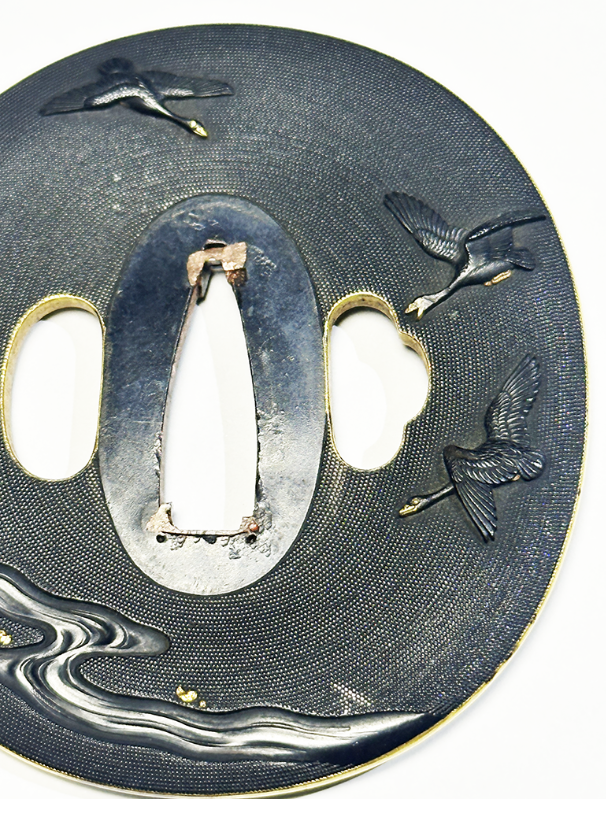

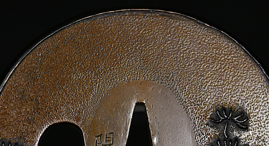

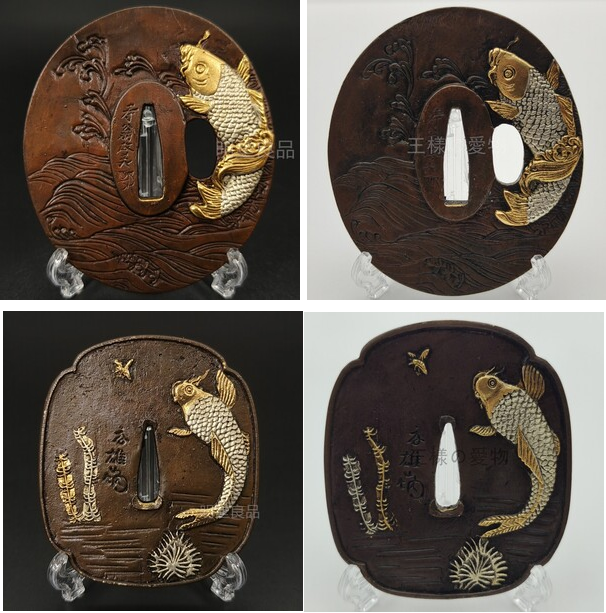

Spartancrest Posted Friday at 02:08 AM Report Posted Friday at 02:08 AM (edited) Various types of Ishime-Ji - by their very nature they tend to be "unique" Technique : Ishimeji base, Certificate :NBTHK hozon tosogu paper (Issued 24 December Reiwa 3(2021)) https://nihontocraft.com/Ko_Kinko_Tsuba_G.htm ishime ji. This tsuba dates to early - mid 1500s Tsuba with eagle searching for prey (NBTHK paper) Modern cast examples are not "unique" in that they are numbered in the hundreds if not thousands. It is a matter of finding multiple examples and comparing- I can't find another matching the Carp, but plenty of obvious fakes with a Carp theme. Edited Friday at 04:56 AM by Spartancrest typo 3 Quote
Bugyotsuji Posted Friday at 03:45 AM Report Posted Friday at 03:45 AM Spongiform encephalitis is the only expression that leaps to mind. Copper, so therefore soft, but those holes do not look like they could be reproduced with a pin or needle…(?) Besides, the elaborate bubbling or stippling stops at the edge of the seppadai, so it’s surely not part of the original overall casting process. Perhaps it’s a unique process known only to the artisan (ideal scenario!) so maybe it has no ‘official’ name, leading us to go generic with ishimeji, etc. 1 Quote

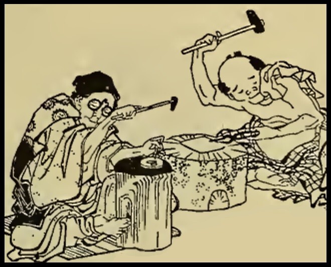

GreyVR Posted Friday at 09:52 PM Author Report Posted Friday at 09:52 PM 11 hours ago, ROKUJURO said: Ford did not say it was always done by helpers, but when the eyesight of the elderly masters diminished, it was even necessary. Ford Hallam had a digital microscope! On the topic of the 'helpers' in the old master/apprentice style systems, that isn't 'guy off the street' or 'seasonal farm help' it's 'live in students who will themselves someday be masters' as in @Curran's statement about a particular master being made to do that work when he himself was an apprentice. My mother, herself an artist and great appreciator of art, has in her jewelry collection a griffin she treasures. She bought it in Florence from a long term family business with tremendous history in the art, and talked for a long time with the patriarch. She said he told her one of the most tragic things... "Yes, just when you are starting to get really, really good at it... is when your eyes start to go." 1 Quote
Spartancrest Posted Saturday at 12:34 AM Report Posted Saturday at 12:34 AM (edited) 3 hours ago, GreyVR said: Ford Hallam had a digital microscope! The tsubako artists have had glasses for several hundred years - as shown in this Edo period woodblock - also even the Monkeys wore them! Edited Saturday at 01:37 AM by Spartancrest 1 1 Quote
