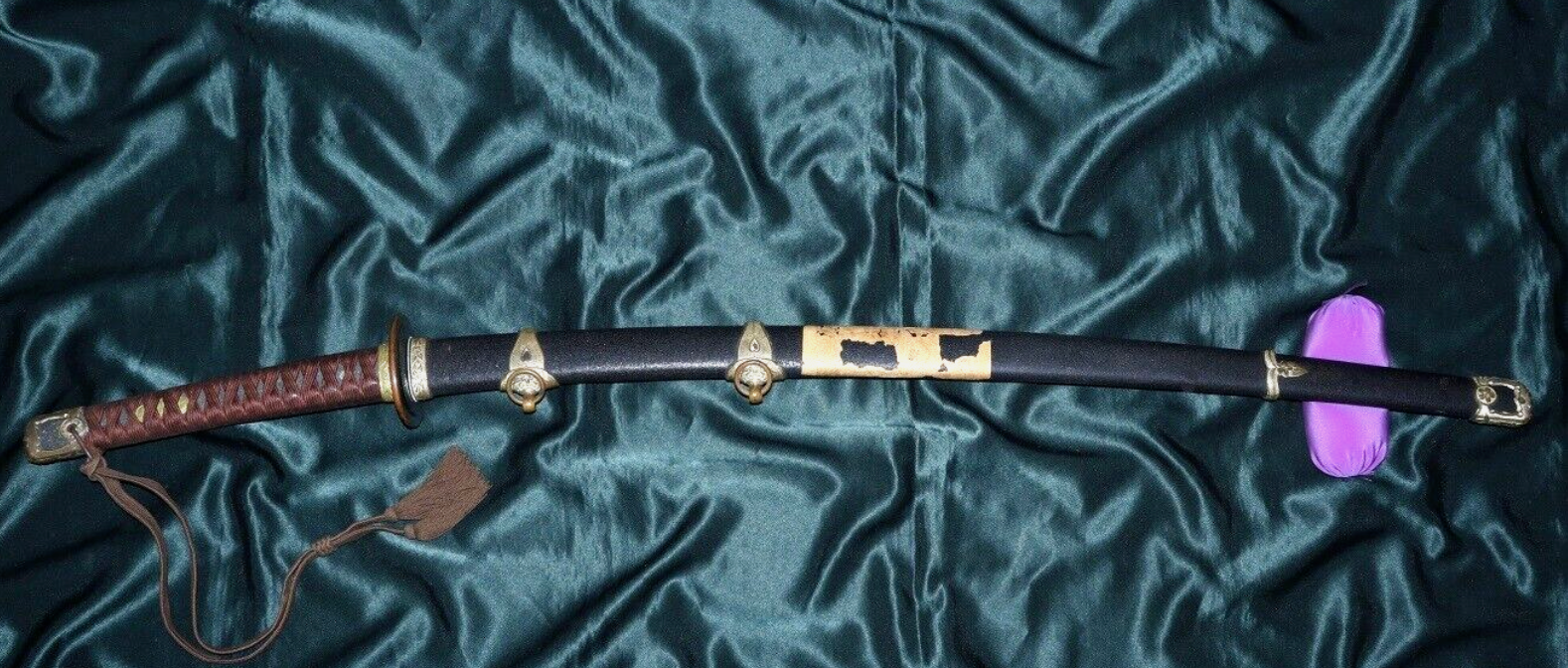

Swords Posted September 27, 2025 Report Posted September 27, 2025 👀 my for help with this sword Thanks all Quote
ROKUJURO Posted September 27, 2025 Report Posted September 27, 2025 Might well be a good sword but on these photos there is no detail that I could see. Quote
Geraint Posted September 27, 2025 Report Posted September 27, 2025 Dear Steven. What makes you think it is Koto? All the best. Quote
Swords Posted September 27, 2025 Author Report Posted September 27, 2025 I will try and get better pictures I’m going by Koto because it’s in description and by the looks of the age look of the tang although I could be wrong Quote

David Flynn Posted September 28, 2025 Report Posted September 28, 2025 Steve, may I suggest you acquire the book, Craft of the Japanese sword. What you appear to be lacking is, the ability to "Look into a Sword". Learn what features are desirable in each tradition. On the sword above, looks Shinto to me and of not very high quality. 2 Quote

Swords Posted September 28, 2025 Author Report Posted September 28, 2025 Here’s the sellers description This is a extraordinary and hard to find ww2 Japanese sword this belongs to a high ranking officer that was allowed to carry he’s old descendent blade into the war using the custom order navy Kay gunto mount thia blade has a magnificent well preserved polish ease to enjoy all the details of the smith work this sword has not been presented for evaluation before directly from the official family to you hand this sword is very very healthy no fatal kizu of any kind very light wait and very sharp a great package for any collector hard to let this one go very recommend???! Quote
Shugyosha Posted September 28, 2025 Report Posted September 28, 2025 Hi Steven, It's traditionally made and I'd agree with David that it's a shinto blade: the condition of the tang points that way and, for me, the overall shape looks like that which was in vogue around Kanbun so 1660s would be my guess. Unsigned shinto blades aren't very desireable for non-military sword collectors, but an antique blade in kai gunto mounts might have some appeal to you military sword guys - sorry, can't say anything about the fittings as they aren't my thing. Quote

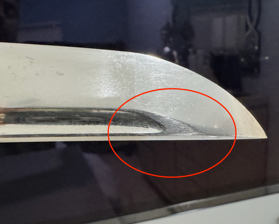

John C Posted September 28, 2025 Report Posted September 28, 2025 19 hours ago, Swords said: help with this sword Steve: In my opinion, 3.5k for this sword is too much (unless the blade could paper as something special, which I don't believe it could). The area around the boshi looks like it has seen a grinder (see pic). The description is hopeful at best. "High ranking" officer? What gives that impression? Koto blade? Again, how is he coming to that conclusion? Never mind the poor grammar and low feedback. A separate question would be to figure out what your collecting goals are. Genuine WWII item with a WWII made blade or an older samurai-era blade that has just happened to be repurposed in WWII koshirae. John C. 2 Quote
Swords Posted September 28, 2025 Author Report Posted September 28, 2025 John I agree Good catch on the grinder How and why was that done? I agree on it not being signed As pointed out by another Not defined No hamon Probably disappeared over time It needs a polish Not worth putting another 3000 into it Time to hit the books I’ve been slacking off I have been looking for a nice Kai Gunto just can’t seem to find the right one Most are stainless and traditional are hard to find Good advice Steve Quote
